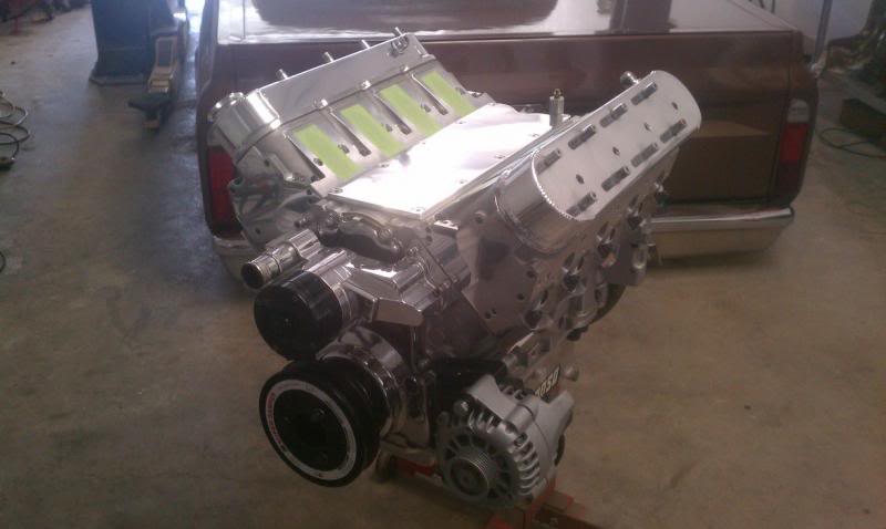

And here the engine almost ready to drop in, I just need to work on the coolant crossover lines and fittings...BUT I already want to see it drop in so who knows what will happen...

What c/r is the motor?
Old Mar 20, 2014 | 01:42 AM
  #47
JJ_TURBO's Avatar
11 Second Truck Club
Joined: Sep 2004
Posts: 532
From: South Texas
This is what I come up with 11.9 (not sure)
The pistons are Wiseco K464X3903 with -3cc
LS9 Head Gaskets
64cc head
4" Stroke
