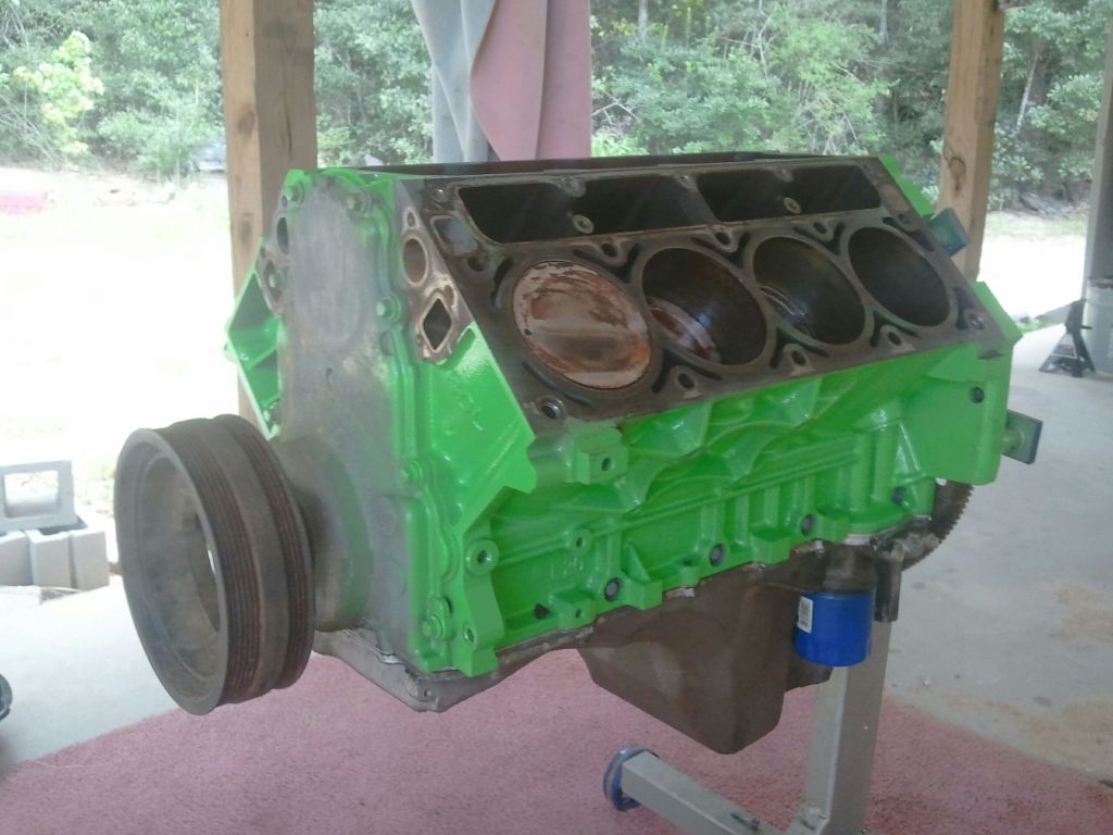

Decided on a color for the block and valve covers... Its a hunting truck so lets camo this **** up Name:  2012-07-21_153638.jpg

well its green for sure lol... valve covers are the same color

Old Jul 22, 2012 | 01:55 PM
  #33
03sierraslt's Avatar
Posts: 19,007
Likes: 221
From: Western PA
You need more colors, camo is more then green...
Curious to see how this looks. Good deal on the 80E.

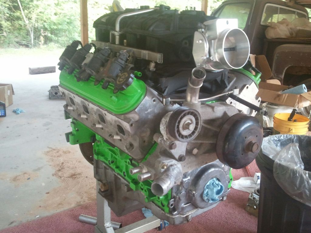

well it kinda looks like a motor.... got the 799's in today and got the springs on
and randomly put all the parts on the motor to see what shes gonna look like

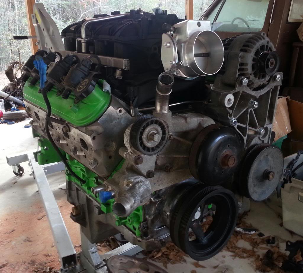

few thinks changed in the "plan".... cam has become a 222/226 .5xx/.5xx 111+2 and the motor and transmission are about ready to be put together as soon as i find a good price on a converter.

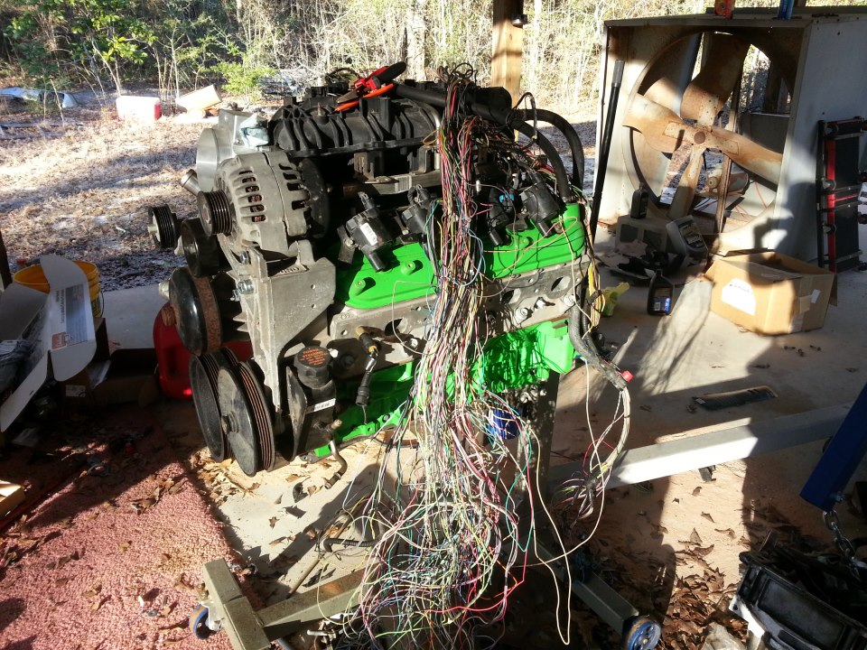

started alittle wiring today

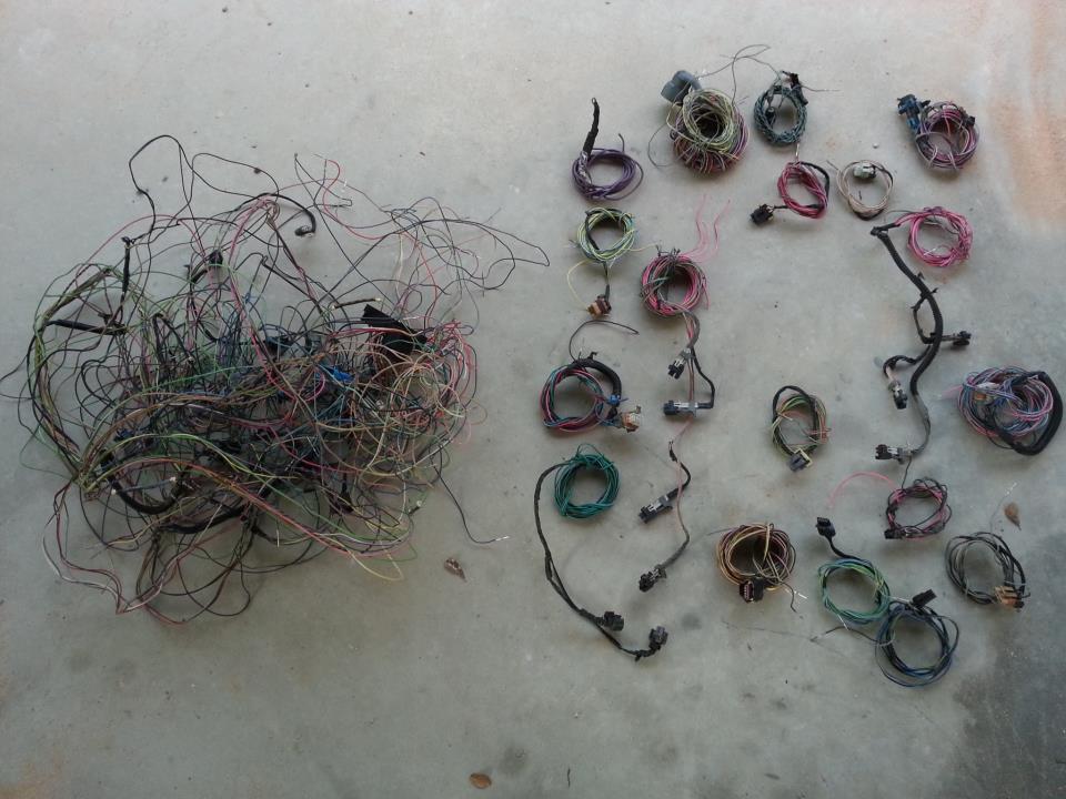

ended up with this... it really wasnt that bad

Old Jan 23, 2013 | 12:04 AM
  #38
AKlowriderZ71's Avatar
11 Second Hall Moniter
Joined: May 2008
Posts: 11,651
Likes: 10
From: Wyoming
Are those new head bolts, or did you re-use the old ones? Hopefully they are new.
Old Jan 23, 2013 | 08:07 AM
  #39
silver-mod-o's Avatar
Hunt&Fisherator
iTrader: (15)
Joined: Nov 2005
Posts: 14,314
Likes: 17
From: SETx
I was just thinking the same thing LOL
Old Jan 23, 2013 | 05:03 PM
  #40
1nasty86's Avatar
Turd Gen Guy
iTrader: (63)
Joined: Dec 2008
Posts: 1,525
From: opp, alabama
If you look close you can see the marker markings I made when I torqued the head bolts down lol and of course there new....
