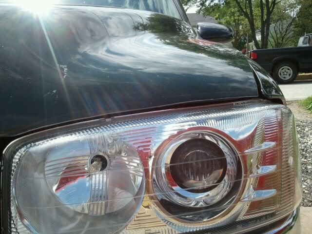

Ok got the hood pretty damn lined up on the truck.. few issues with the corners, that I will address, but none the less the lines are actually better lined then on my factory hood was.. Tweaked the hinges a tad, to get it to set right.. About as good as I can get it.. So far have made 2 cuts, to get the brow looking good.. Finishing up that side now, then to fill and make the lip. So far so good
The corners are a lil diff then my sierra hood, I will round these to match the fenders
First cut
2nd cut

Looks like you have big **** in the first pic!!!
do they not make a sierra hd hood?

Is Wayne Brady gona have to choke a bitch?? And no, no HD hood for the sierras

looking good man, what are you using to cut it?
