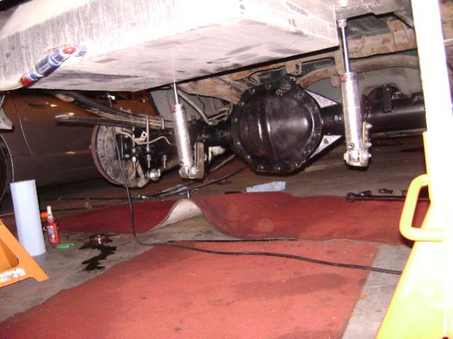

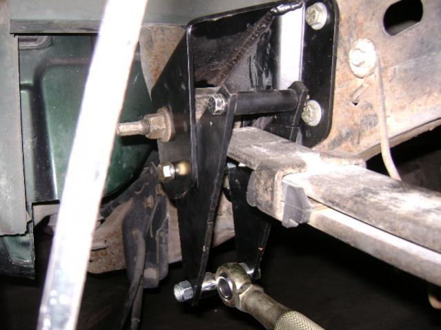

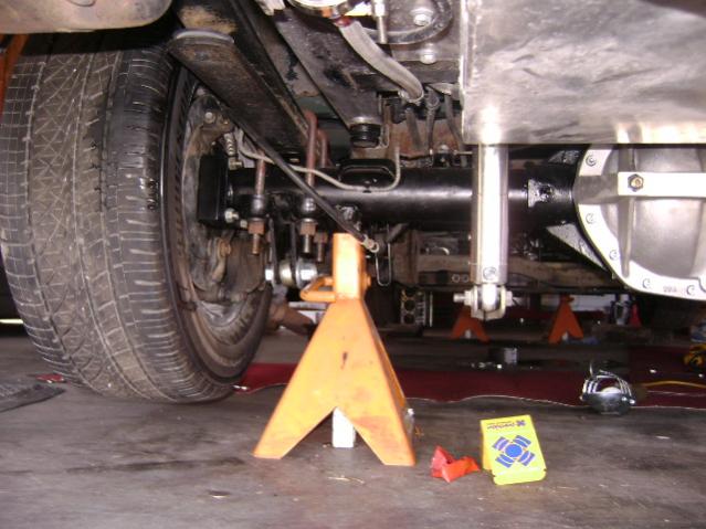

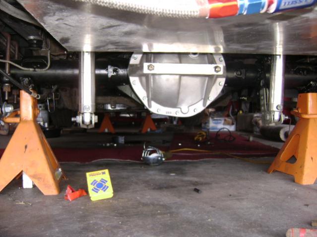

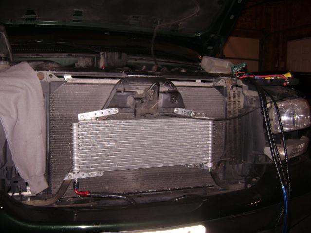

4L80E with Yank sc3000, efans,maf delete, + trucool and 14 bolt with 3.42s and grenade80(temp) installed finally. I also made my own caltrac style bars that work better with a McGaughys 2/4 drop (imo)
Attached Thumbnails Green Bean aka Haba verde-dsc02490.jpg   Green Bean aka Haba verde-dsc02500.jpg   Green Bean aka Haba verde-dsc02503.jpg   Green Bean aka Haba verde-dsc02506.jpg   Green Bean aka Haba verde-dsc02507.jpg

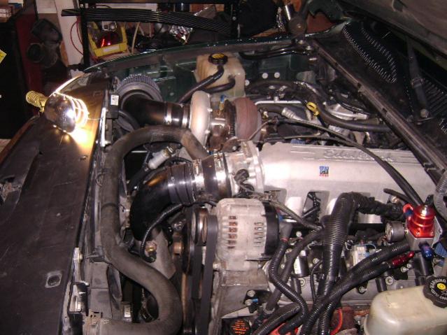

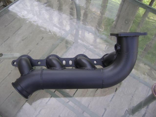

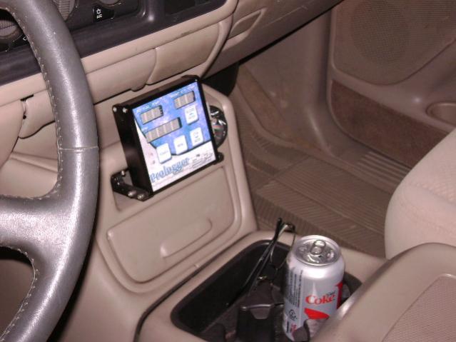

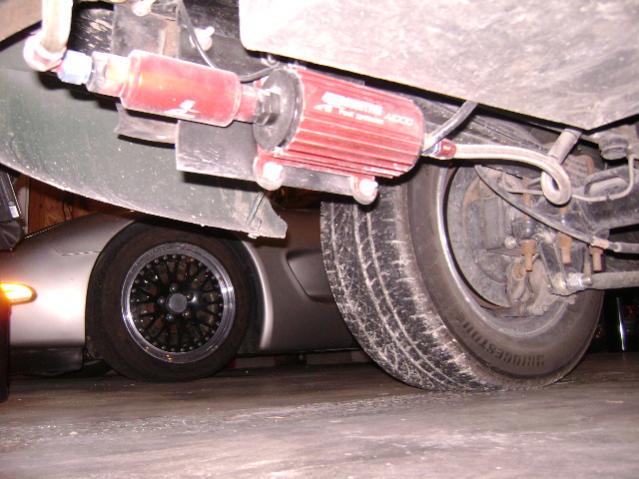

04 5.3 with LS9 gaskets, 234/228 old SLP cam, nitroplated KBRacing hotpipes with PT88, 4" downpipe to 4" Magnaflow race can and turndown, Nitro Dave 75/100 dry shot. Same intercooler as Foose04. Power buckets from an 09 Tahoe along with Aeroforce gauge and Prologger wideband/boost controller. Now having trans problems and gotta pull it out again.
Attached Thumbnails Green Bean aka Haba verde-dsc02515.jpg   Green Bean aka Haba verde-dsc02511.jpg   Green Bean aka Haba verde-dsc02517.jpg   Green Bean aka Haba verde-dsc02518.jpg   Green Bean aka Haba verde-dsc02524.jpg

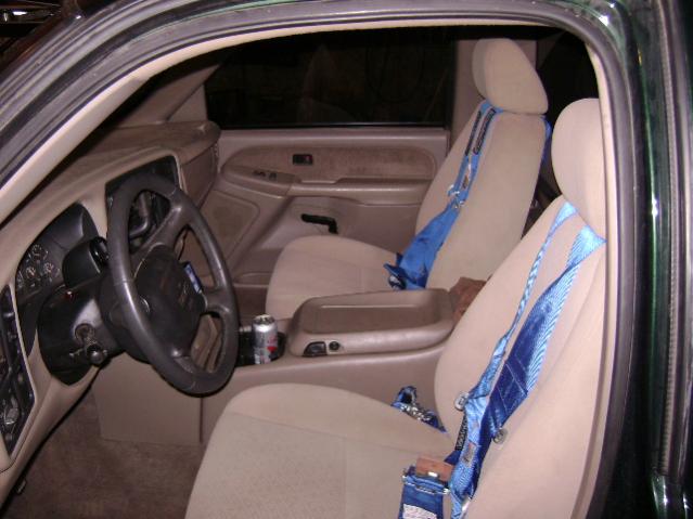

Painted the rollcage before leaving for a worktrip. Everything looks good except against the lexan I'm just gonna try paint brushing that later. Got the new to me wheels on as well. Now need to go to the carwash hopefully we don' t have any tornado's with this weather system moving though.

This cage is so much more comfortable in cruising than the one in my Vette, and long road trips are actually nice because I can move the seats all the way back and recline.
