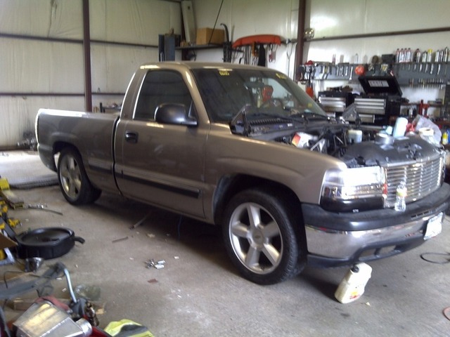

Well im getting closer on my build and wanted to share my work with u guys.. Im getting more excited each time i put a wrench on er....
For starters its a 5.3 shortblock
Heads/Cam done and designed by Frankenstien racing heads
Heads are 853 ported polished 2.02/.160 6angle valve job milled .030
Cams 217/215 585/569 115+4 custom lobes
Harland sharp 1.8 rockers brings it to 619/602 lift
Vic Jr
90mm TB
SD 60# injectors
Lingenfelter timing/2step controller
72mm turbonetics .96ar
A/W intercooled
4" downpipe
Trans
TH-400 bullt with bte Transbrake, deep pan
Converter still undecided
410s in rear for now once its running they will get changed
Now what u been waiting for
[IMG][/IMG]
Not as badass as some other truck out there but it'll be fun!!

lookin good dood! you may want to close all the drowers in your tool box before it tips over lol....

Hers is goldilocks herself
should enlarge if u click on it

Nice!!! When did you get those wheels?

lmao right i was in a hurry lol they got shut once tools were put back up lol.
i got the wheels this past week traded my nitrous plate strait up for themm not a bad deal i dont guess..

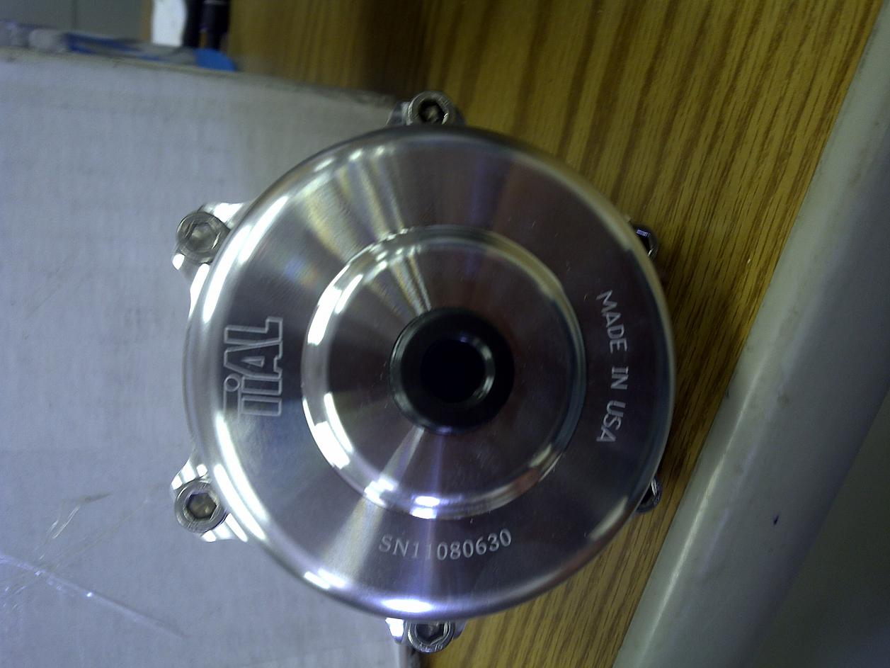

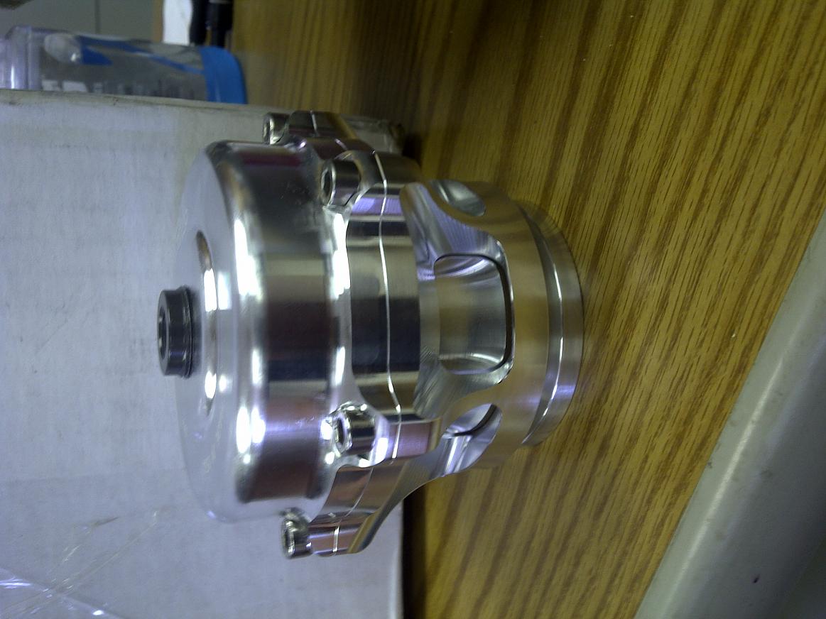

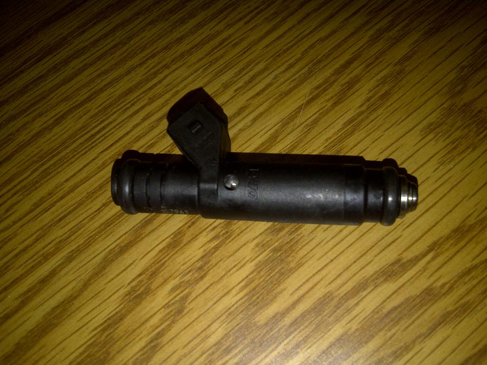

The brown and white trucks brought me some goodies today. I'm also working on my harness to hav it come out of the bottom cab above the trans and flare out behind the motor so its less trashy lookin.
Tail Q 50mm BOV thanks to fellow member Tgriz
