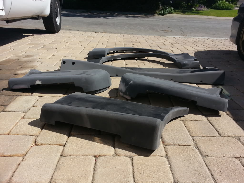

I put it all back together for a while and was driving it every now and then, but the paint on it always bothered me. It wasn't terrible but the roof was chipping and the hood was faded. I decided I would pull the trigger and spend the $$ and get it done. So I pulled off the cladding and about 10lbs of dirt!
