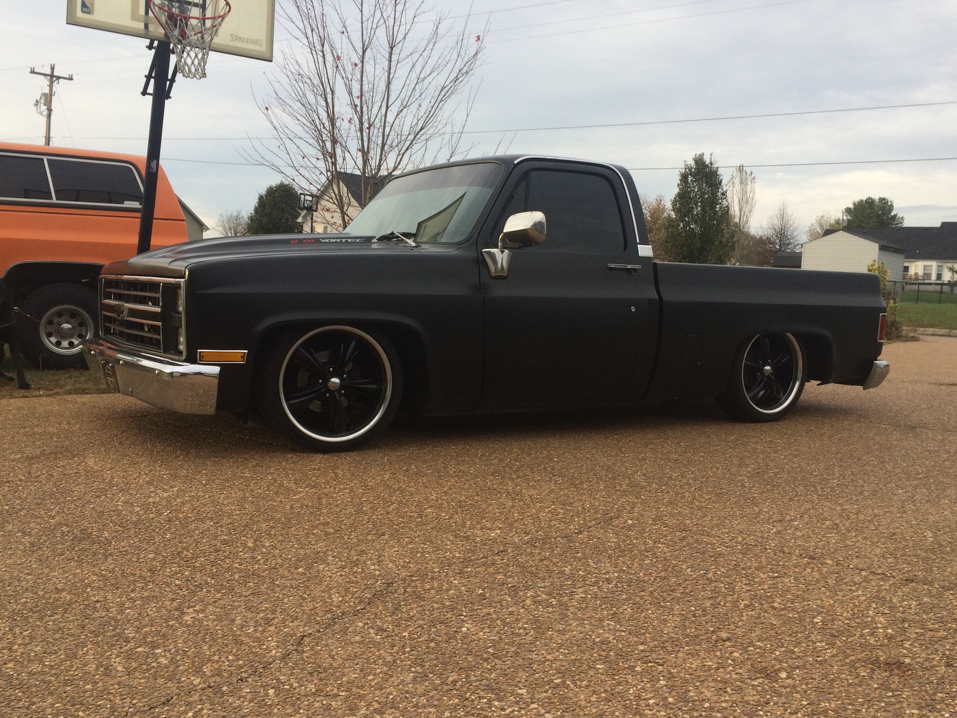

Well since I've had to rebuild my motor I decided to get something to daily drive while my truck is down. 82 C10: lq9 swapped, ls6 cam, efans, built 4l80 and air ride. Runs like a champ and rides amazing.
