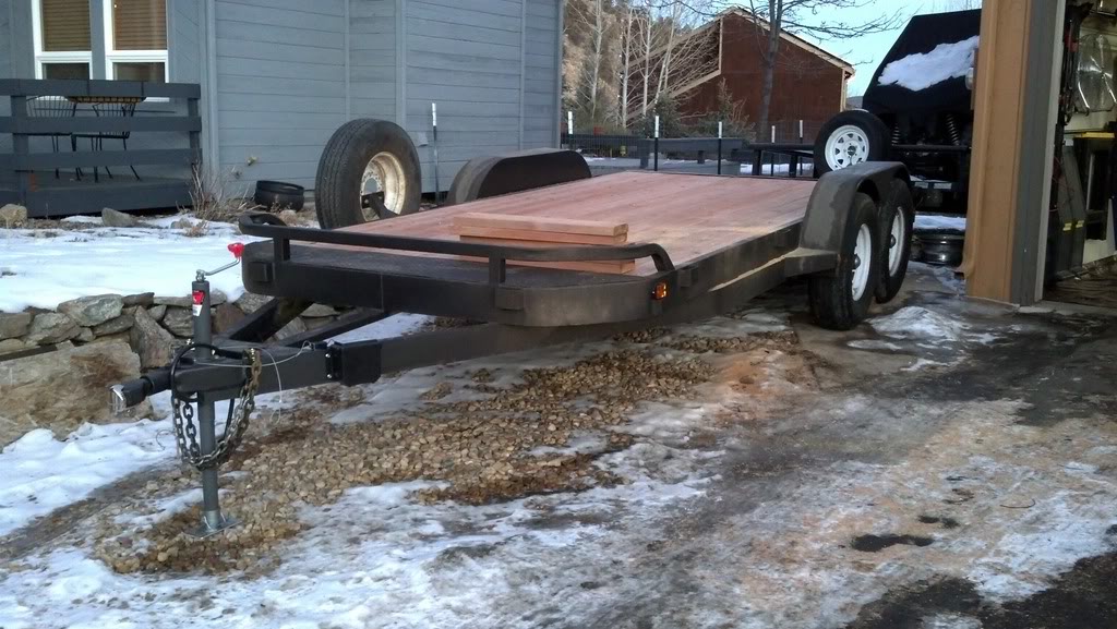

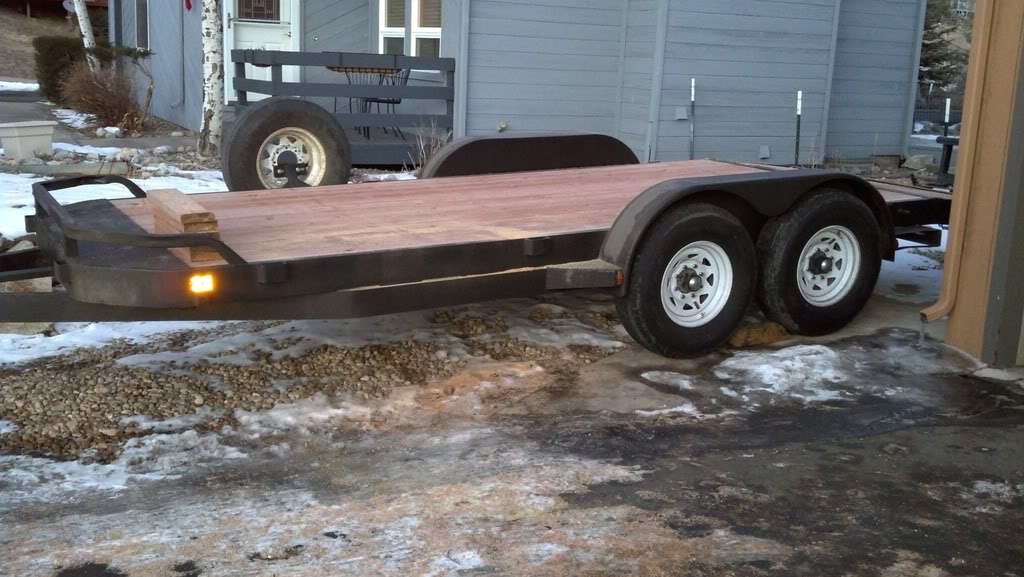

Almost done! New electrical and lighting, paint, deck, new wheels and tires. It's a little dirty from pulling in the snow. Going to try to clean it up this weekend and put the reflective stickers on per DOT requirements. Total investment is just under $2800 including purchase price.

You should have done POR15 or Eastwoods rust encapusalor that stuff actually works better applying it over rust. The only thing you have to do is knock off the loose chunks.
Looking good thou

Looks allot better man, I need to pickup a big trailer to put my tractor on. Not sure how big of one I need, need to measure. Looks like it turned out to be a nice investment.
