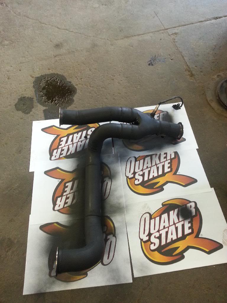

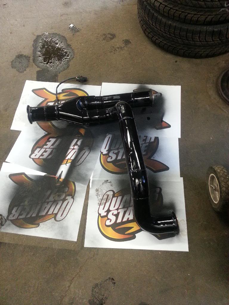

While I had my y-pipe out to do the trans pan, I gave it a good coat of VHT 2000* exhaust paint, it dries matte black.

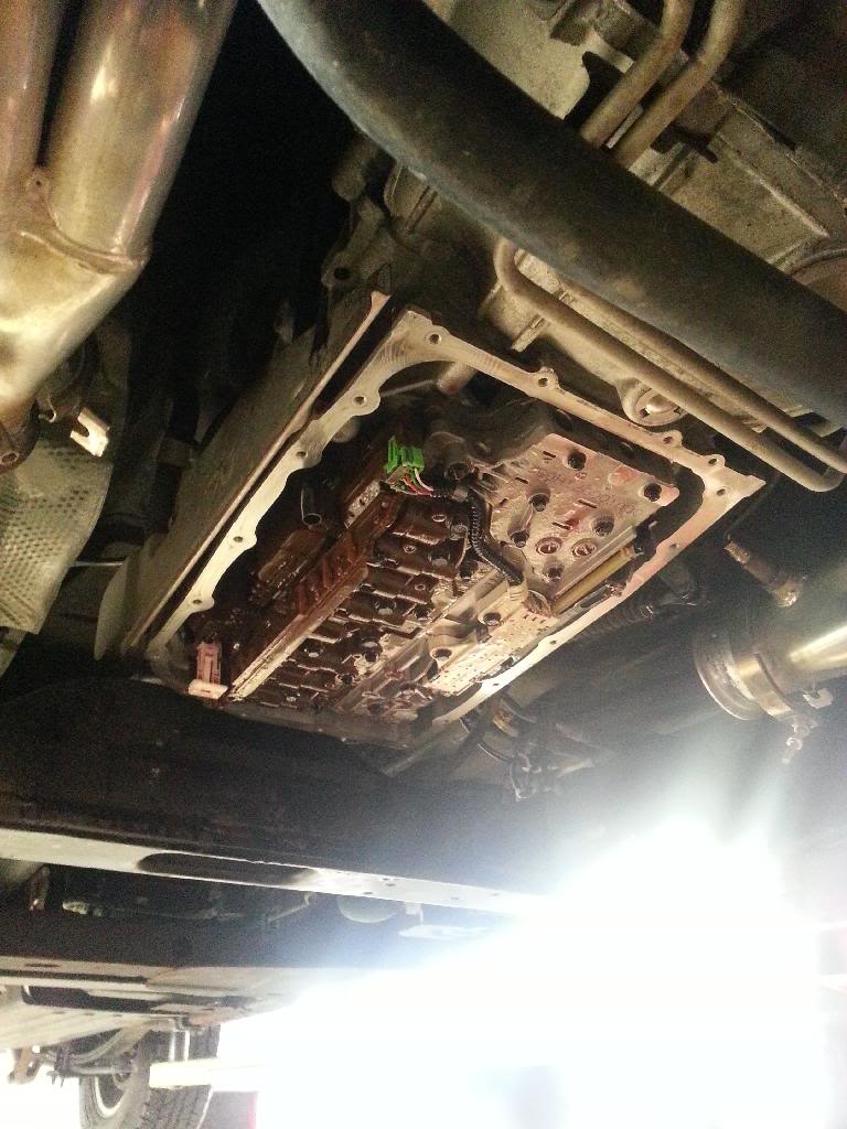

remember when replacing your filter to always replace that "seal" that pops into the valve body, don't use a pick to pull it out. I used a pry bar, and worked the edges folding them over and then a pair of pliers to grip and pull. use an extension and a 22mm to drive the new one in

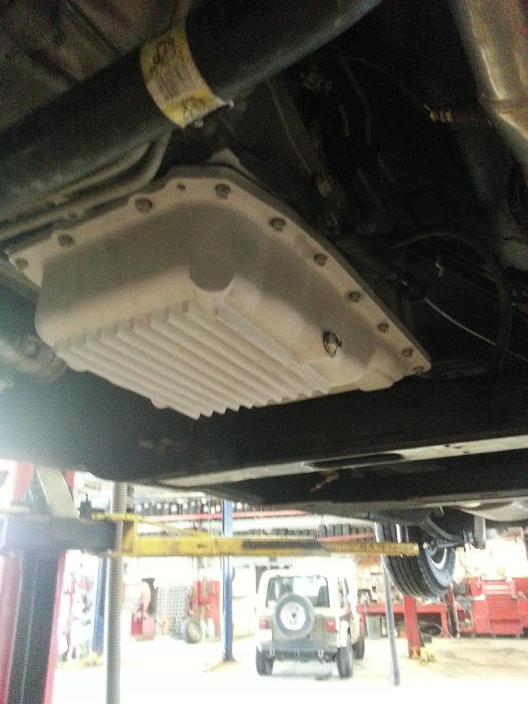

new PML Low Profile pan installed.
the dimensions are almost the same as OE, sits about 3/4" lower in total and holds about .4L more.
took me 6.4L to get back to operating range after the pan and filter swap

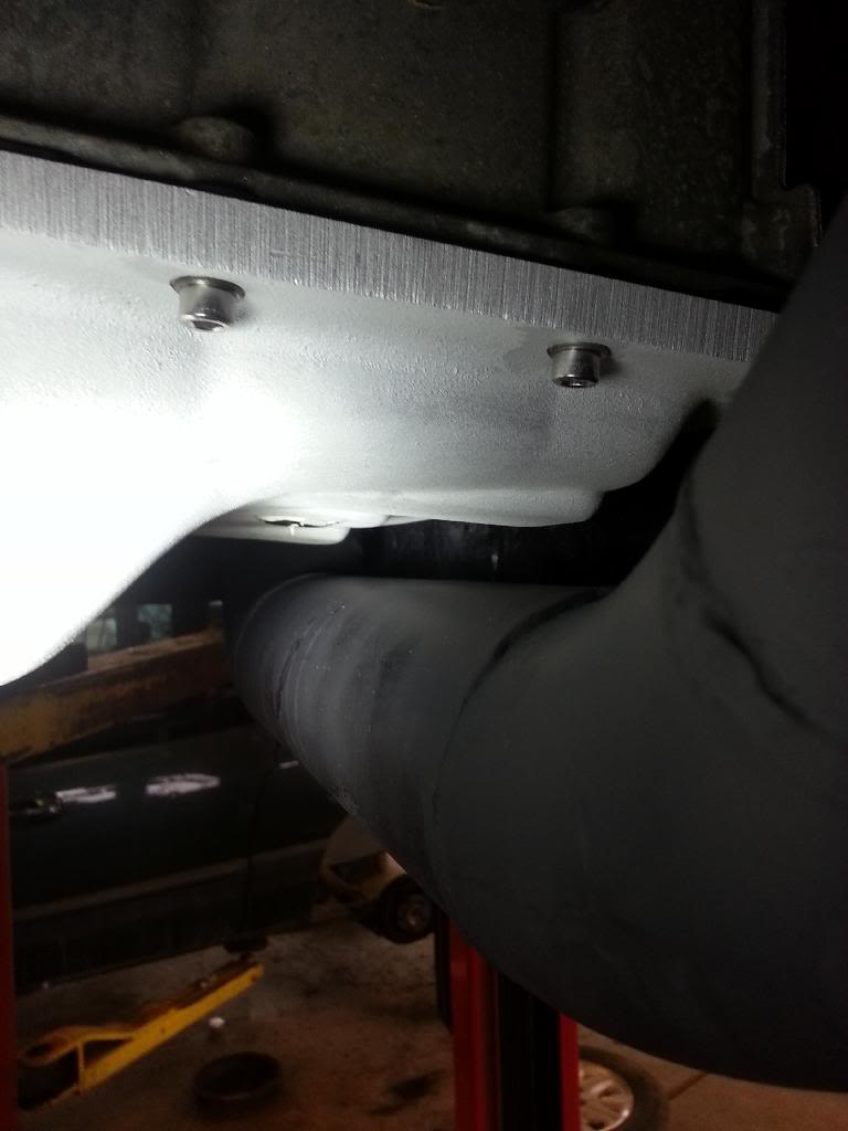

here's the clearance to the y-pipe
