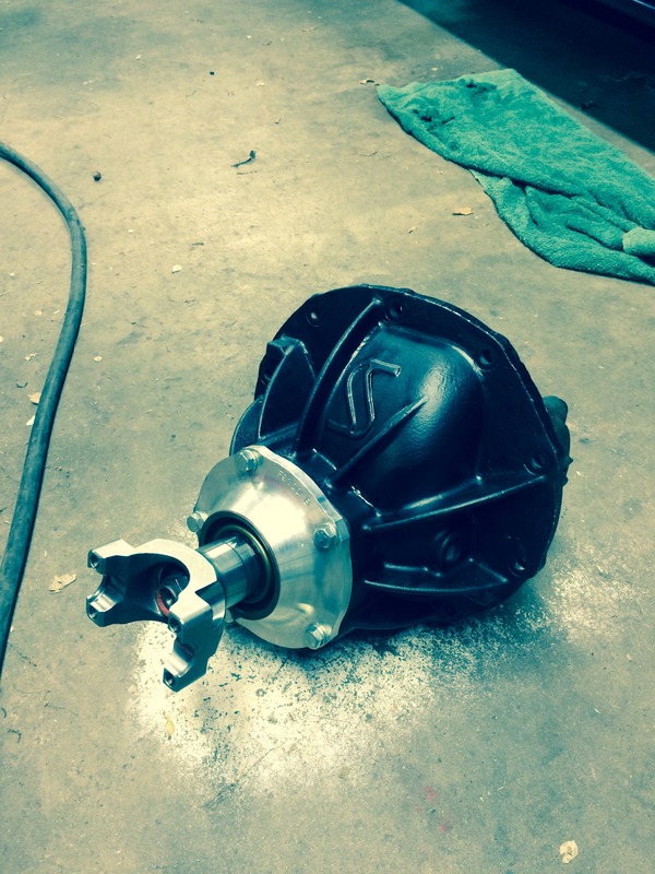

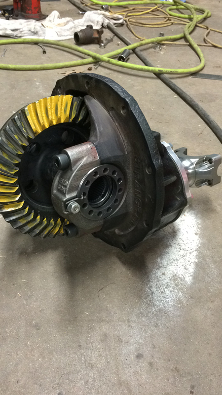

Not a whole lot done today, had to drive to okc to pick my driveshaft.
But got the gear assembled.
Strange case, 35 spline spool, Daytona pinion support, Richmond gears, and Moser 1350 chromoly yoke.. Played with the pattern for an hour and thats about as good as I could get it with a set of used gears..
Thanks to Danny Parker on the badass flat black powder coat!

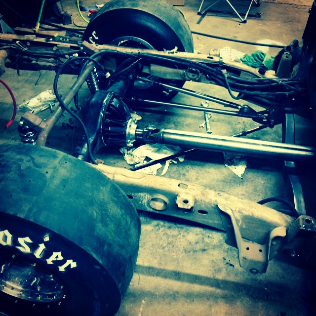

Just about finished. Got the gear, axles and brakes all mounted up, driveshaft bolted in, rechecked to make sure everything is square, and the bed set back on. Just gotta machine some lugnut spacers, spacers for the bottom Coilover brackets, and machine some threaded inserts to build a new diagnal bar. Along with bolting the bed back on, hooking the battery and fuel cell back up. Should have that all done tonight.

Finally got it pretty much done, just bought a few parts to put on the front I'll get done this week.

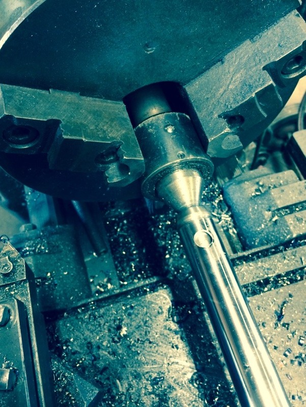

Had to build a new diagnal bar. Centering up in my lathe to tig weld it.

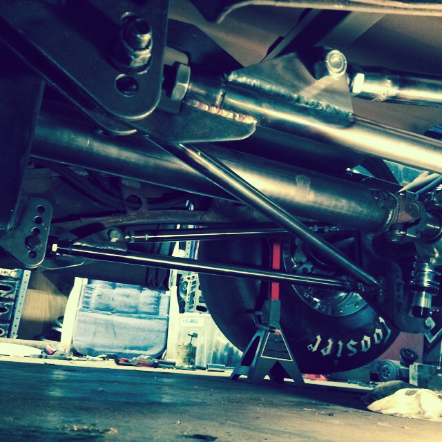

Everything finally in place.
