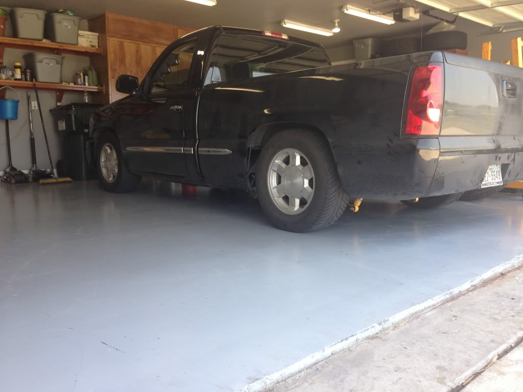

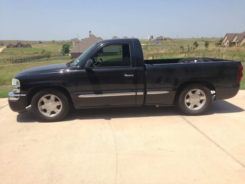

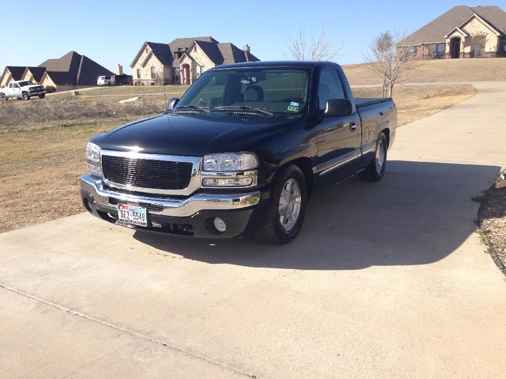

Herw you go. Nothing special. Very plain exactly the way i like it.

I am sure my truck doesnt pucker the butthole like some would on here but it does make it tingle! Then again i drive mine more and log more miles on it than most do. I wanted a fun daily driver and i think i finally have it.

I like it!
