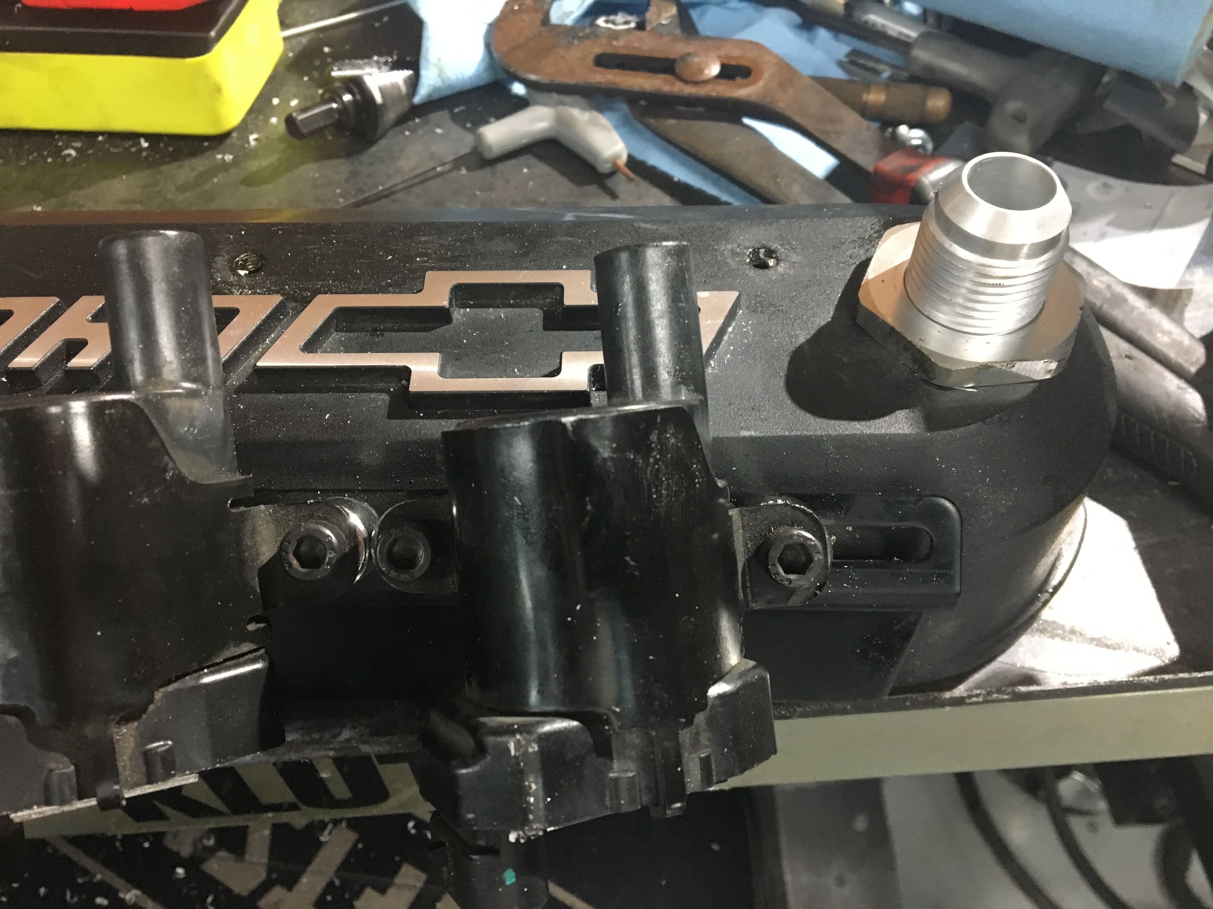

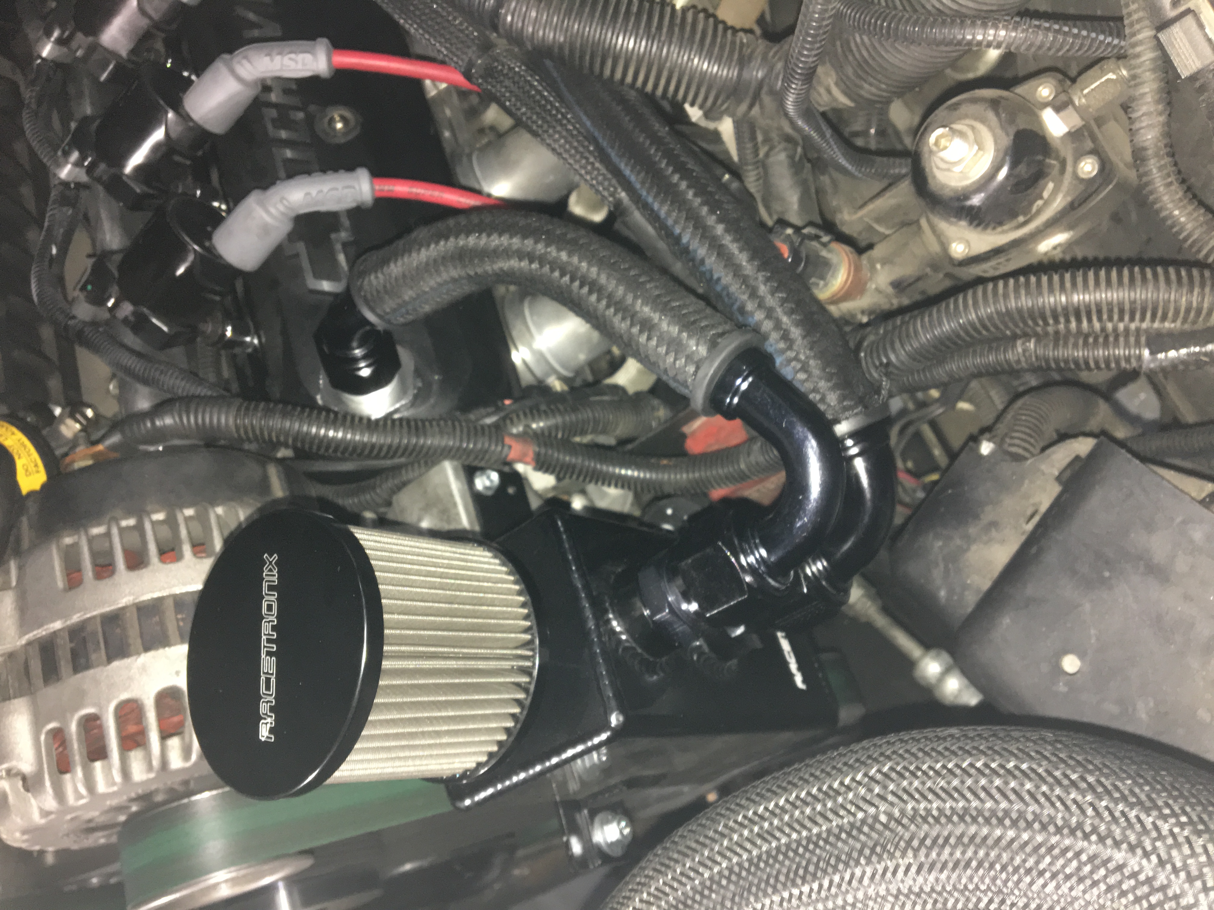

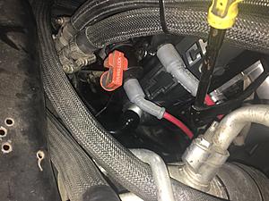

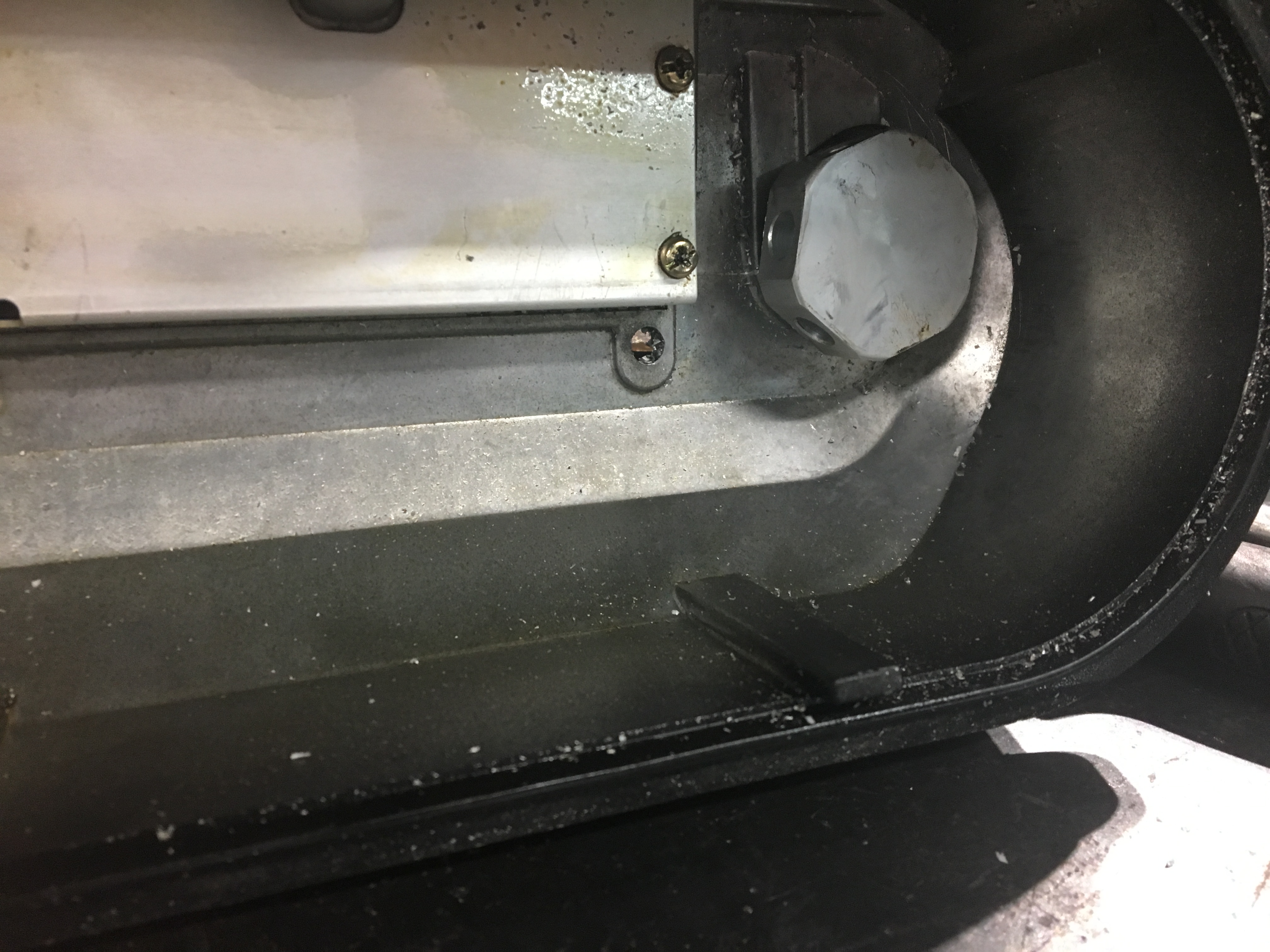

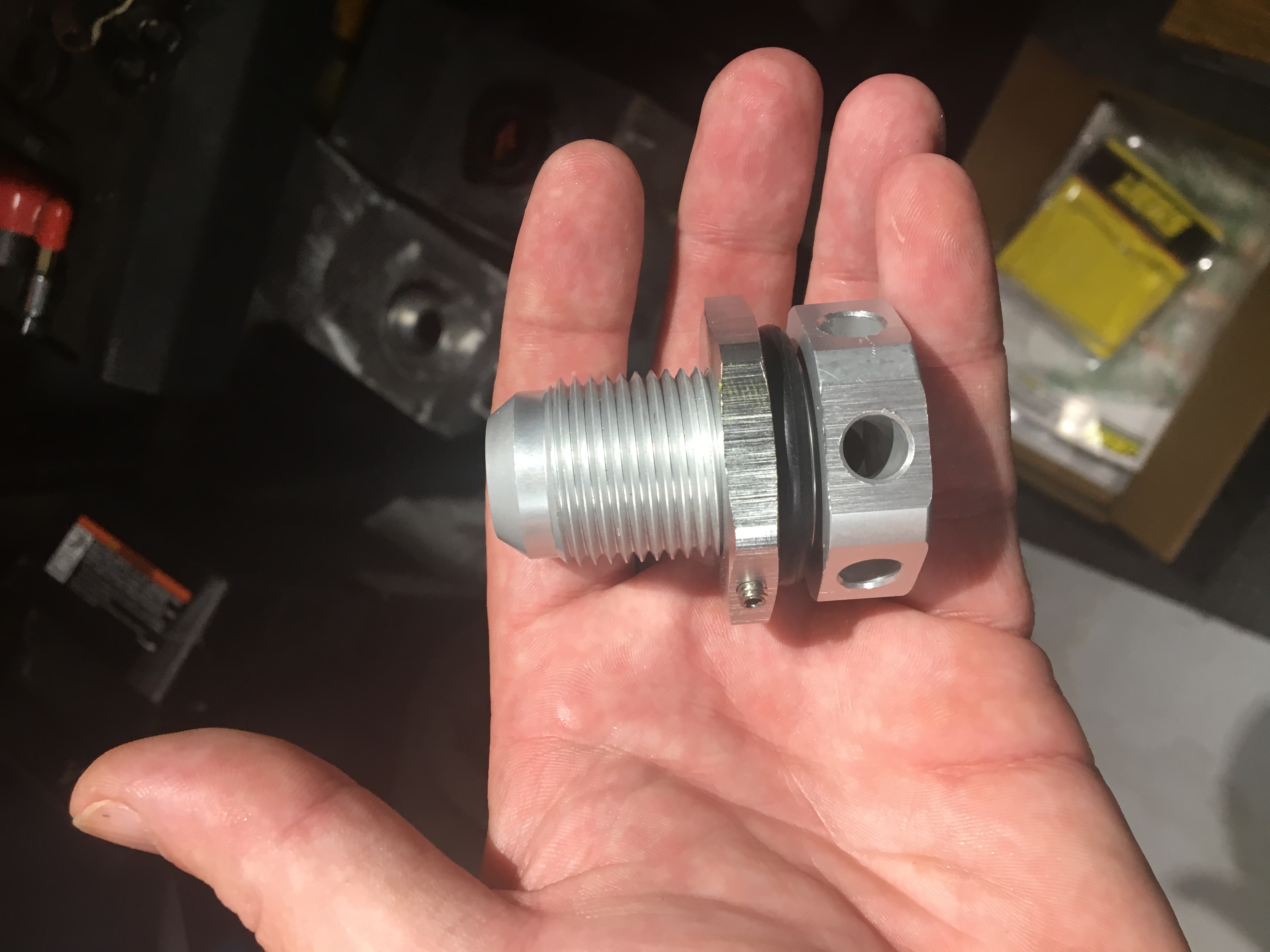

I finally got my catch can setup on. I had 2 tiny filters on the valve covers and i ended up blowing out the gaskets. Soooo i got the -12 baffles pictured below in each valve cover and a big Racetronix catch can.
I works pretty good i emptied today and got some ater out of it.
