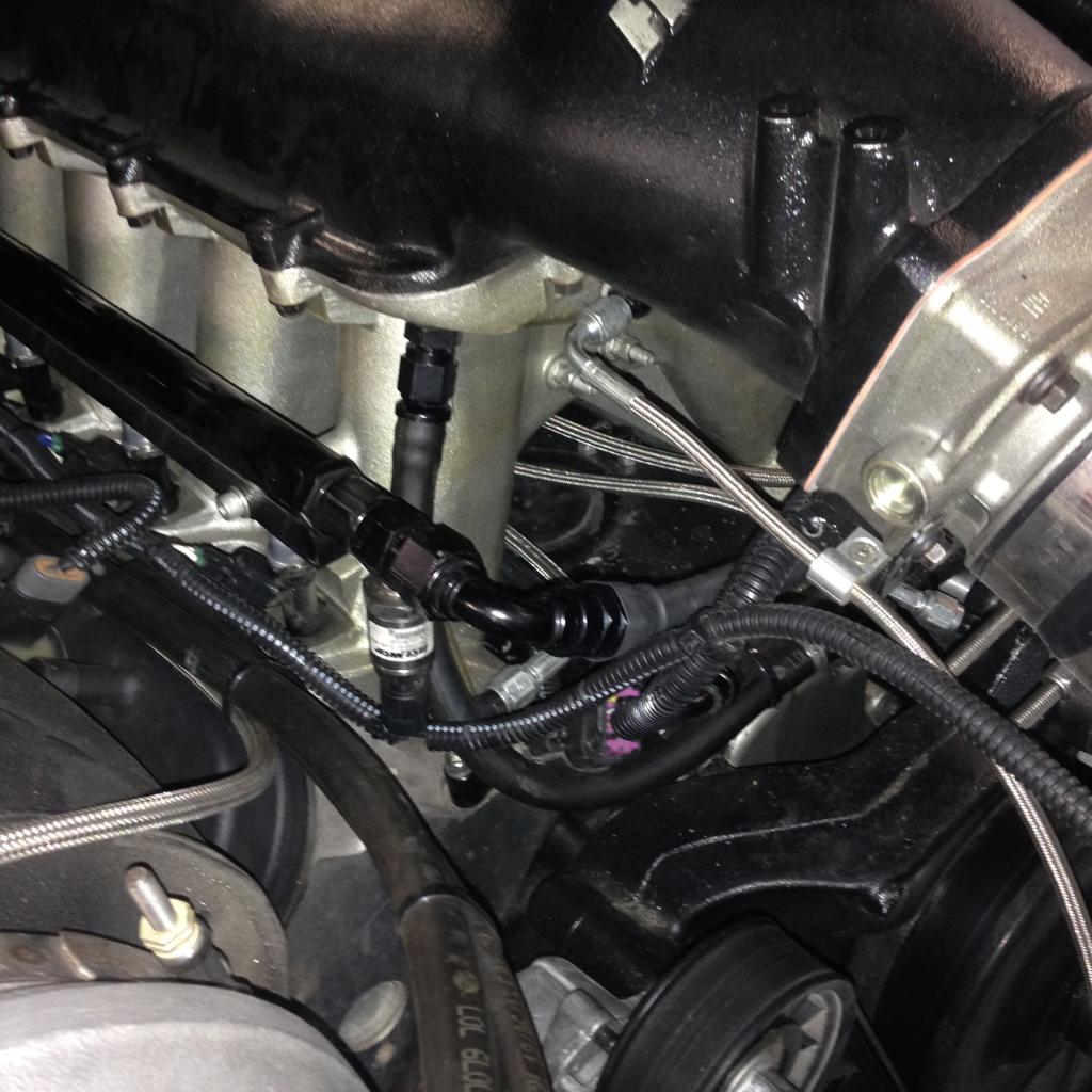

First step in redoing my fuel line. I moved the FPR over to the drivers side fender area.
Also i wrapped the lines in that shiny heat wrap stuff then put on some high temp heat shrink on the lines. I like it better that the shiny braided steel. I will be finishing up next weekend.
I gotta order a fitting to replace that blue one

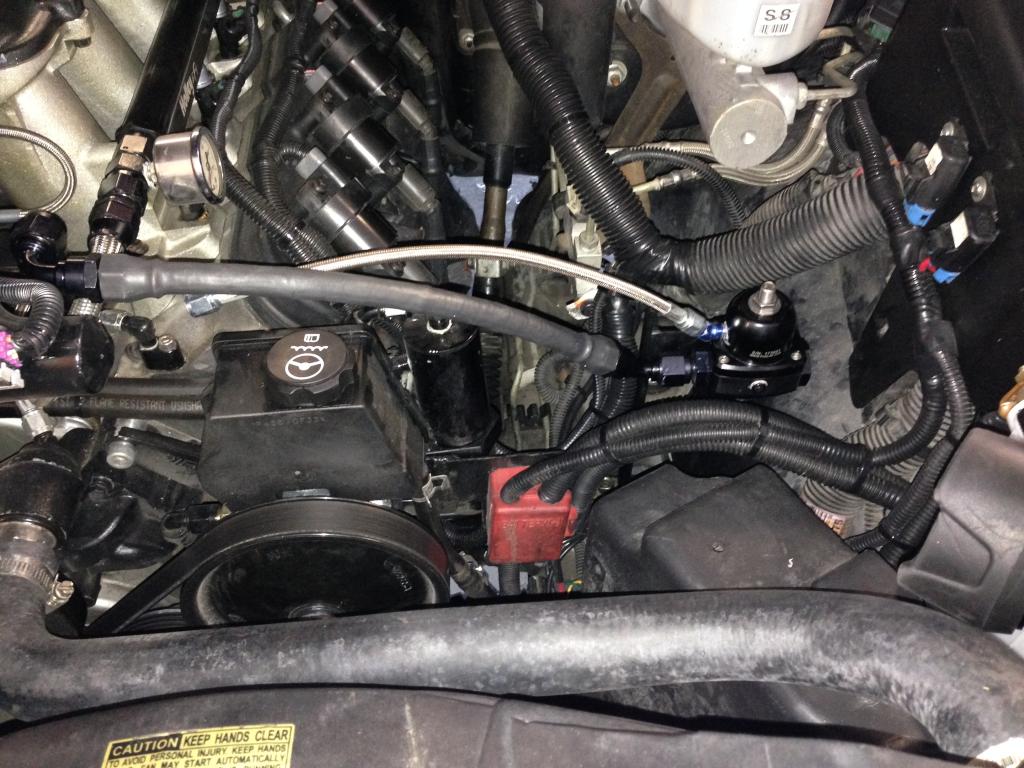

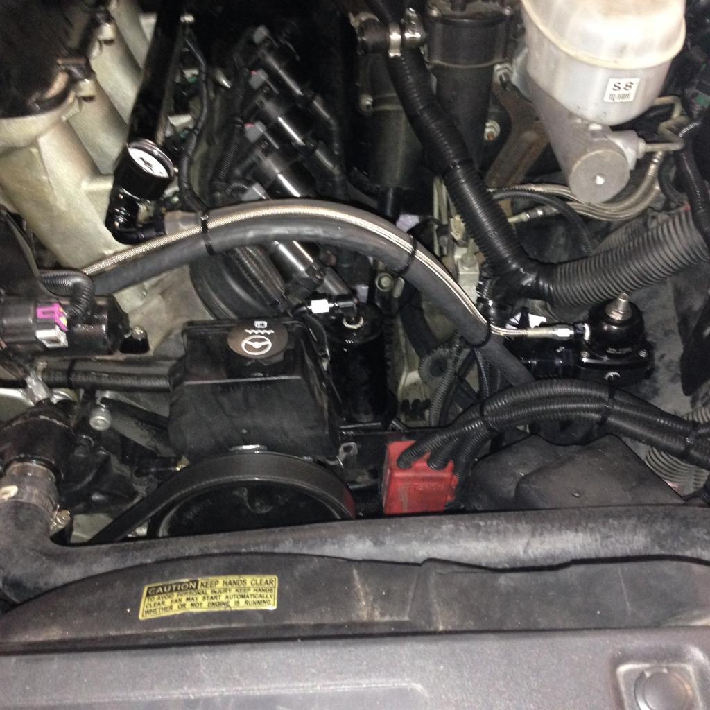

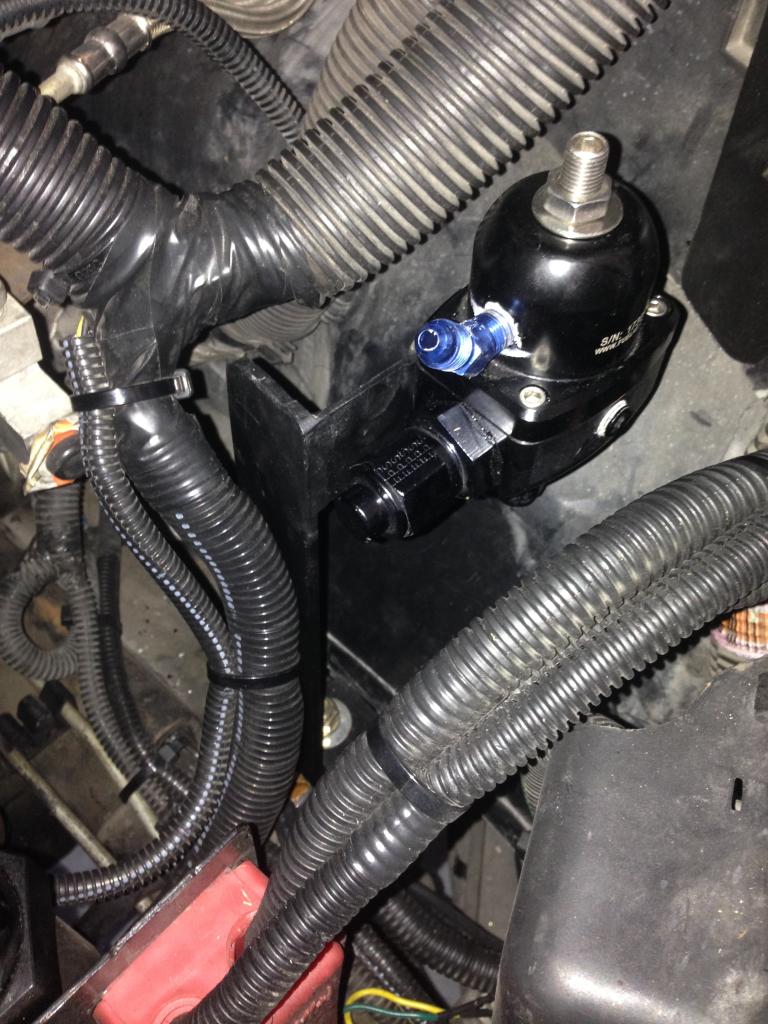

How is the FPR mounted there?
Old Oct 4, 2014 | 03:09 PM
  #888
BlackGMC's Avatar
Resident Retard
iTrader: (31)
Posts: 17,216
Likes: 20
From: Fort Worth - TX
I made a bracket that bolts to the frame. Tucked away down there the FPR is pretty much out of the heat path. Mounting it under the intake the fpr temps were 150*.
Old Oct 4, 2014 | 07:49 PM
  #889
oakley6575's Avatar
Joined: Dec 2010
Posts: 5,235
From: Las Vegas, NV
Oh I see. When I first bought my intake I planned on putting it exactly where you did. Glad you got around to doing it before me. I'll make sure to keep it away from that heat.

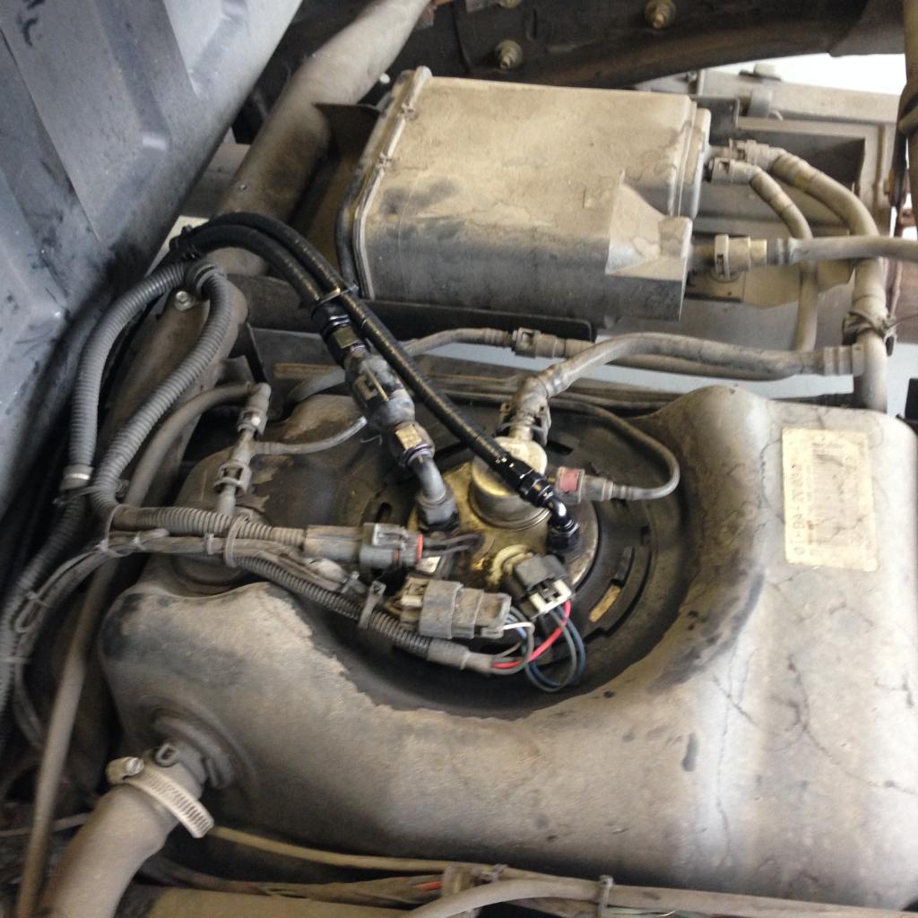

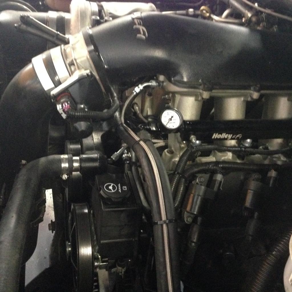

Fuel system V4.0. Hopefulky this is the last time.
