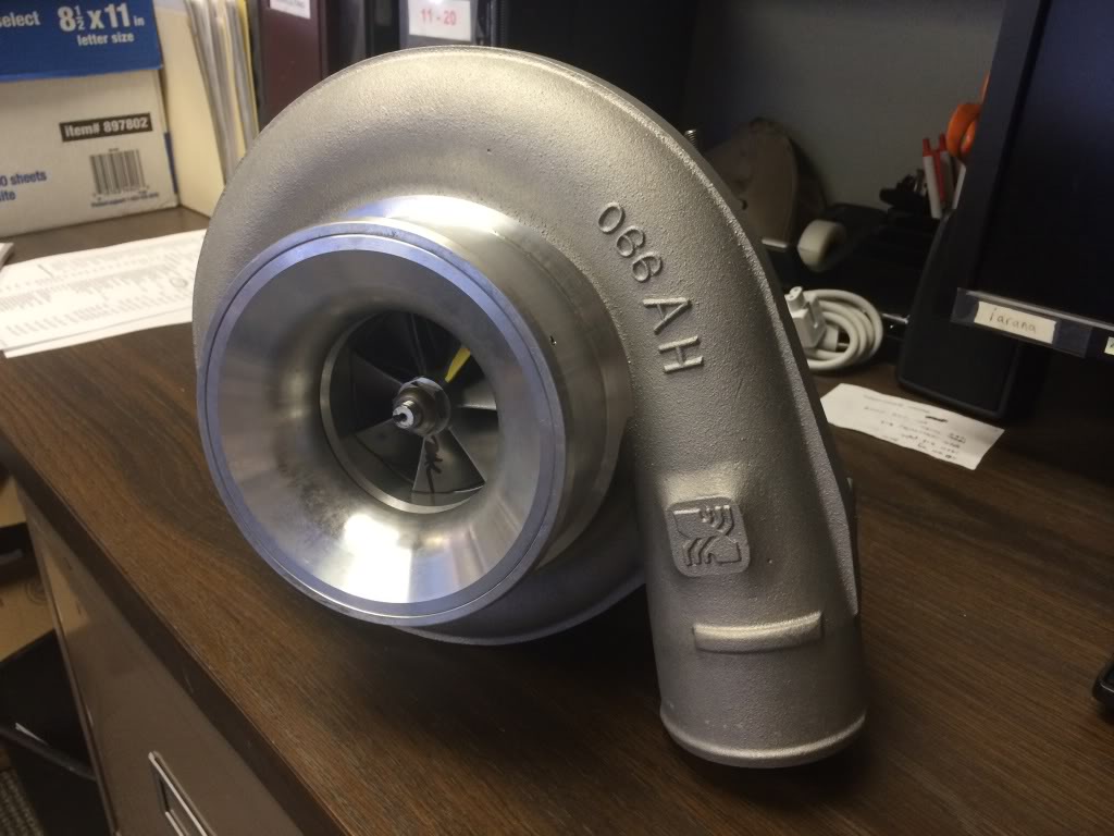

Didn't your S475 come with the inlet bell in the race cover like mine did. I could have sworn it was you who I was talking to about it but maybe it was someone else. It was a while back. Anyway, the below picture is how my turbo came from BW. Jose at forced induction takes out the inlet bell on all of his turbos. All it is is an air silencer and doesn't provide any performance gain having it in place. Jose claims removing it will gain you about 20-40hp.
Anyway, the inlet bell is held in by three hardened roll pins. I used an 1/8" solid carbide drill bit and drilled each pin out slowly. Then you can push the bell out of the inlet bore. Sounds totally different now, in a good way! I don't have a pic of the inlet without the silencer but there is a comparison pic in this thread by Reed @ Work Turbochargers, 3rd post down: WHAT DOES A BW S480 FRONT RACE COVER LOOK LIKE - Yellow Bullet Forums
