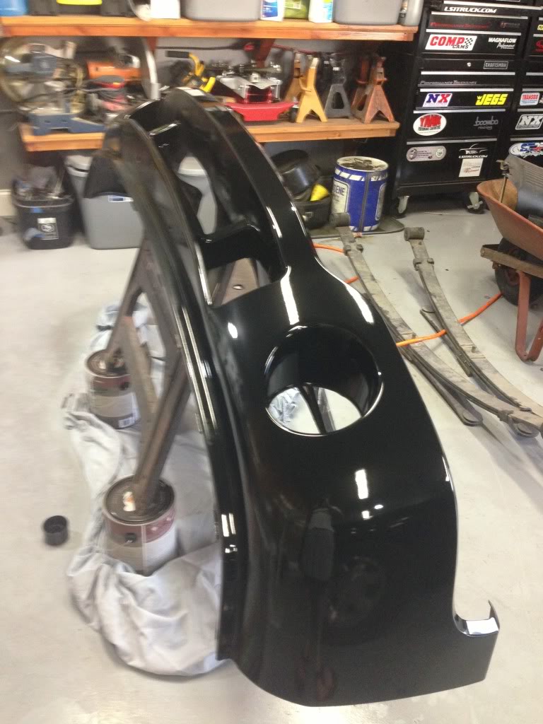

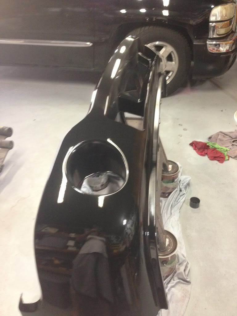

3 coats of base and 3 coats of clear later

Originally Posted by ak2007r6
That's going to look good. You have a spray gun and little booth at the house?
I do have a couple of HVLP spray guns but i did not use them on this. In high school i worked in a Auto body shop for a year or so to learn how to paint and do body work. I don't have a booth, but if you know what your doing a garage paint job can look really good. It is all in the prep and how you shoot.
I bought pre-mixed auto paint. You can order it to be spray in a gun or have it put into a spray can. So it is the same paint just different delivery. That bumper took 2 cans of base and 2 cans of Clear. It came out alot cheaper and easier to do the can than the spray gun. witht he gun you gotta buy reducers and activators, etc... Then there is the clean up.
I was actually shocked how well it came out.
