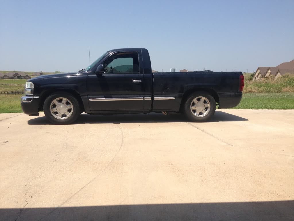

all finished up! 2/4 drop with an axle flip
pics can be found here
https://www.performancetrucks.net/fo...ip-kit-519363/
next up is removal of the drivers side head to replace a broken exhaust bolt . While i am there i am replacing all the gaskets, oil pump and timing chain..

kept the truck so orignal! great work bud!

the stance looks good. lose the bed cover for good?

I'm pretty sure my truck is your twin. I like the 2/4 you made with a flip kit. I may steal your idea. I've got a flip and its too low for the roads around here. Good build bud!

Love that pic
