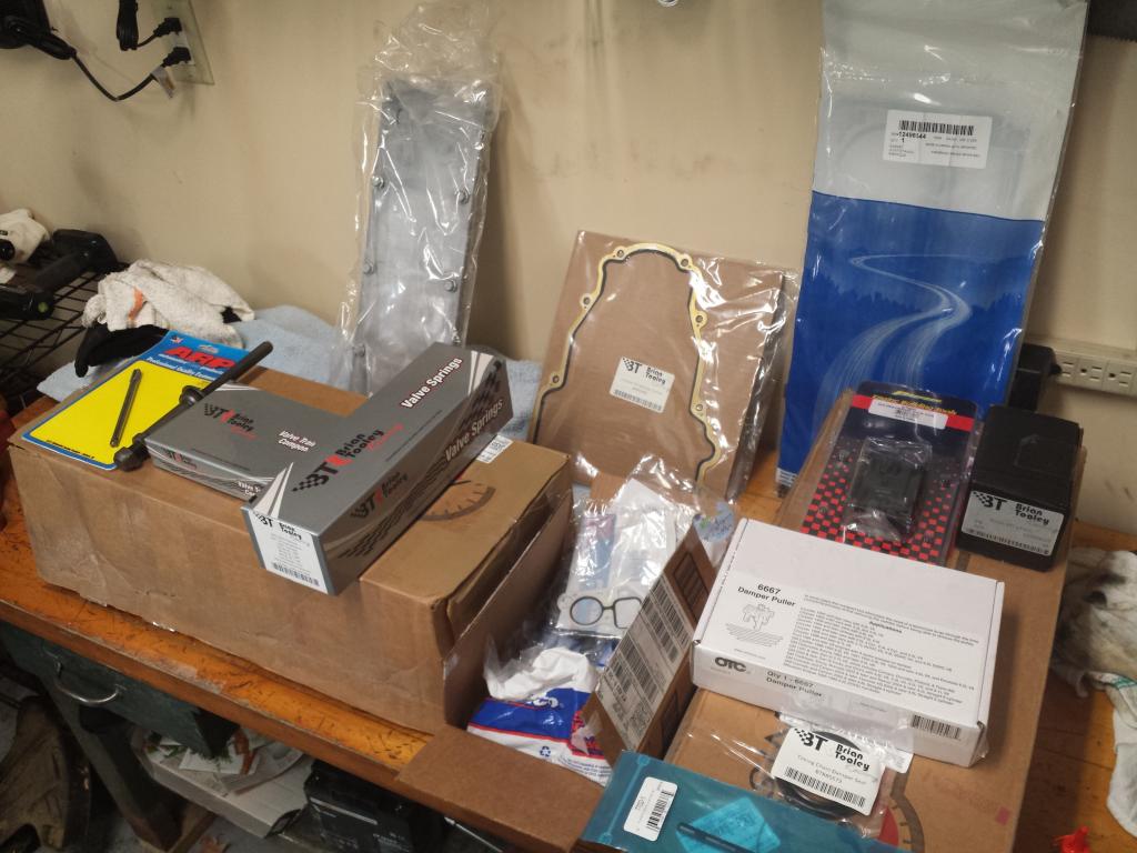

Old Jan 16, 2015 | 04:06 PM
vettelovralexand's Avatar
Joined: Nov 2009
Posts: 355
Likes: 8
From: Columbus, IN
Some of the new parts:

All parts have arrived. I installed a flex fuel pump and control module this past week or so. Now that the fuel system is ready, it is almost time to tear it apart for round 2. I am already soaking lifters and got the steam vents on the new heads blocked tonight.
