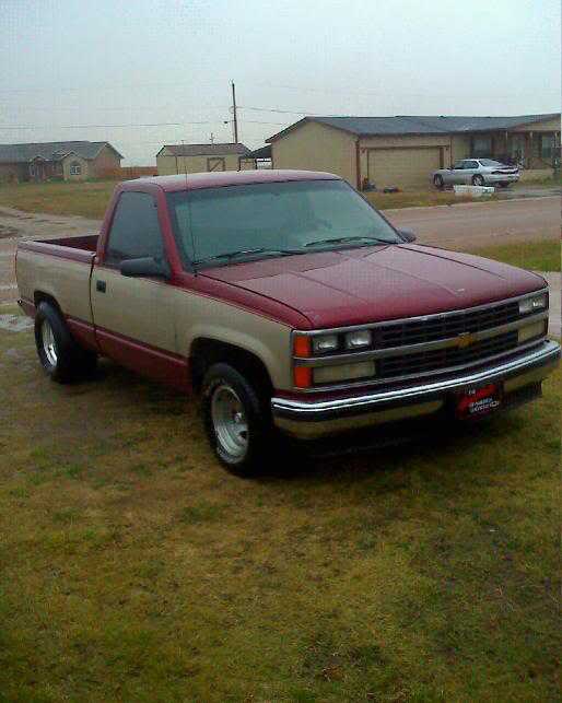

I know I just got done doing the 6.0 build in this truck but after getting a ride in my brothers turbo 4.8 I just couldn't resist!! I sold the engine and trans out of it and now have most of the money to do the 5.3 and turbo build.
Mod list:
-'03 6.0L LQ4
-'99 4L80e with HD-2 shift kit and stock 2200 stall
-10 bolt rear with Detroit TruTrac and 4.10's
-Turbonetics 76mm with .96 A/R turbo
-Home grown forward facing stock mainfold turbo kit
-Bed mounted fuel cell with in-line Bosch 044 pump and 95# injectors
Truck:
Attachment 136593
Attachment 136594

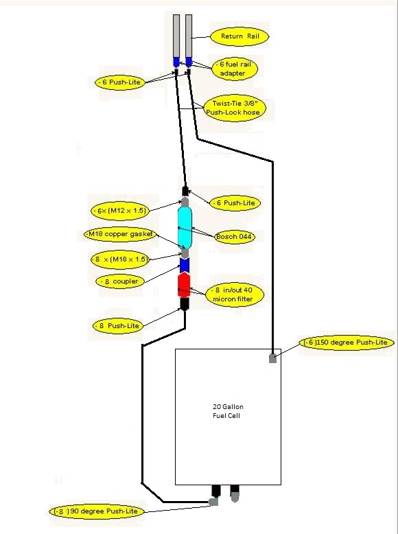

Fuel system plans:
Attachment 136590

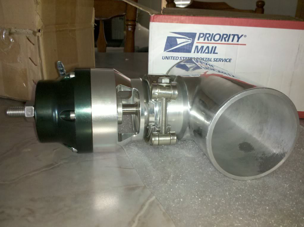

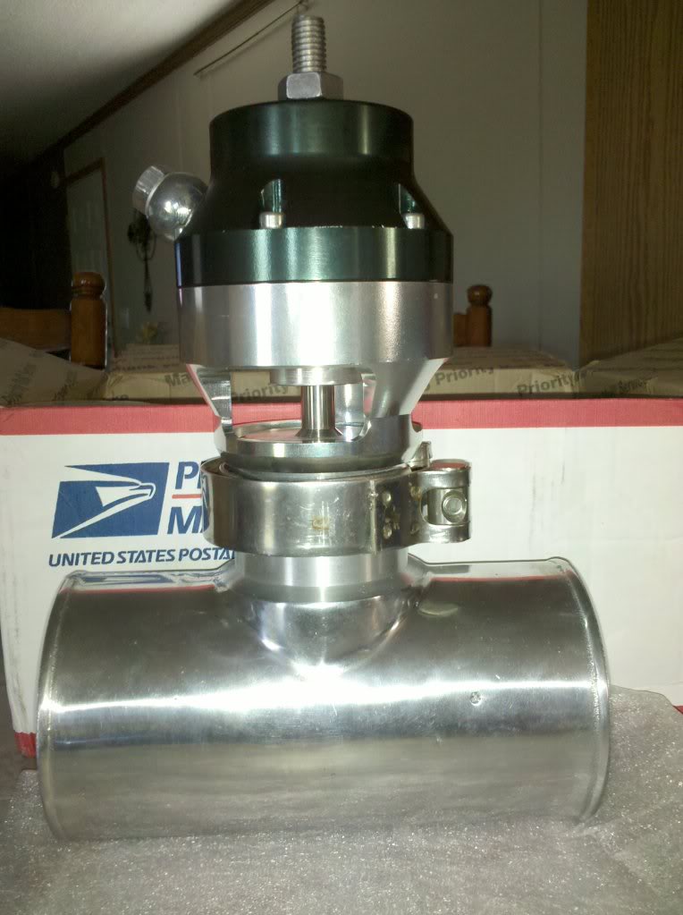

I also got me "eBay" BOV in the mail yesterday, I'm actually impressed for $75, although I did order a black one and this one is really dark green:
Attachment 136585
Attachment 136586

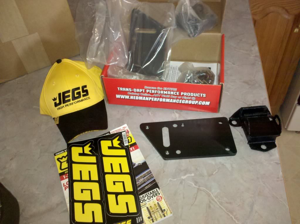

5 Attachment(s)
Moar parts!
Trans-Dapt #4595
Attachment 136437
Attachment 136438

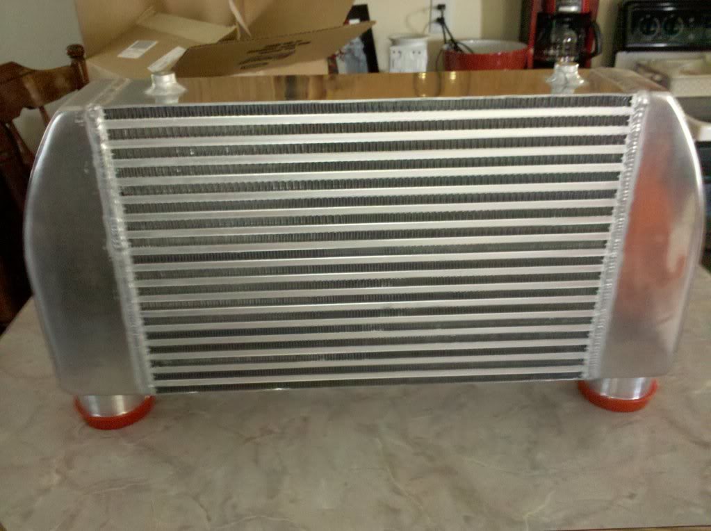

CX racing intercooler part # IC0008:
Core Size: 18"X12"X4"
Overall Size: 25"x16"x4"
3" Inlet & Outlet on the Side
4" Core
Attachment 136439
Attachment 136440
Attachment 136441

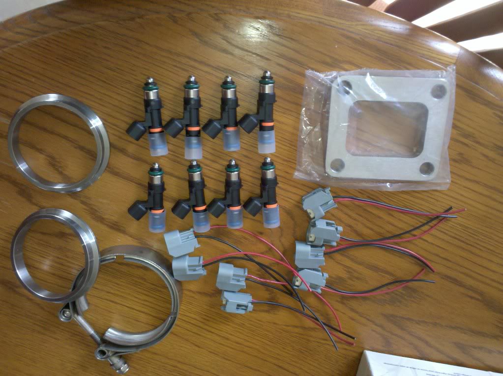

LS1FREEK May 26, 2012 12:49 PM
4 Attachment(s)

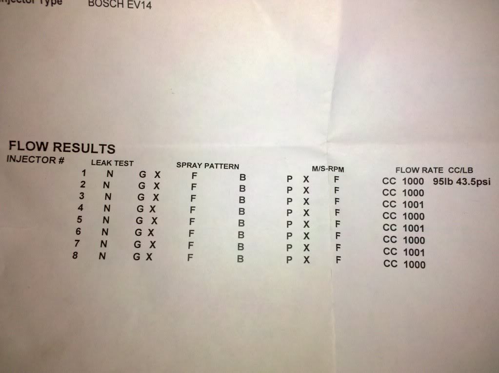

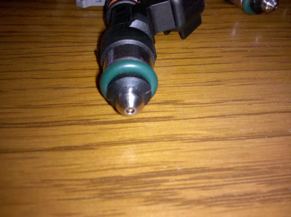

FIC 1000cc injectors, they flow 95lb @ 3 bar (43.5psi), 108lb @ 4 bar (58psi)... I just told him I wanted 80# injectors and he told me to reach my goal of 700rwhp on E85 I would need at least 95lb injectors so he sent me these LOL:
High Performance New Fuel Injectors - New Bosch - FIC FLOW MAX BOSCH , LS3, LS7, LS8, LS9 95LB FUEL INJECTOR - Fuel Injector Connection
Attachment 136433
Attachment 136434
Attachment 136435
Attachment 136436

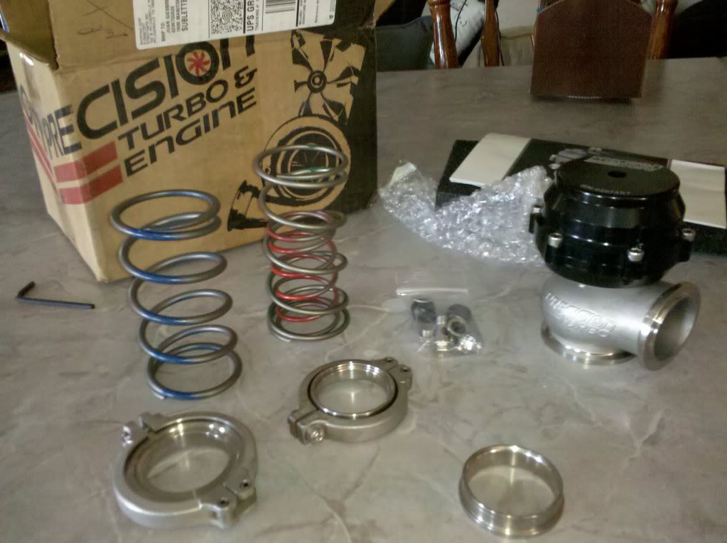

LS1FREEK Jun 6, 2012 11:10 PM
4 Attachment(s)
Precision wastgate, looks like really good quality!

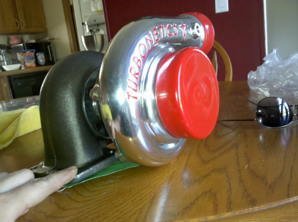

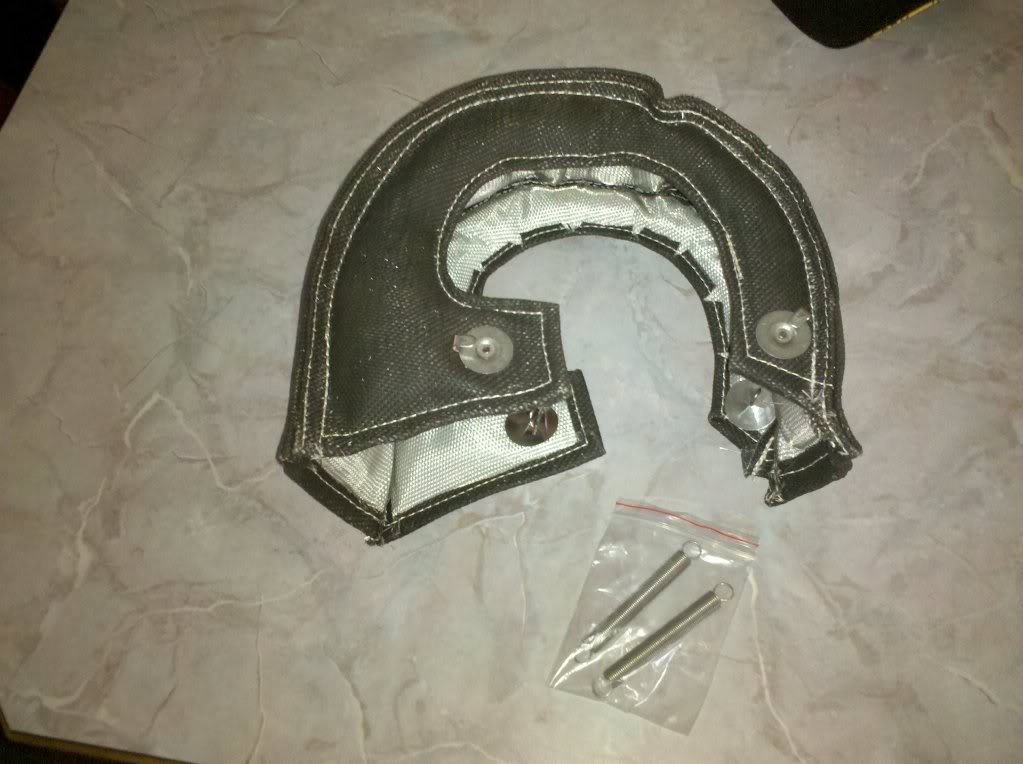

LS1FREEK Jun 13, 2012 08:16 PM
3 Attachment(s)

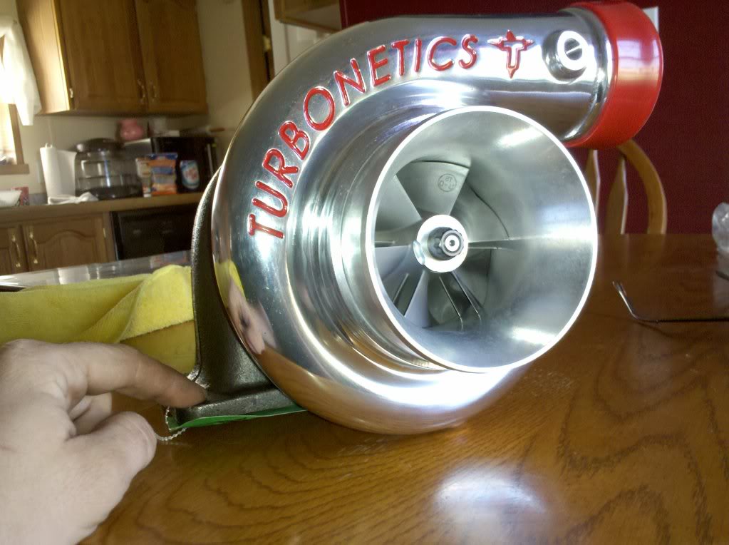

Board up your windows!!! Hurricane Vanessa is HERE!!!
Attachment 135284
Attachment 135285
Attachment 135286

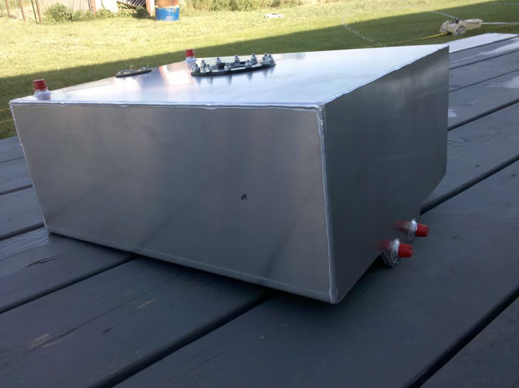

1989k1500 Jun 13, 2012 08:29 PM
Looking good.
What cell is that?
