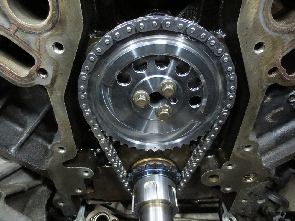

Here is the Rollmaster I bought. It shows lifters in the photo, did when I ordered, but It's the chain set lol
Rollmaster CS1180

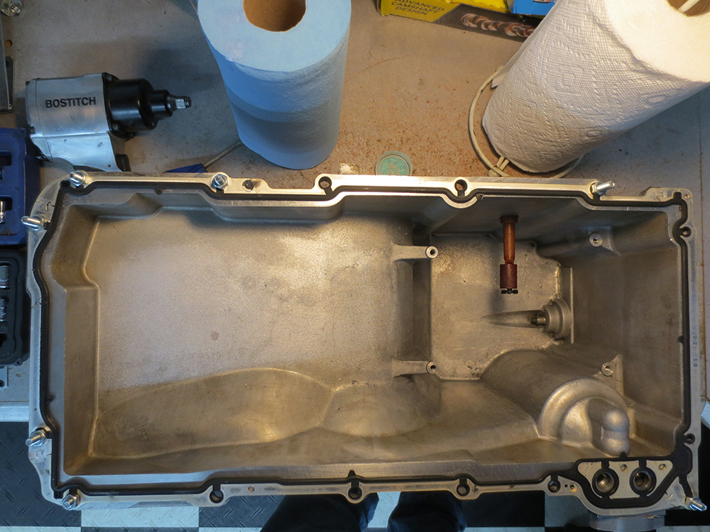

Looks like you did the oil pump and timing set without dropping the pan, any tips in that regard? I really don't want to break the seal on an oil pan that doesn't leak a drop.
That's the after photo... not a contortionist so I opted to drop the pan, 2wd is pretty easy. 4wd I don't know the procedure.

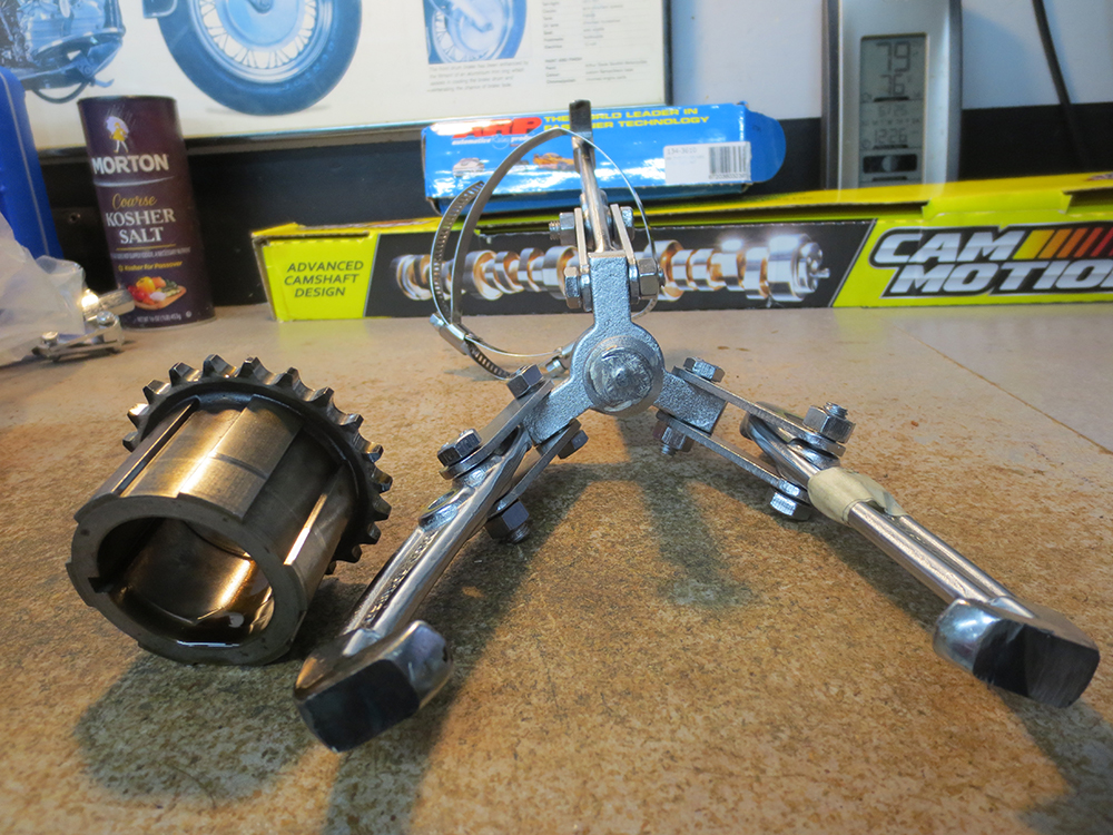

Modified Harbor Freight 3 jaw puller with 2 large hose clamps to keep jaws on the OEM crank gear. The clamp helps when you don't have a 3rd hand to secure the jaws. Rollmaster crank gear installed by hand.

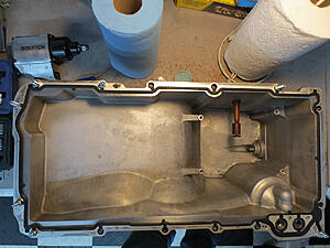

Pan clean with new gasket in place. I used a little RTV on the corners between the new gasket and the pan. The nuts and bolts (finger tight) were used to secure the gasket to the pan while the RTV setup so no slips during install. (zero leaks)
