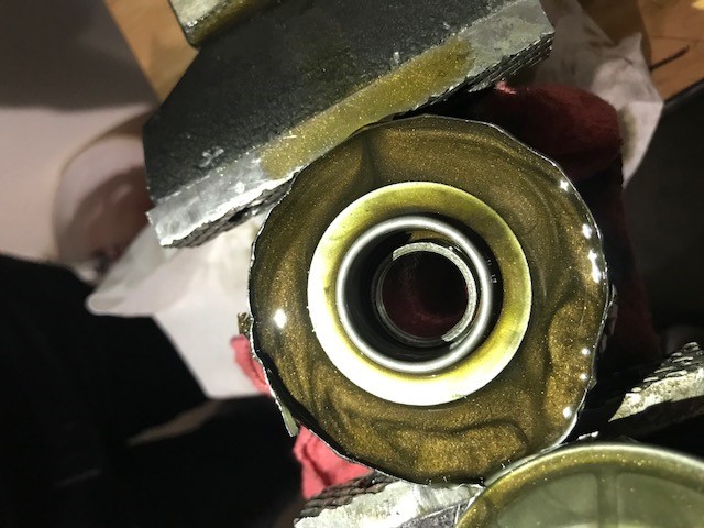

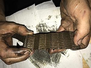

Sensor was fine.... pulling engine. Oil and Filter full of copper. Fun way to start off a freshly built 408 but it happens.

I'll find out tomorrow. Engine is ready to pull now.
Maybe 200 miles on this engine. Never saw high / excessive boost while breaking in. Made a few pulls after 50 miles up to 6,200 rpm at less than 5 psi. Conservative timing.
I'm running an auto meter oil pressure gauge in pressure port on top of motor. Was idling at 20 psi, never knocked (in scanner or audible). Had scanner hooked up entire time.
Timing started bouncing, o2 voltage fell off, went lean when misfiring at 1300 rpm.
Idled good when I killed it to start troubleshooting (that's the strange part to me).
Turns over good by hand still so we'll see how bad it is.
