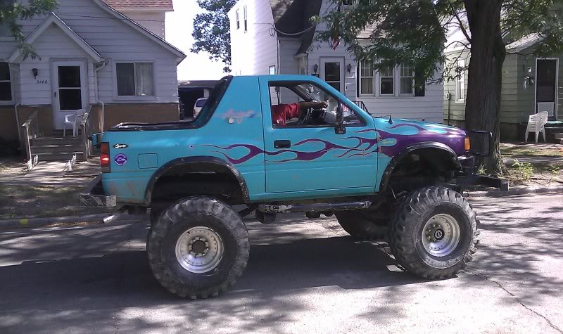

You don't typicaly build a sami to drive on the road. I am sure the toy axles will be wider. I personaly don't like samis at all but with a ls anything becomes kinda cool!
Here is some insperation. Had a SBC on a blazer frame. It was kick ass.
Attachment 148213
