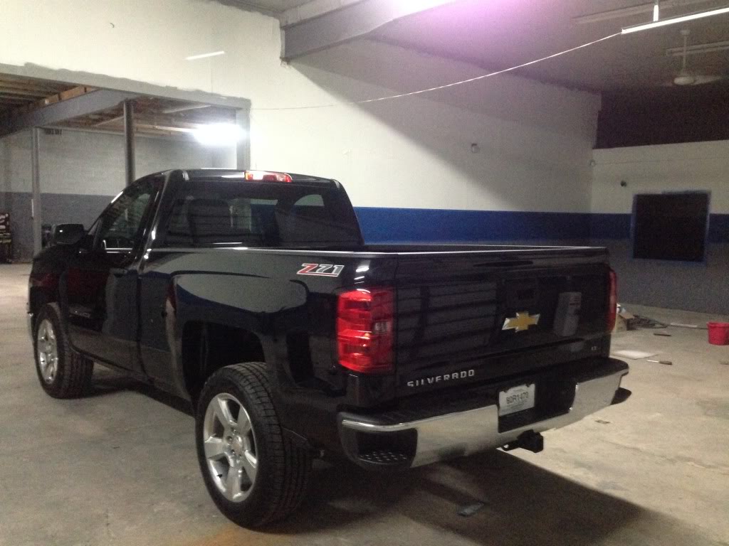

I am the tuner/fabricator.. We have a shop and this is a customer truck.. Ill post some more pics.. Here is a pic of the truck when we first got it.. Name:  null_zpscd9b8622.jpg
