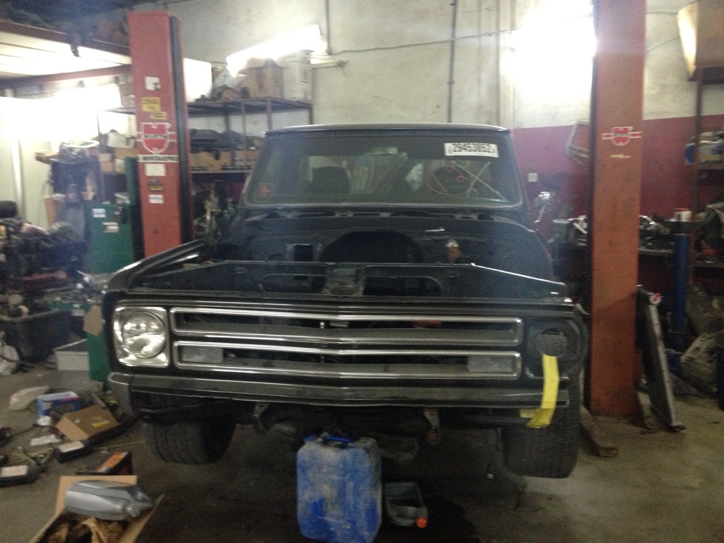

It arrived safely! the crate was built really well thanks to frank@revolution race works for everything..
Here is the engine-less truck leaving my house

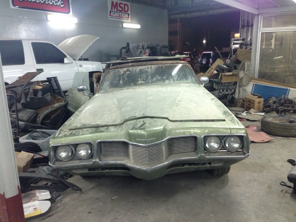

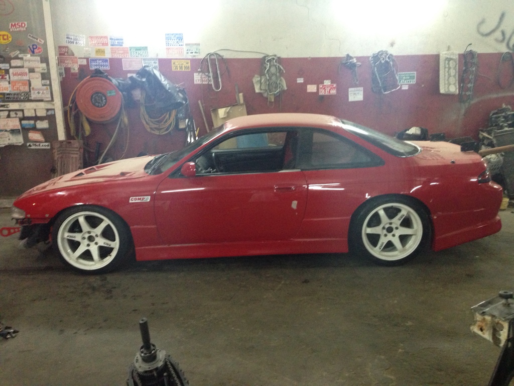

i took a few pics of random cars their working on at my friends shop

Originally Posted by supercharged680
What the heck is that thing doing there?
Old Apr 2, 2013 | 11:44 AM
  #198
supercharged680's Avatar
Joined: Sep 2009
Posts: 948
From: Dubai, U.A.E
Originally Posted by Spoolin
Congrats!! Now hurry up and get that thing together!!
its in for restoration

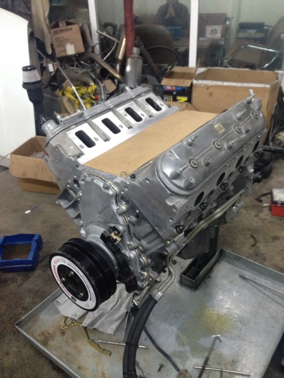

more engine ****! we fire it up tomorrow any break in tips?
i was going to fill it up with oil get it up to temp.. then change the oil and drive it for the next 150-200 miles then change the oil again, switching to synthetic.
Old Apr 2, 2013 | 04:35 PM
  #200
Atomic's Avatar
I have a gauge for that
Posts: 16,282
Likes: 438
The first 30 minutes /20 miles of an engines life are the most important in terms of making it last. You need to vary the rpm and cylinder pressures a lot, hence why the best break in procedure is spirited city driving!
