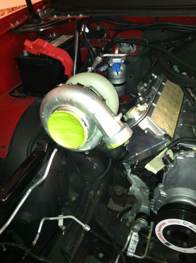

I'm running into a few problems. There won't be anyway my coolant reservoir will mount in the stock location. Need to figure out how that can be replaced or remounted.

Mount is sideway if you can or get a universal overflow tank, there was allot of options when I looked last time. I am doing the same but not there yet.

Where are you finding the universal reservoirs at?
