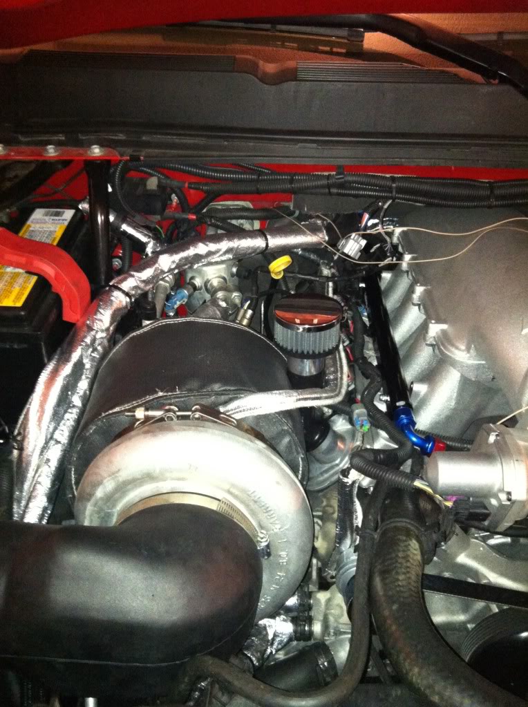

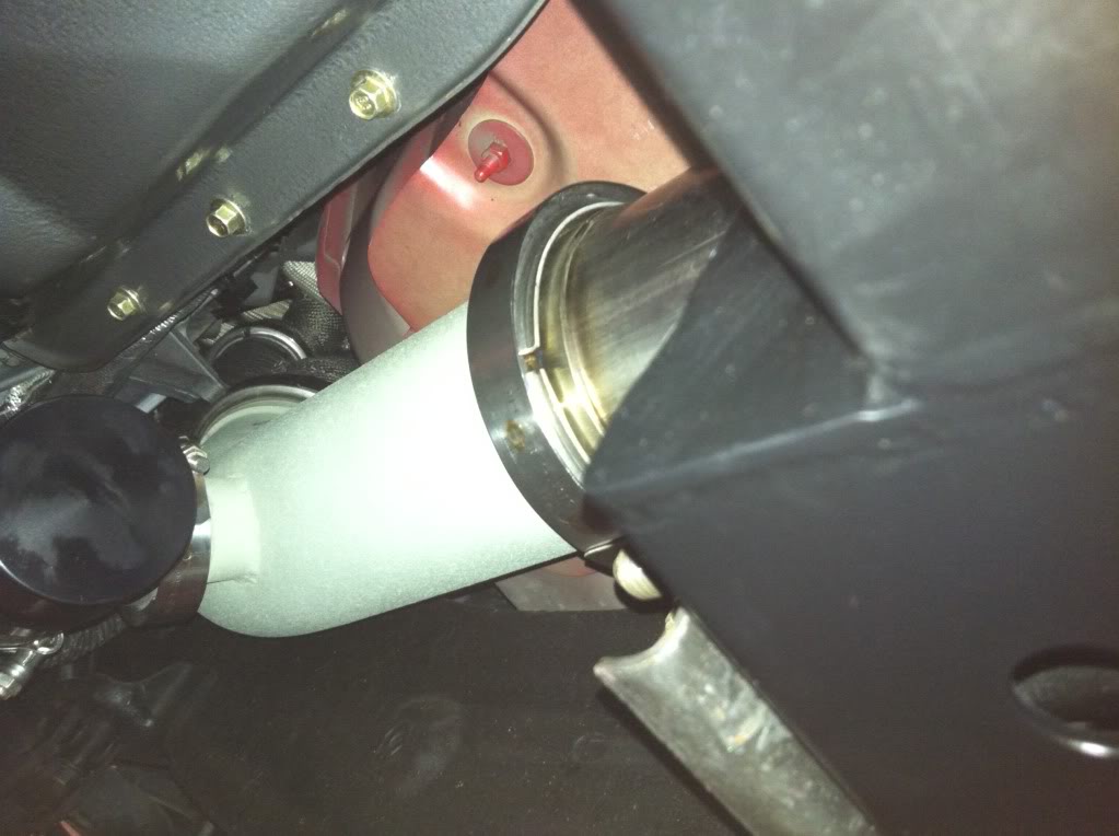

Intake is on but I ran into one problem. The FIC2000 injectors seat too far into the intake and cause them to pull out of the fuel rail. I got in contact with FIC and they have billet collars to put on the injectors to keep this from happening. Got those coming..... Exhaust is done. Had my friend Rich tig the joints and hangers on. He went above and beyond and made them look awesome. The guy can definitely weld! I did spot weld them with a mig welder and found out that wasn't the thing to do. Should've bought a roll of stainless wire and then used it. I just caused Rich a lot more work as he had to grind those welds off... sorry...
I guess you learn something new everyday! About all that is left is put the V-band clamp on the front of the exhaust. Remove one broken bolt from the frame for the sway bar mount. reinstall the sway bar and see how bad it's going to hit on the crossover pipe. Ran into a leak on the transmission. It's coming out of the internal wiring harness connector. Greg at Phoenix sent me out a new one. Need to install that. Put the fuel rails on. Figure out what air filter I need. Also need to maybe lengthen the intercooler pipe to the throttle body and weld the IAT bung in. Pipe is too short because of how high the intake sits.

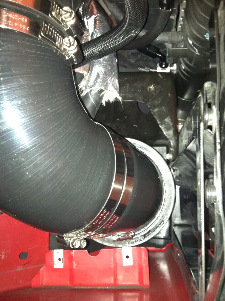

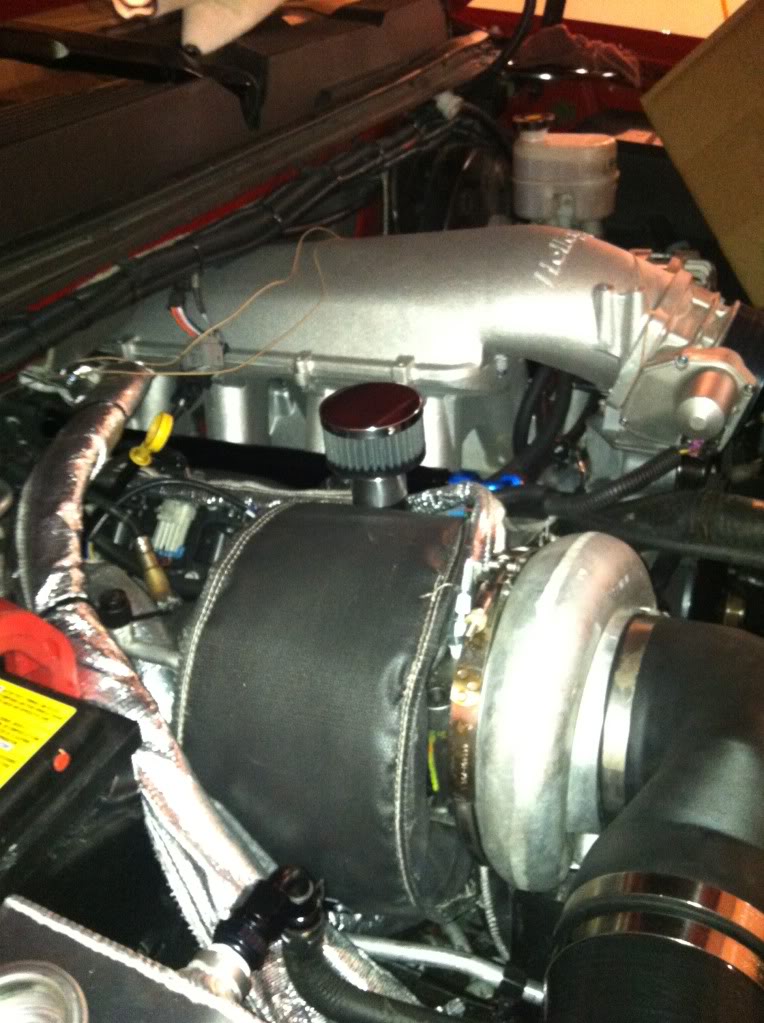

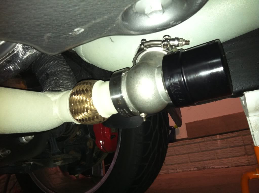

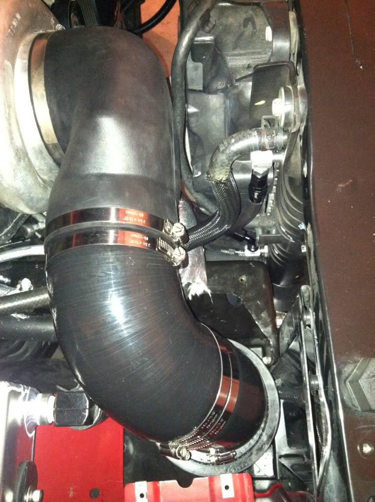

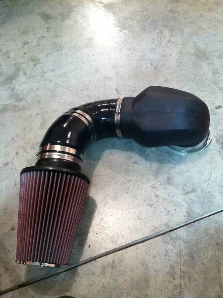

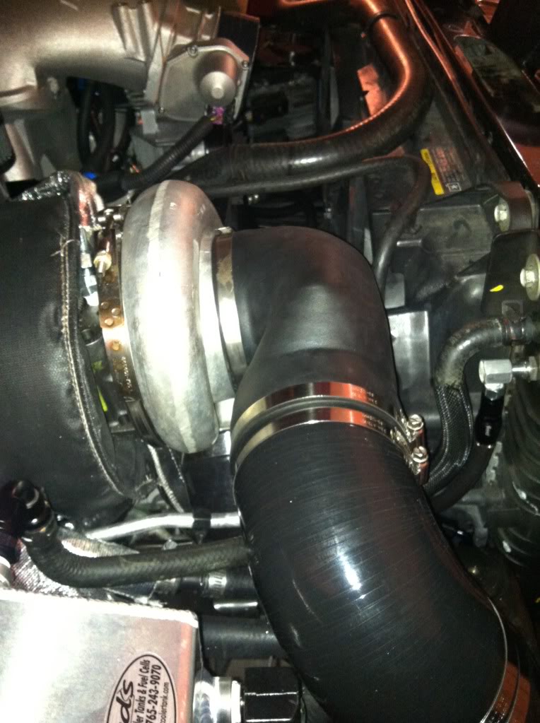

Air filter and ducting came out fairly descent. It's a little saggy and needs some support but will work. Filter is down there and hope that it gets some cooler air vs the filter right off the inlet of the turbo. The bend at the throttle body is a 4" straight coupler and a 45 degree 4" to 3" reducer. It also has a 4" metal jointer in there. I don't really like how that came out. Had to do a lot of trimming to make those fit right. It really probably needs a 60 degree bend reducer there but I couldn't seem to find one. Waiting on one fuel line fitting still. It should be here this week.
