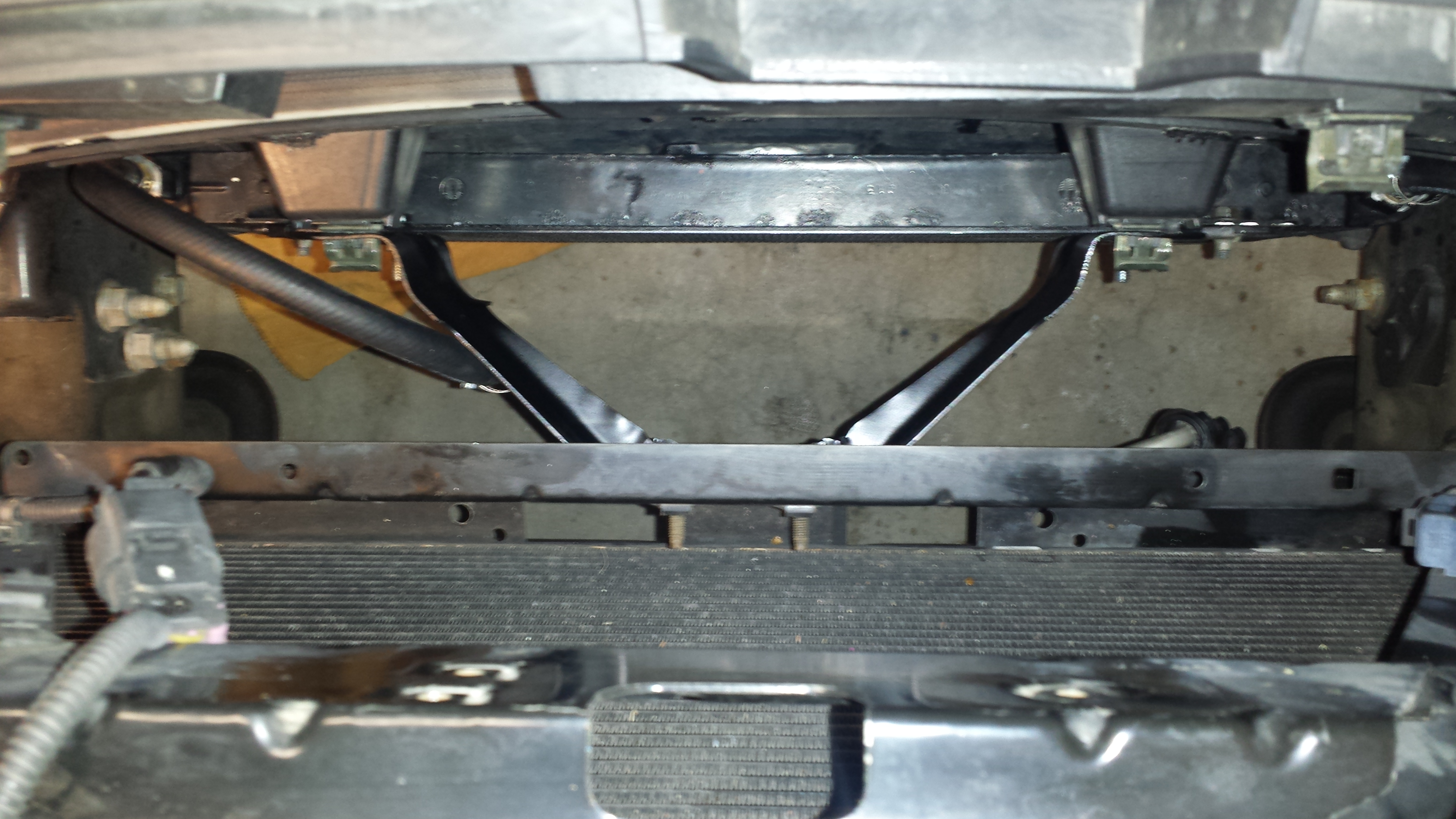

Today I removed the auxiliary trans cooler and installed a TrueCool 40K. I mounted it about 12 inches lower so my heat exchanger would fit. I also fabricated the mounts for my 2 gallon reservoir to be mounted behind the front bumper... Tomorrow I will be working on the mounts for the heat exchanger... Fabricating stuff always takes me forever!! I spent 6 hours today and it looks like it should have taken 2 hours��.

Damn! The first picture is up side down! I'm retarded!!!! Well, you can see the opening for the trans cooler in the first picture and the second picture shows how much more room I have behind the grill since moving the cooler.
