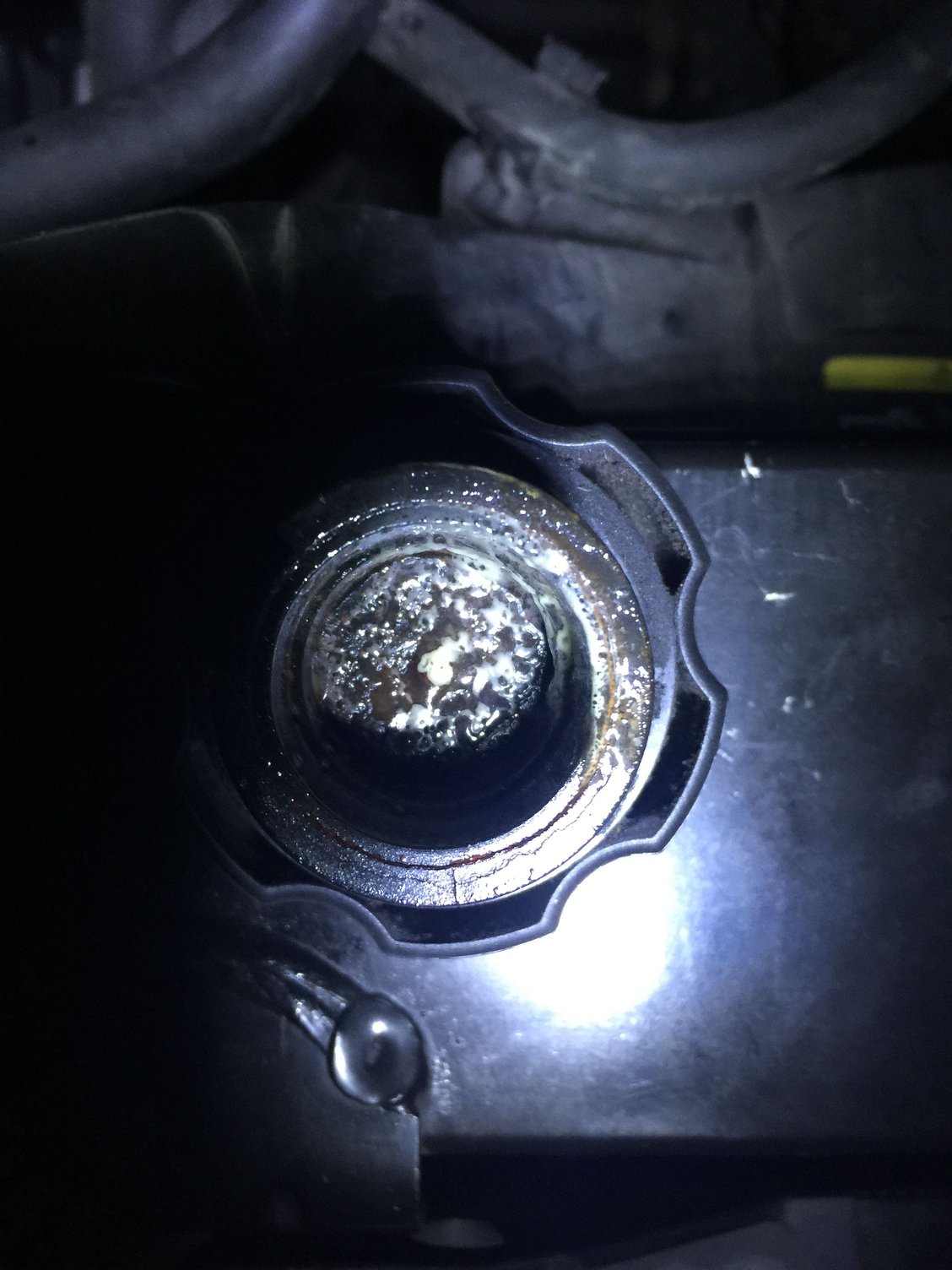

Also changed the evap solenoid. Went to the auto store to have my codes reset and "lost my tune" and got new codes for Lean in bank 1 and 2 and random misfire code. Took it to a different friend and found out the MAF sensor went out. After that was fixed he looked at all my fluids and noticed the reason why I'm writing this thread. I had coolant on my oil cap and on my dip stick.
Yeah my 706 heads cracked and are leaking coolant into my block... So now I'm going to put a new engine in my truck. Any suggestions? Going to try and find a 6.0 but where I'm from (WA) it's going to be hard. Probably have to settle for a 5.3. A part of me still wants a 4.8 it's like rooting for the under dog. Of course right before I find this out is the day my TSP long tubes show up at my door. Those will go on my new engine.

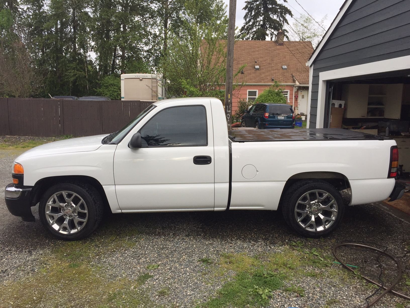

Put the 243 heads in and also bought a set of 2016 Sierra Denali Wheels I always wanted with some new rubber. I don't think the tuner did a good job on my tune because my truck dies when I rev it up as the rpms come back down to idle. Since my last post I put in a catch can that gave me problems for a month and also fixed some regular stuff with EVAP codes. Also my truck got hit going down the highway at about 55 mph. The lady got pushed out her lane and into mine and I tried to dodge her and half way did. Will post some pictures of the damage and new wheels.

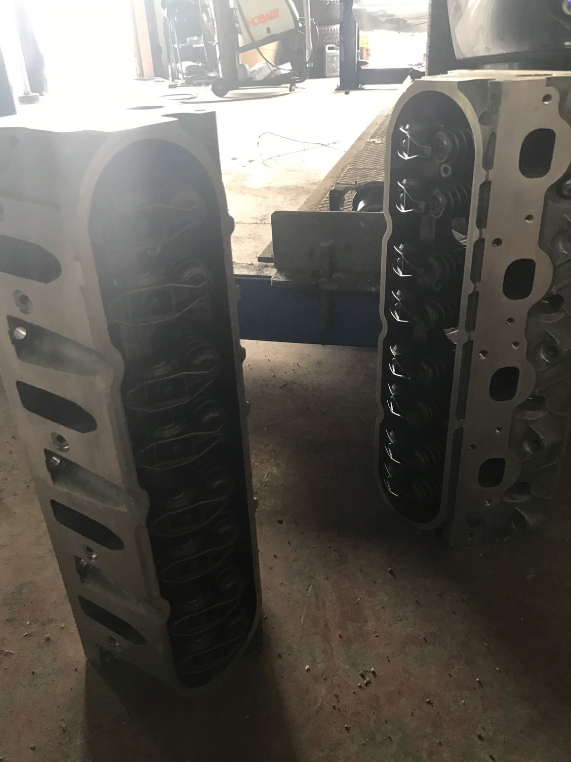

Took a while but got the block stripped down

243 Heads shipped from Houston, TX to Tacoma, WA. Wish I was in TX like most of you.
