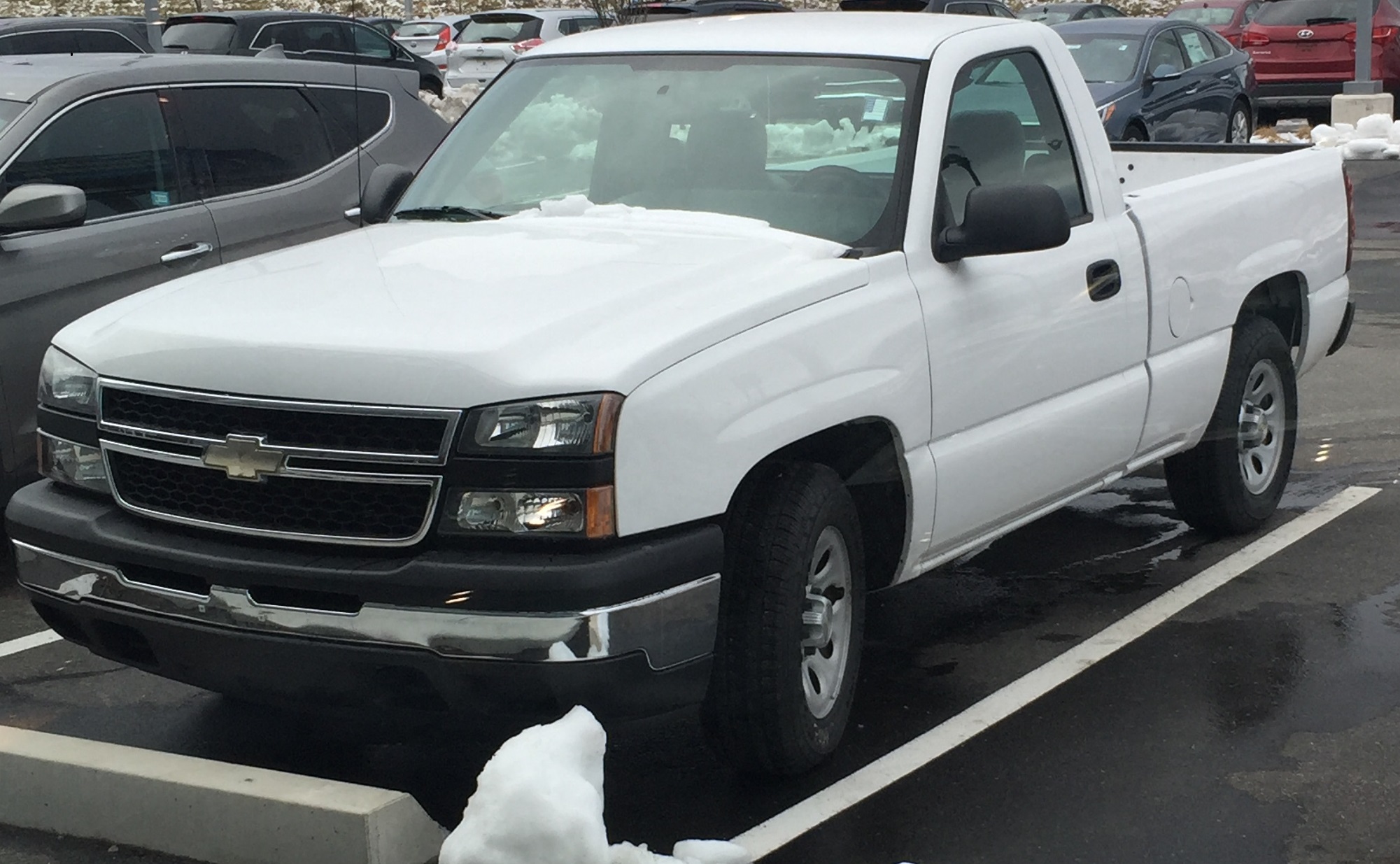

I might at some point.
For my needs I just want something to run around in.
Will be using it to haul my vintage motorcycles around.

Looks clean, maybe put HIDs in and wait for the gauges to go crazy. Those two things are not related in any way. I've had to replace all my gauge motors.

Might do the headlights.
I know the gauge motors are an issue. Lucky everything works as it should....right now....

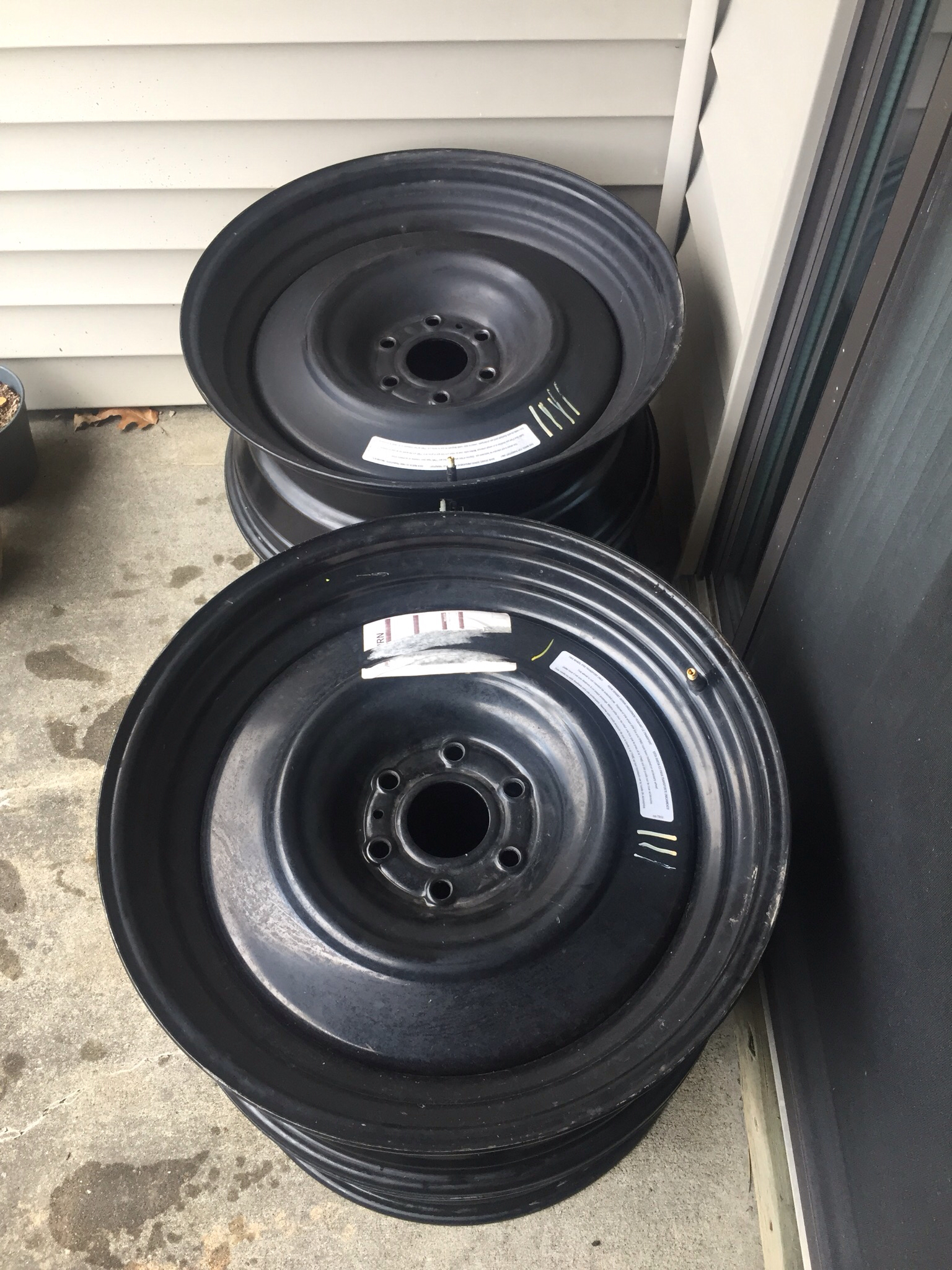

Beltech 5/7 drop ordered. Trying to find a beltech helper bag kit (5008) in stock some where. Seems beltech is no longer making them. Worst case I will use another brand helper bags with that company's notch. Goal is to do as little fab as possible. I see no reason to when there are so many bolt together options.
Picked up a CHEAP set of transport wheels.
90% sure I need 265/35-22 tires to clear....
