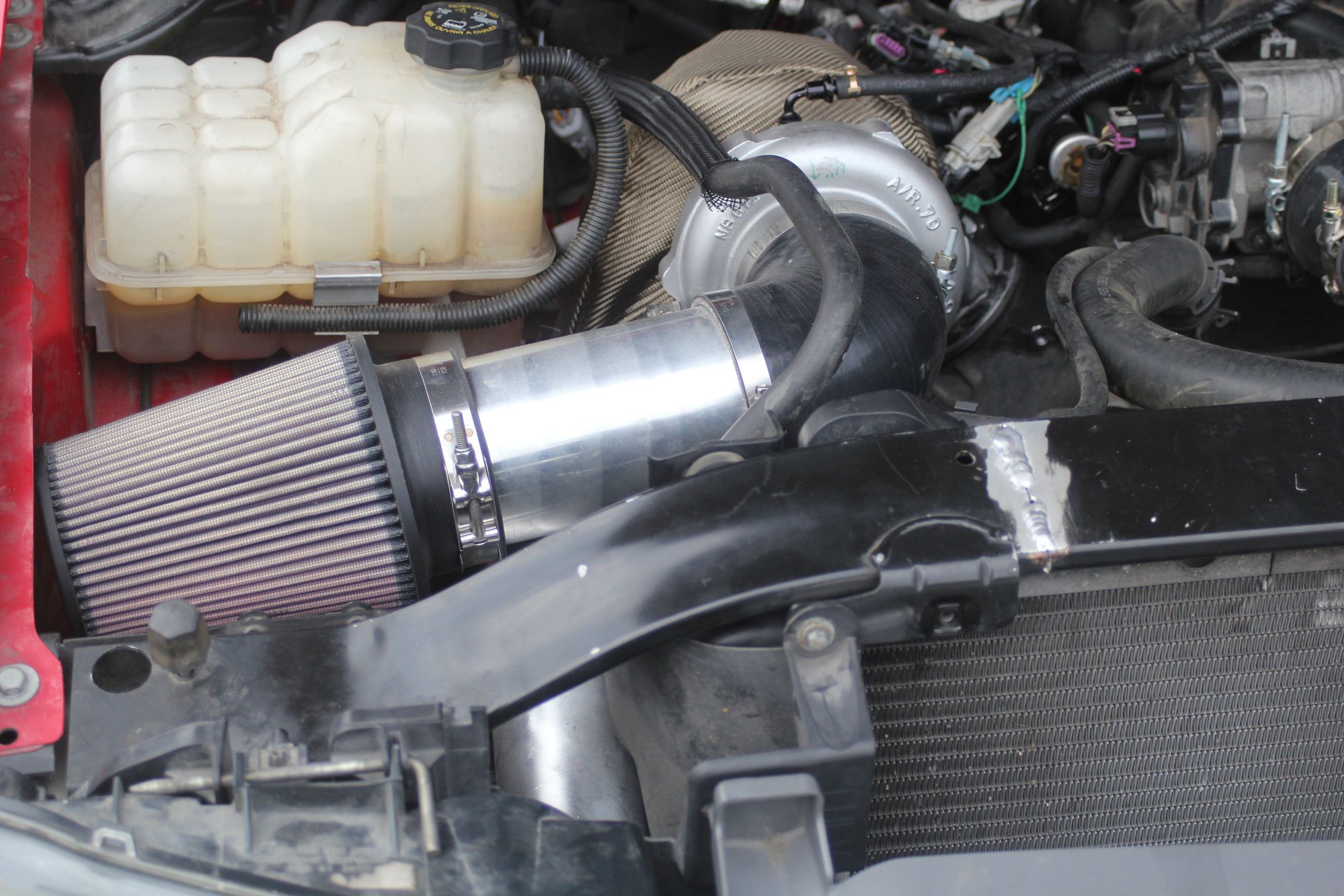

Got some more work done yesterday, time to test the fitments and start on the downpipe. Rough IC pipe route. Still need to get a BOV, anyone have a good recommendation? Turbo smart, tial, jgs?
Old Mar 9, 2017 | 04:06 PM
Atomic's Avatar
I have a gauge for that
Posts: 16,282
Likes: 438
BOV isnt super critical, but tial is always good, china model would probably work just as well with a mild kit.
