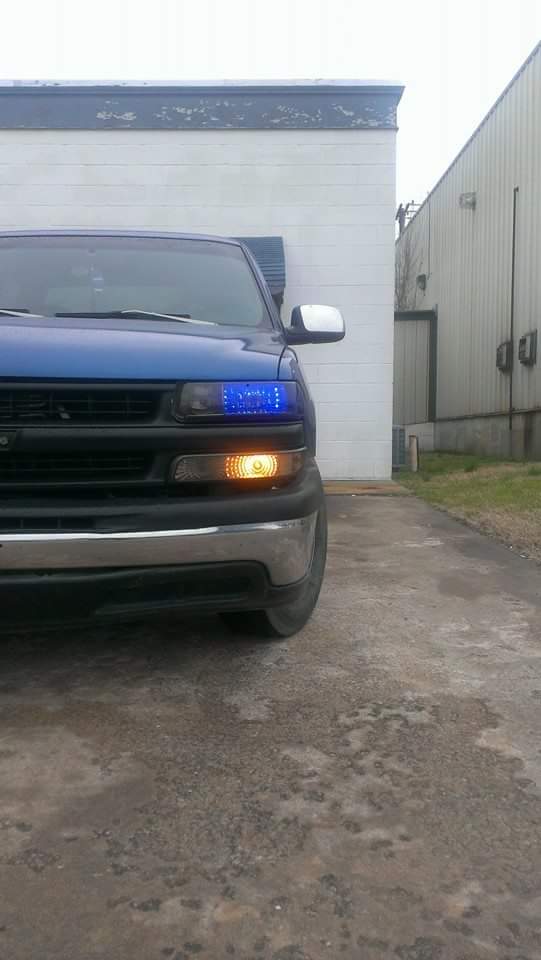

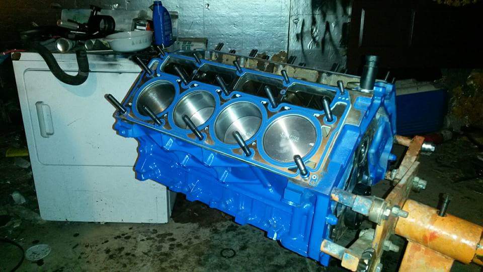

Here we go
Attached Thumbnails 2001 Silverado ecsb build NA-img_20160127_172956.jpg   2001 Silverado ecsb build NA-fb_img_1454304701854.jpg   2001 Silverado ecsb build NA-fb_img_1454304708152.jpg

Here's another front

If i had to guess id say you like blue... Maybe a little?? Good looking truck, think a smurf exploded lol
Old Jan 31, 2016 | 11:37 PM
bbowerman's Avatar
Joined: Jul 2012
Posts: 138
From: Tulsa, ok
Didn't know there was another color lol
