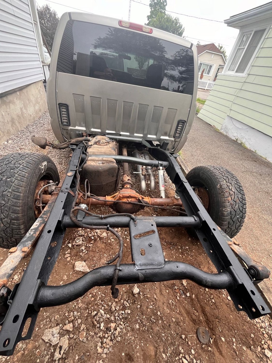

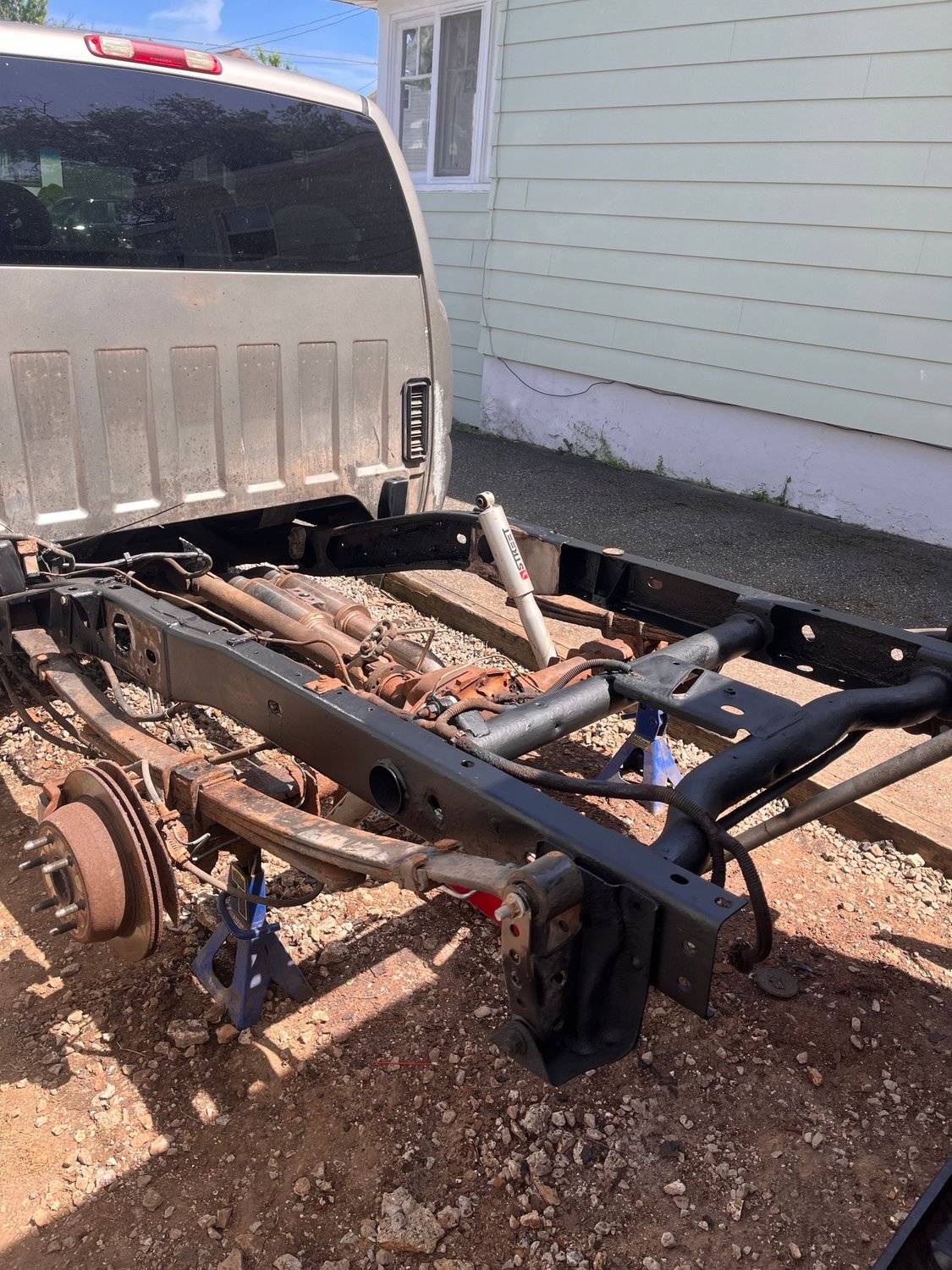

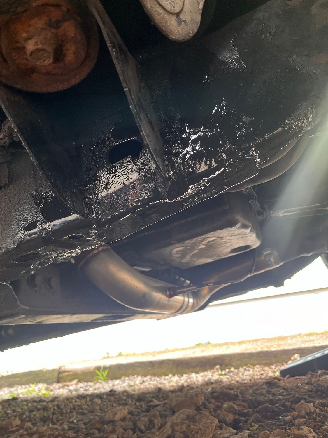

been working on the frame the past week. got it all cleaned up and painted. cut out the 2 rotten cross members, just got to wait for the new ones to arrive then i will install them. also installed the 2' drop hangers.
i managed to cut out some rotten pieces of frame and weld in new steel. should be able to put everything back together next weekend and get the bed back on. then i will take the rear end out and clean and paint it, and install the new posi and 4.10 gears.

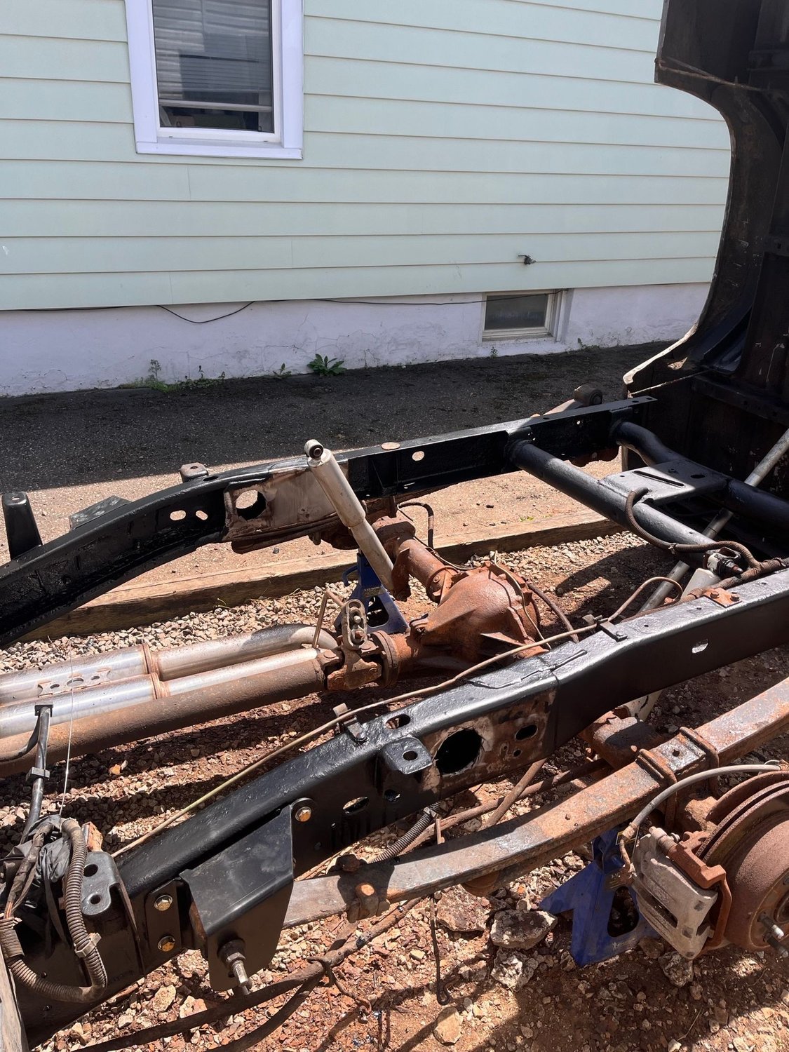

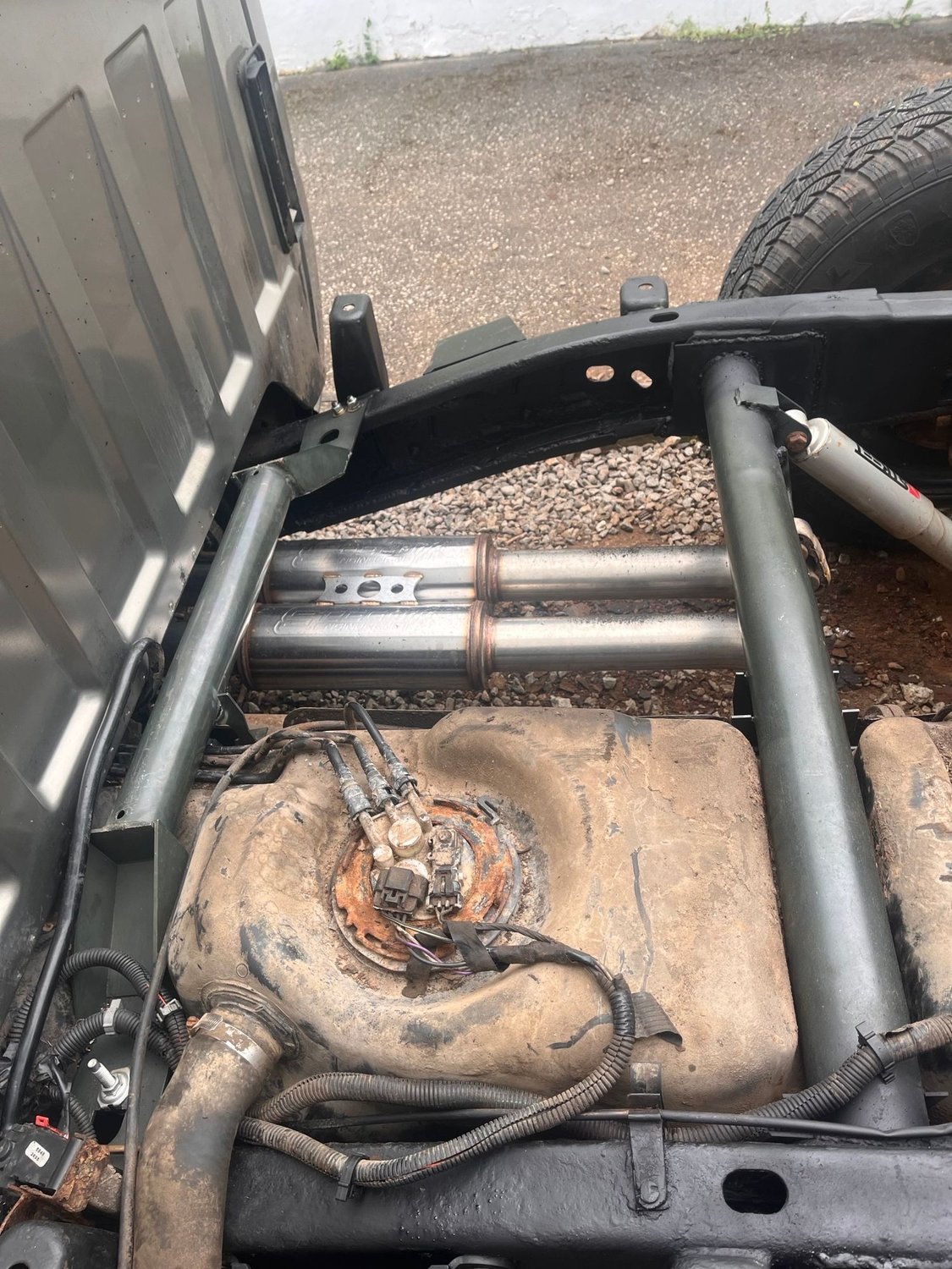

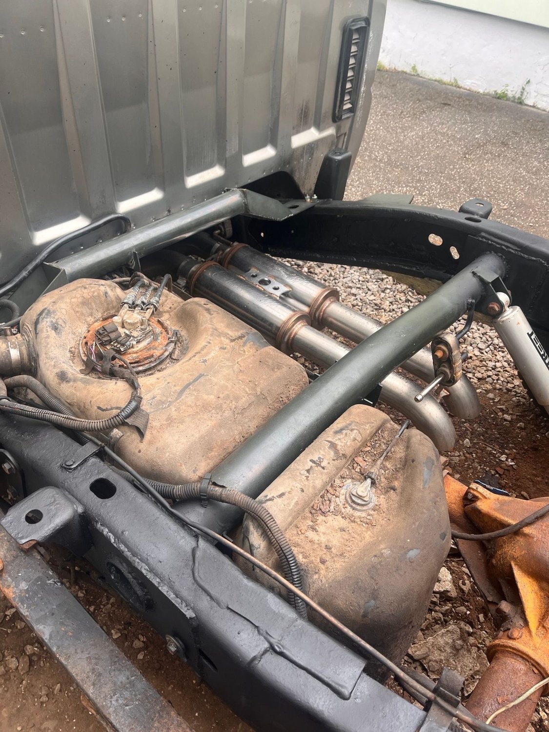

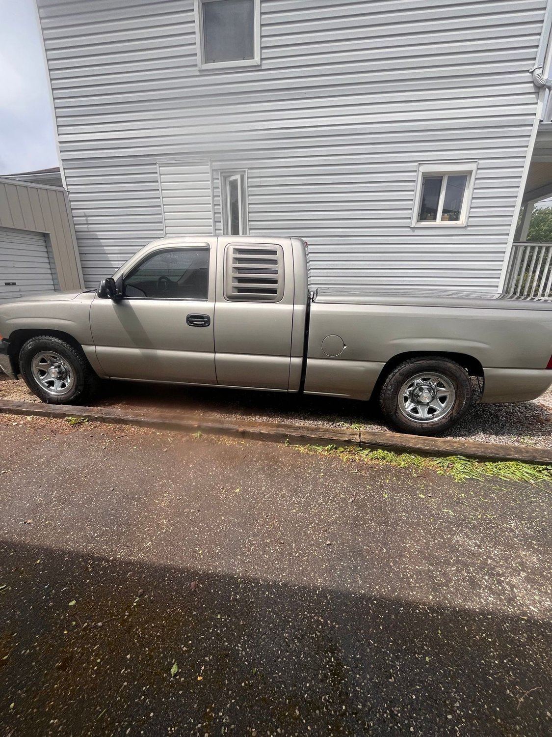

well another weekend down and more work got done on the truck. finished up the rear frame of the truck and got everything put back together. bought these fuel tank support tubes of ebay and honestly better then i thought they would be. everything went back together pretty quick and fairly easy. also finished up the small patch under the front passenger tire, not my best work tbh but the strength is back in the frame just doesnt look the prettiest. also to a picture of the truck and the new stance. the front is still a bit high for my liking might get 2' drop spindles but that will be at a later date.

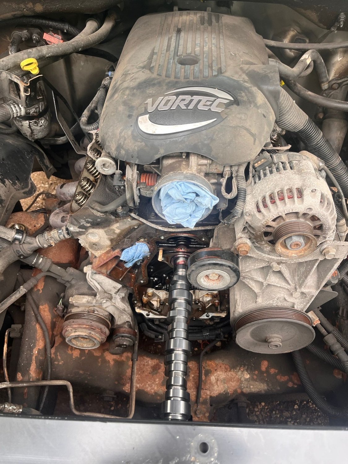

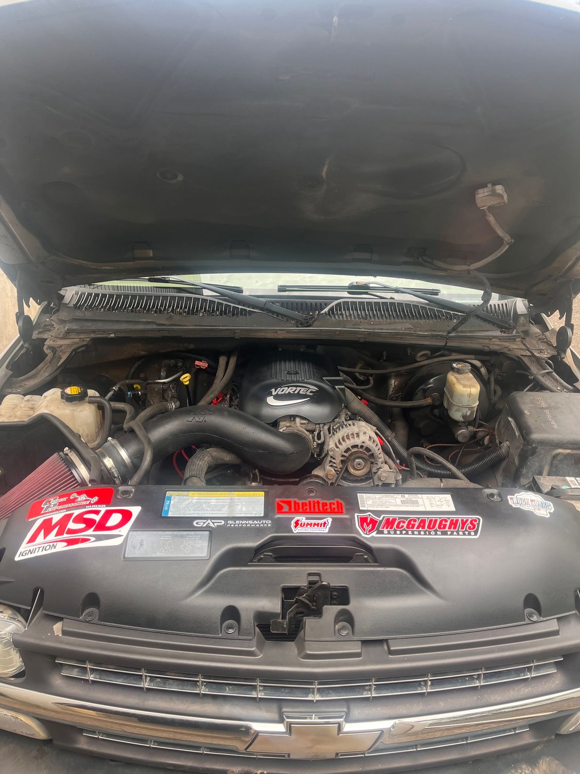

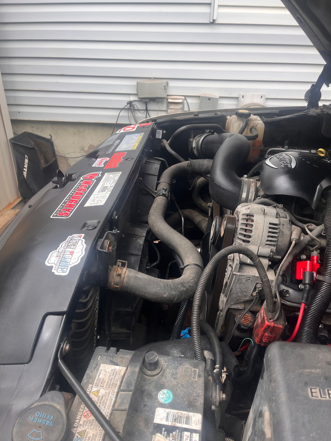

well finally got to installing the fun stuff. put the truck norris NSR cam in and the installed the electric fans. I love working on this truck, everything for the most part is super easy to do when you have the right tools and parts. took me about 4 hours to install the cam and fans. fabricated 4 little brackets to hold the fan in and we are good to go. I installed the tune that I got from Michigan motorsports, its a good enough tune to get me going but there is definitely some fine tuning that needs to be had. I had to re-work the idle a bit and even now its still idling in gear around 1000-1100, not sure if thats normal or not after a cam install(my first cammed motor). i did get a new IAC should be here this week and ill put that in to see if that helps. all things aside this thing sounds amazing! and it definitely has some more power up top. the truck is still a dog off the line with the little 4.8, but install the posi and 4.10 gears in the next coming weeks and that should help. also going to get a higher stall converter as well(2500ish stall) then my little street machine will be all good to go!! then i can get onto the body work this winter.
