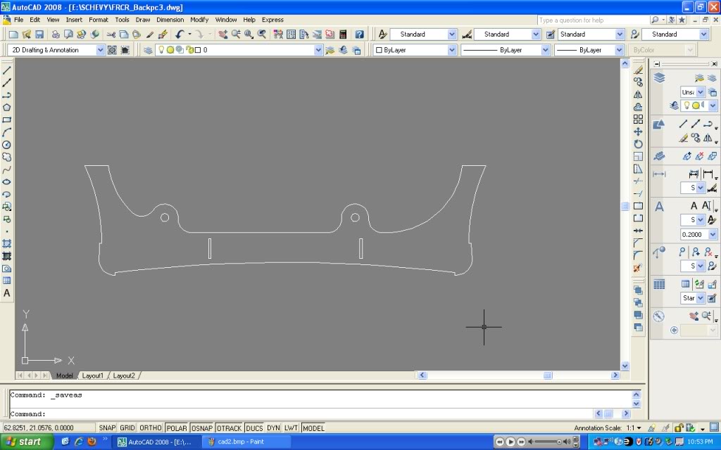

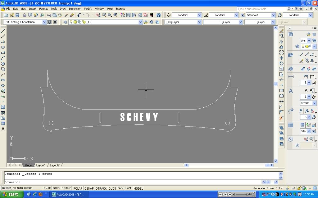

Here's a few sneak peeks, the first two are front and back pieces of the front most crossmember, housing the LCA front mount and the steering mount.
The last is the rear LCA mounts and Motor mounts above.
Everything will lock together before it's welded, so some slots are specifically made for locating, along with the offsets on the edges.
