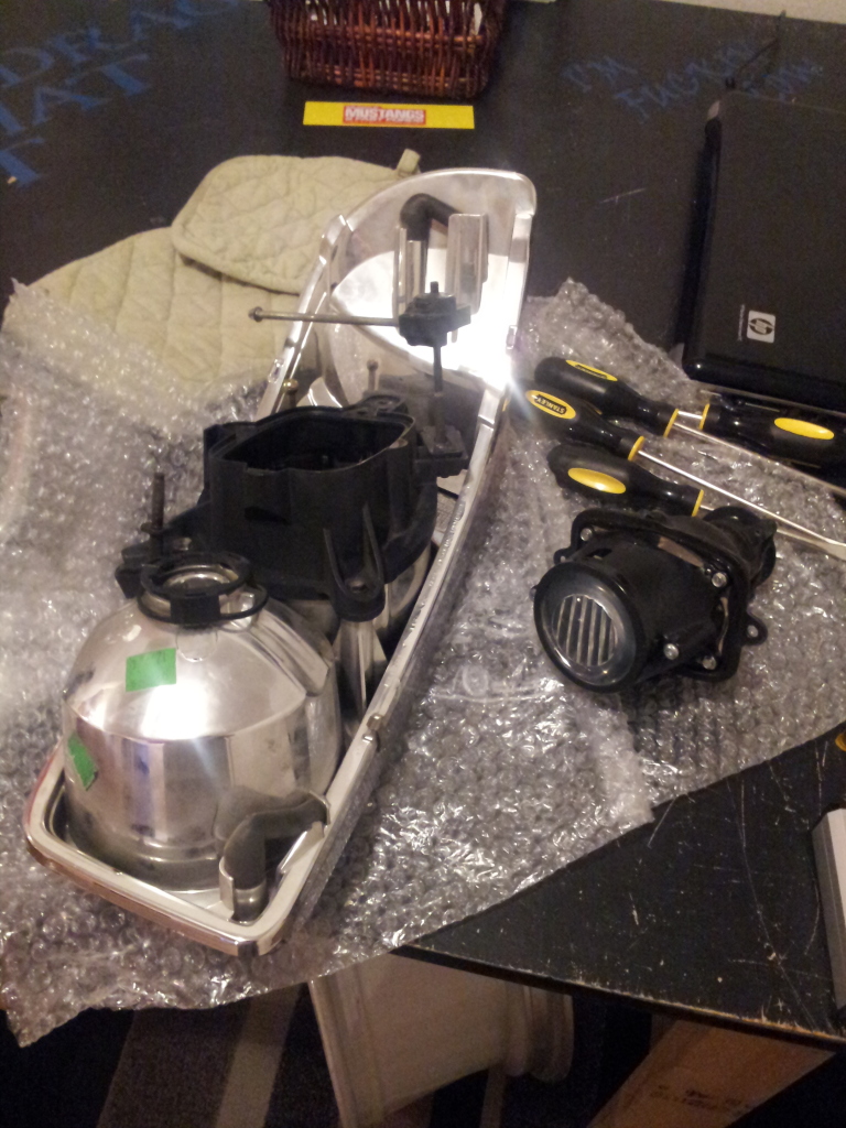

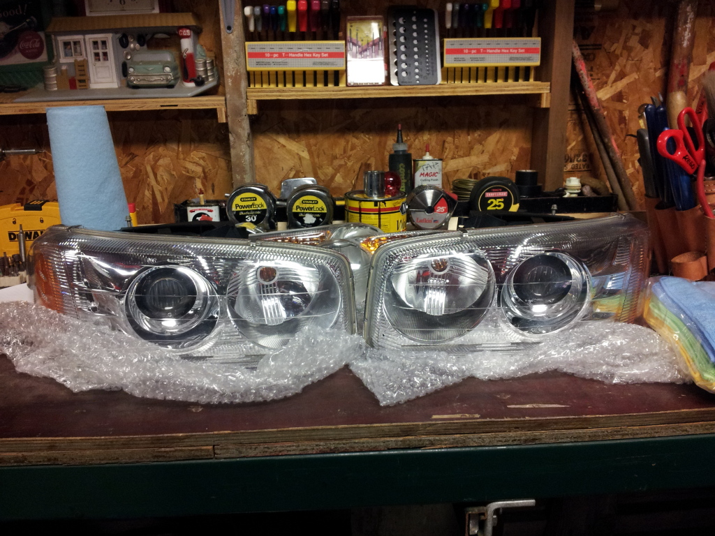

Recently ordered a set of adapters to mount a Morimoto H1 HID Projectors from Ri22o on here to a set of oem denali projectors. Finally got the lights and took them apart. Now I just have to order my projectors and hid's.

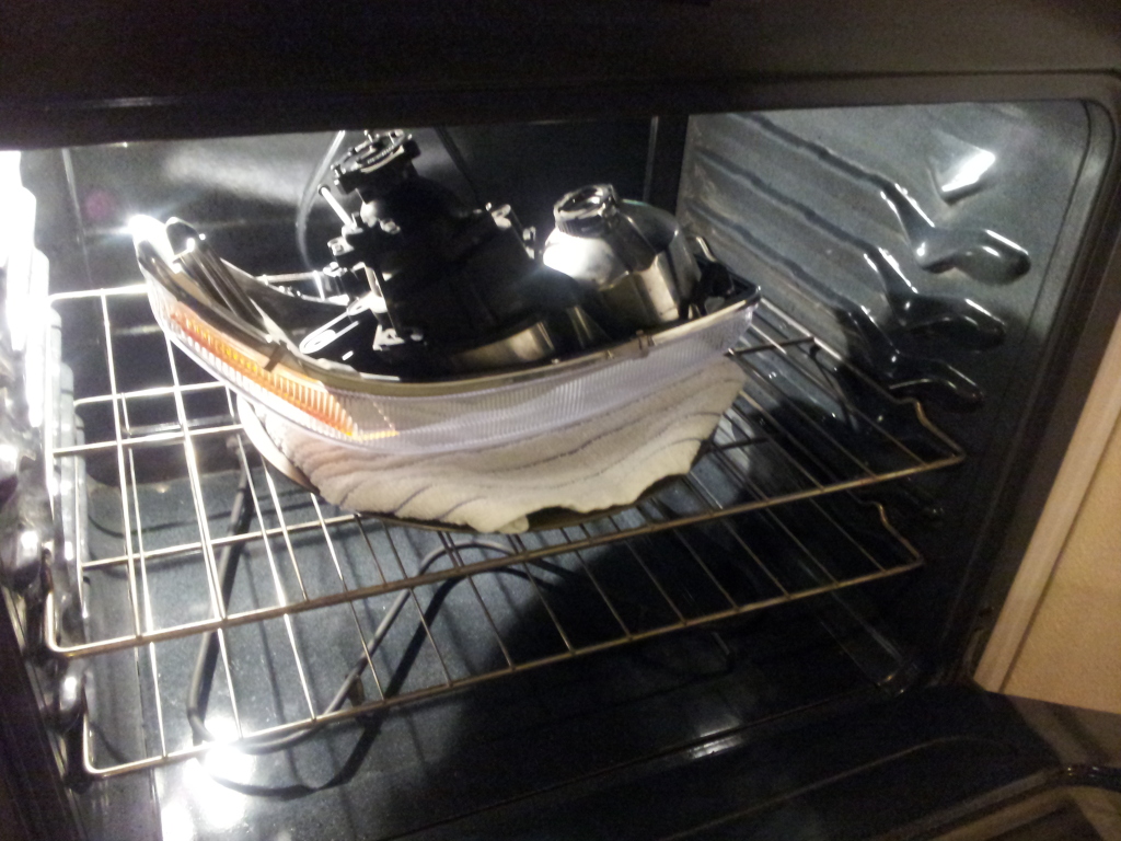

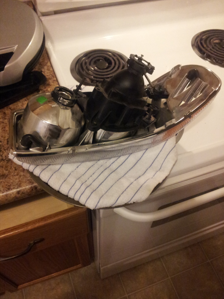

Put them in the oven to take out the projectors after removing all the screws

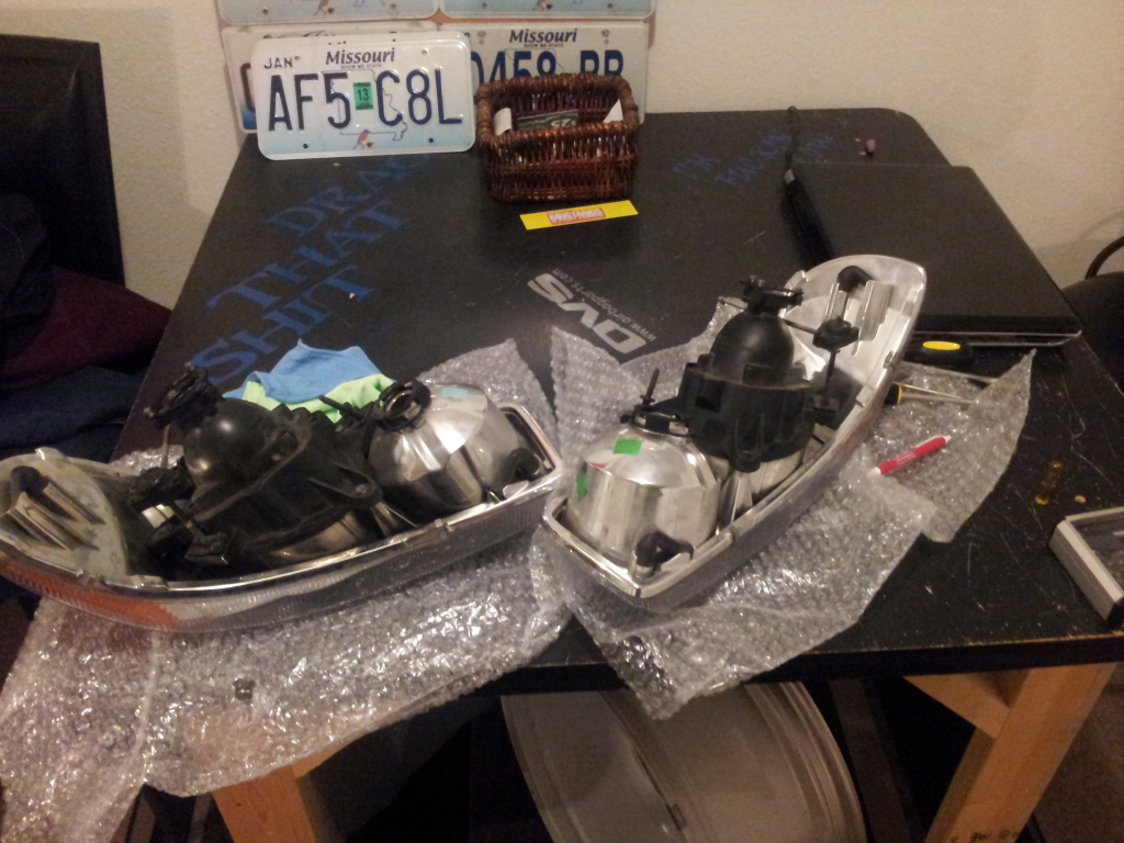

I put them in at 190* for 3-4 min and pulled them apart. 200* prolly would help because I still had to pull like hell.

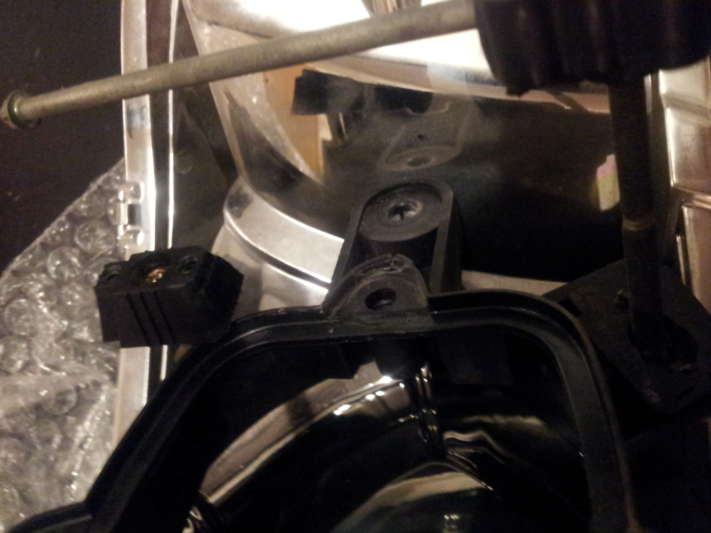

Just make sure to have a couple pot holders around, they get warm

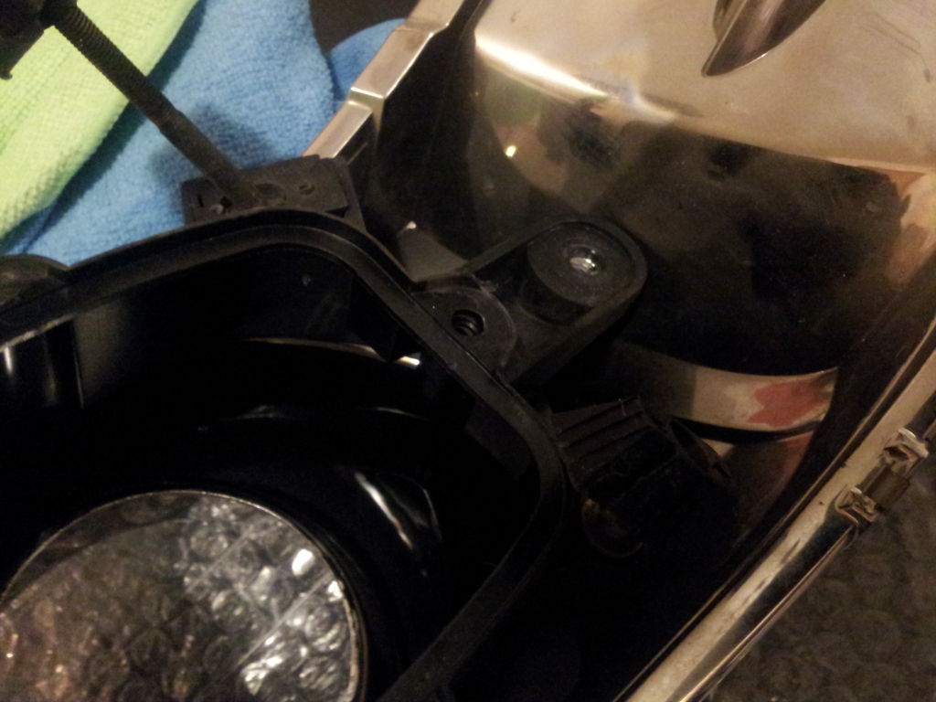

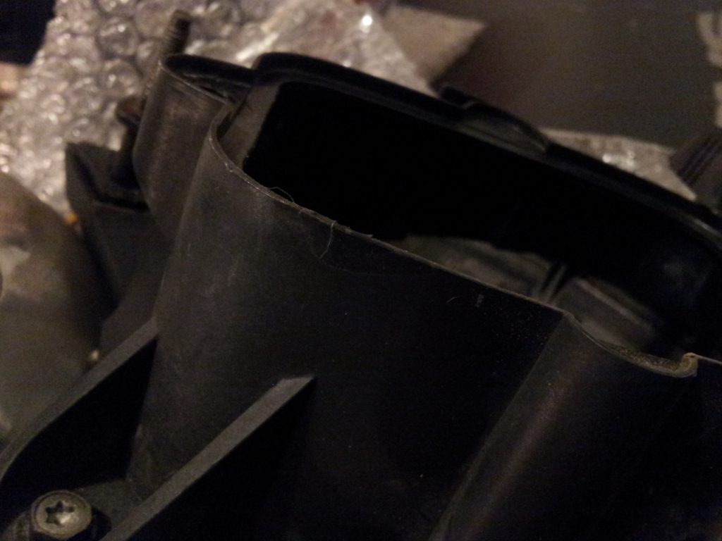

Do not try and pry them out with a knife or screw driver or they will crack, like so
I still got some of the surround when I pulled them apart. Not a big deal because the RTV will take care of it when they are reassembled.

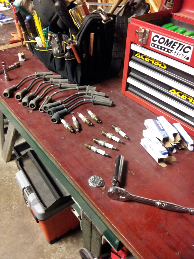

Also had to put a water pump on due to a leak so that took out some funds, while I was on a maintenance kick I done a tune up also.
That was fun.

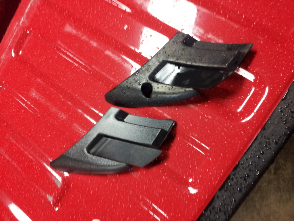

Remembered I also had an antenna delete that I had on an old truck of mine so I threw that on too since I only use my phone for radio I can do without it.
