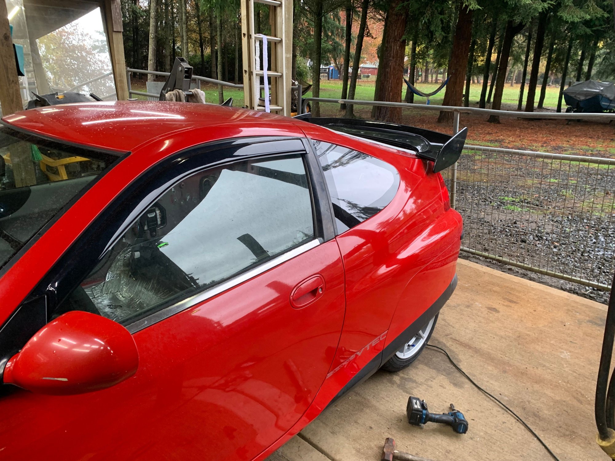

ya your probably right about the nv3500, they don’t shift fast at all. And honeslty having the insight there’s no way a gm trans would compare to how that tranny is gonna feel once I put it together. It’s gonna be a close ratio custom gear set made from some oem and an after market first gear and Honda transmissions can be shifted super fast if they are put together properly. The wing isn’t mounted in its final location but you can get the idea. Also doing a fake cf splitter on the car but both the wind and splitter will both be functional for downforce. No joke the aero crap can make a pretty crazy difference especially with how light the car will be.

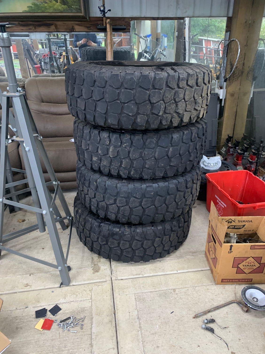

Picked up a used set of iron man 37/12.5/17 tires today for $125. Date coded 21 which is way newer than my other tires. They are just backups pretty much, too good of a deal to pass up. Two have pretty good tread and two are cupped on the wear but I’m gonna use a belt sander to re round them lol. The cupped ones weigh 70lbs, the good tread ones are 75. So about the same weight as my current tires. Also plan on installing the 5.13’s fairly soon but I have to deal with an eviction first and get that unit rerented .

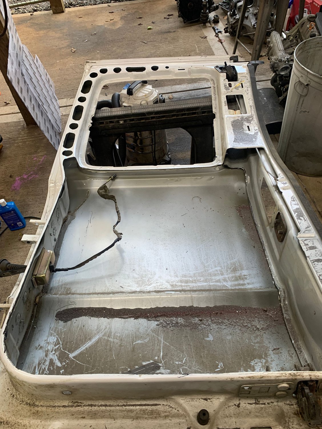

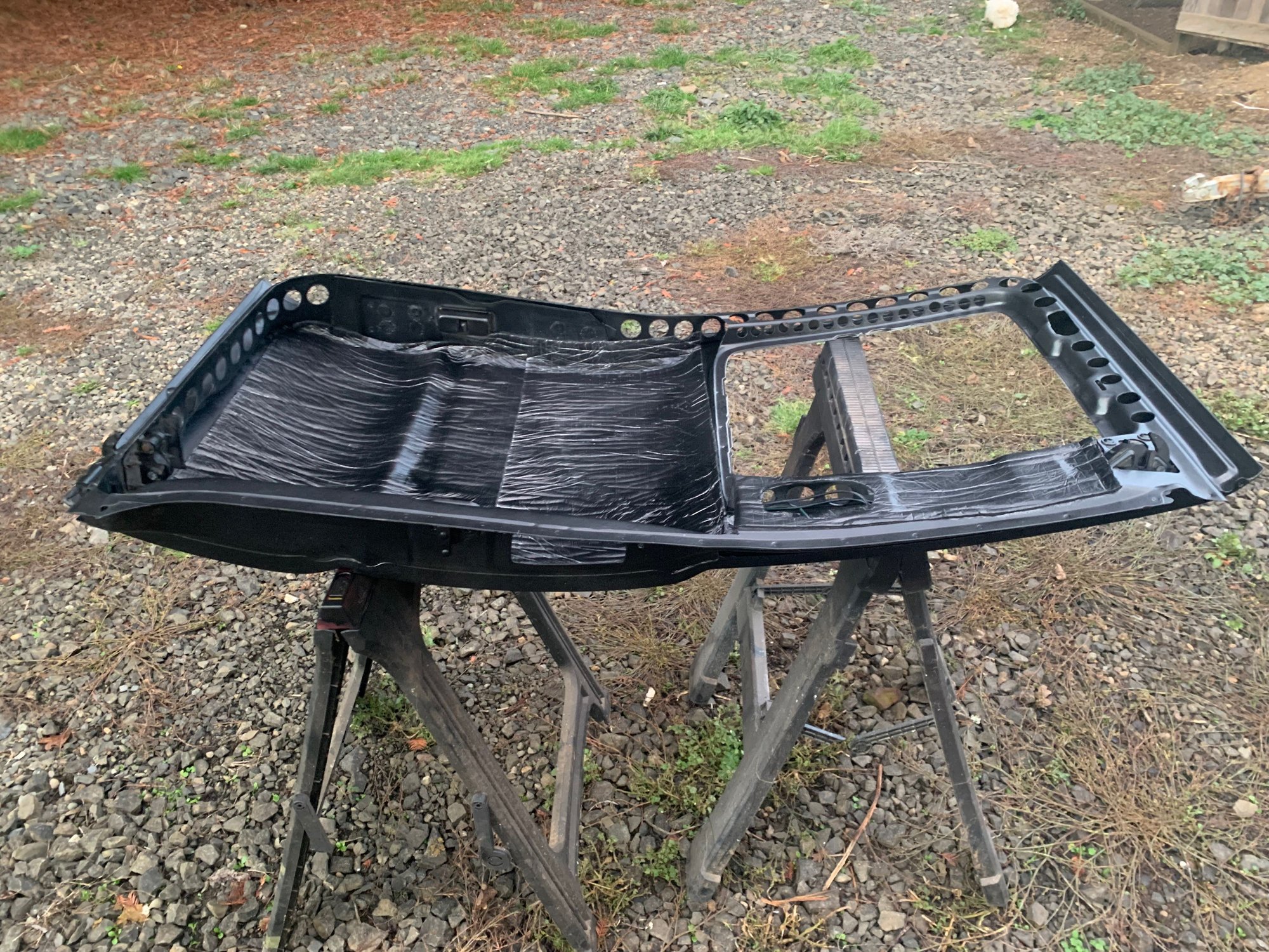

got my drivers side extended cab door mostly done. Think this is about as light as I’ll be able to get it. Laid sound deadening in there and tucked wiring under it for the 4x6 speaker. I have some really nice cf wrap that will be put on the outside and then I’ll paint the back of the lexan and install it. I think the cf extended cab doors will look cool on the truck.

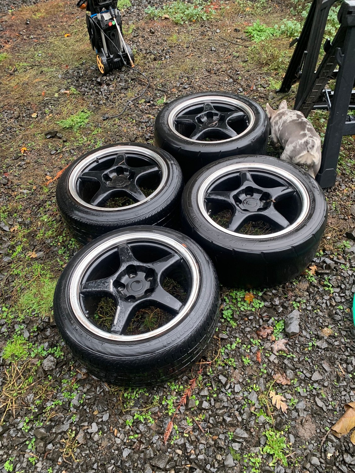

My buddy gave me these for free to clear out space. They need tires but will be going on my s10 and I’ll give my kid my zq8 wheels for his truck. Win win I think cause I’ll be able to run a much better tire selection with 17’s. Ordered spacers for them 2.5” front and 3” rear. Also have a limited slip that needs to go in the s10 but I gotta do the pre runner rear end first and feel confident about it.
