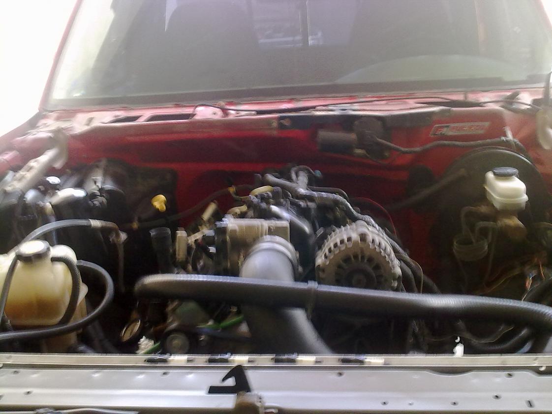

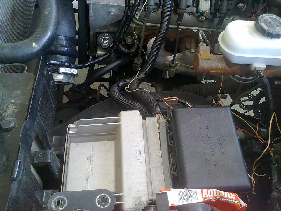

sorry for the lack of time that it took me to uptade the thread..
Engine and trans are mounted, drive shaft installed. fuel system installed. (i deleted the fron tank, and install a walbro 255 pump on the rear tank.)
Cooling system is almost done i just need to install 2 ford 2 speeds fans on the radiator..
The wiring is done too, all stock lightning gages works exept the rpm, i tried to tune the signal output but i couldnt make it work, im going to need an MSD signal adapter and it will be done, truck moves and drives, it only needs the paint and the exhaust system im going to use a magnaflow mufler and magnaflow exhaust tips (2) i will install those on the gen2 lightning location
