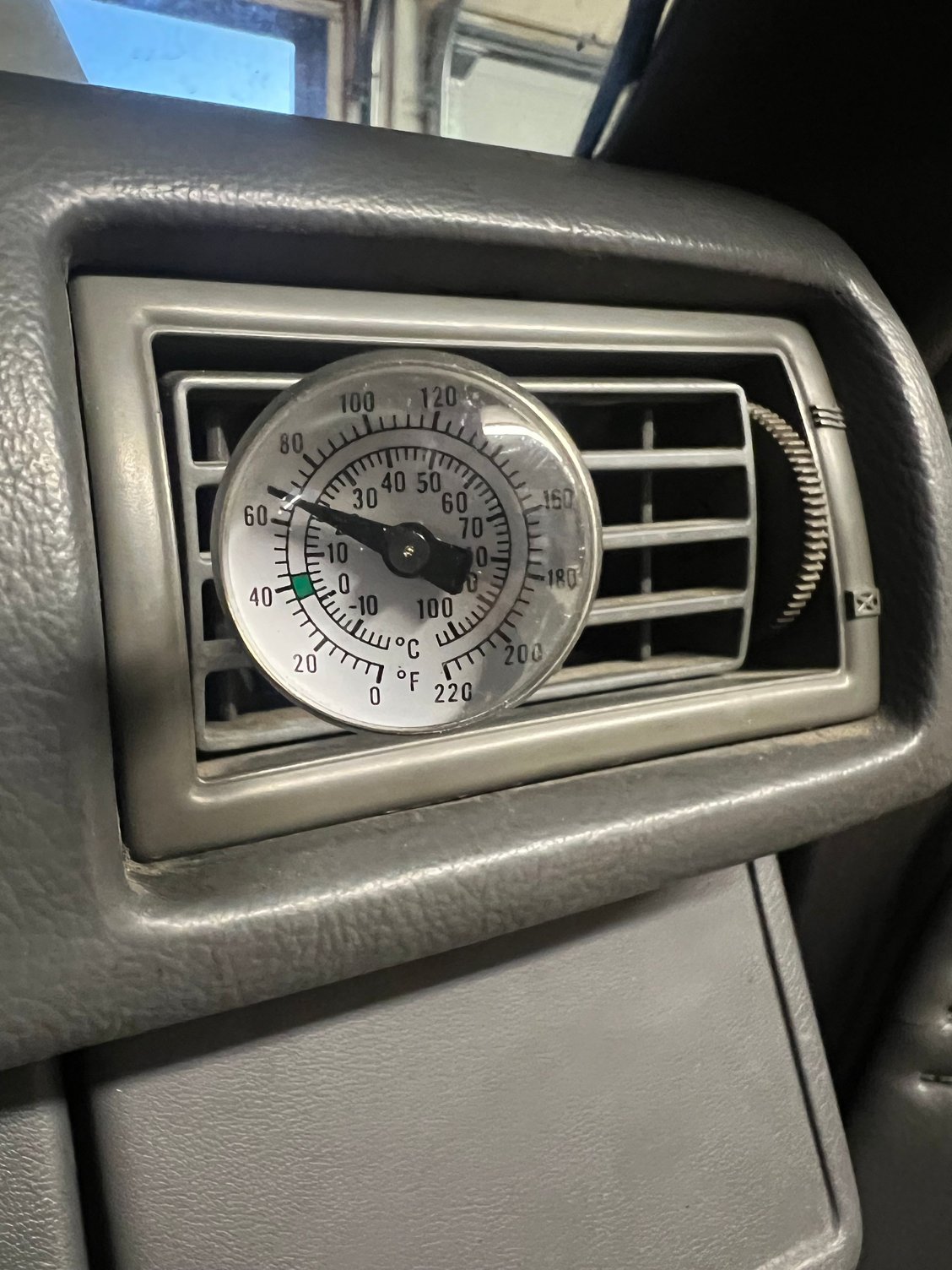

Well it was cool on the way to o’reilly’s to drop the rental stuff off. Bought a temp gauge and drove home. Best it would do is 10* below ambient and it was noticeably warmer than when I went there. The no idle up thing sucks but that’s going to take some engineering because the part has been long discontinued and it looks like mine isn’t working.

Bought my own vac pump and gauges. Put a vac on this thing for 45mins and let it set overnight. No loss. Figured out my mistake on the last time by not screwing in the plungers on the valves attached to the compressor. Got ~20oz ish in there.
Keep in mind it’s a 100* in the shop and I’m running no windows or top so it’s just recirculating HOT air. So it’s running roughly 40* below ambient. I’ve got no complaints. Let’s see how tomorrow goes.

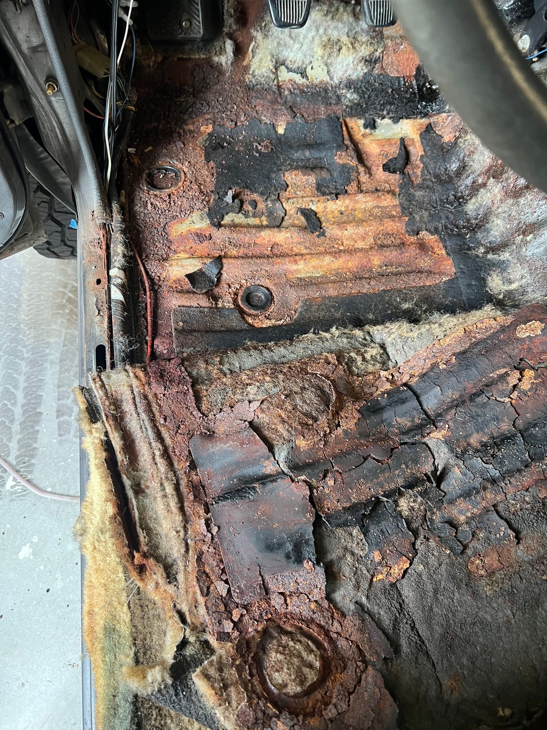

Found rust on the driver side I wasn’t expecting. Got the passenger side wire wheeled and it’s not as bad as I thought. The orange glue makes it look worse than it is but it’s still definitely there. Gonna wire wheel this one and then por 15 it or something on both sides before I put the new carpet in it.
On that note, I’ve made the decision to sell this thing once I deal with these items. I’ve had to reevaluate a few things lately and I can’t afford in time or money to have two older vehicles that need constant attention. The dream for this was to get it working again for Mark but he passed before that happened. Now the dream is to get it stable and pass it either back to his family so they can enjoy it or find a seller who can spend the time on it. It really is a good truck and in good shape. I need to focus my efforts back on my blazer which was my goal a year ago. It doesn’t need much but it needs enough that the 4Runner has become a distraction.
