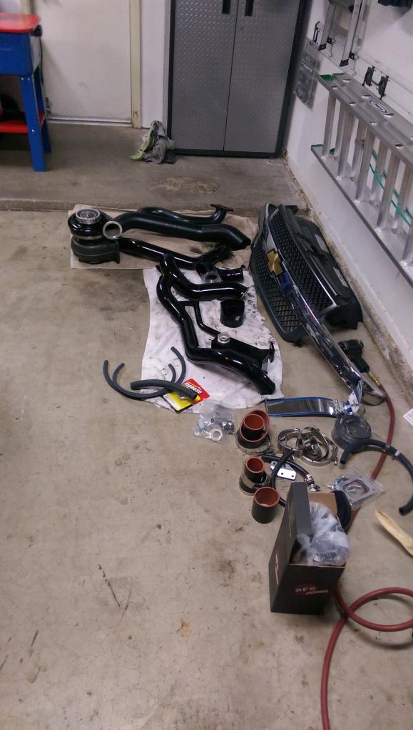

Twin kit is supposed to be here Wednesday.

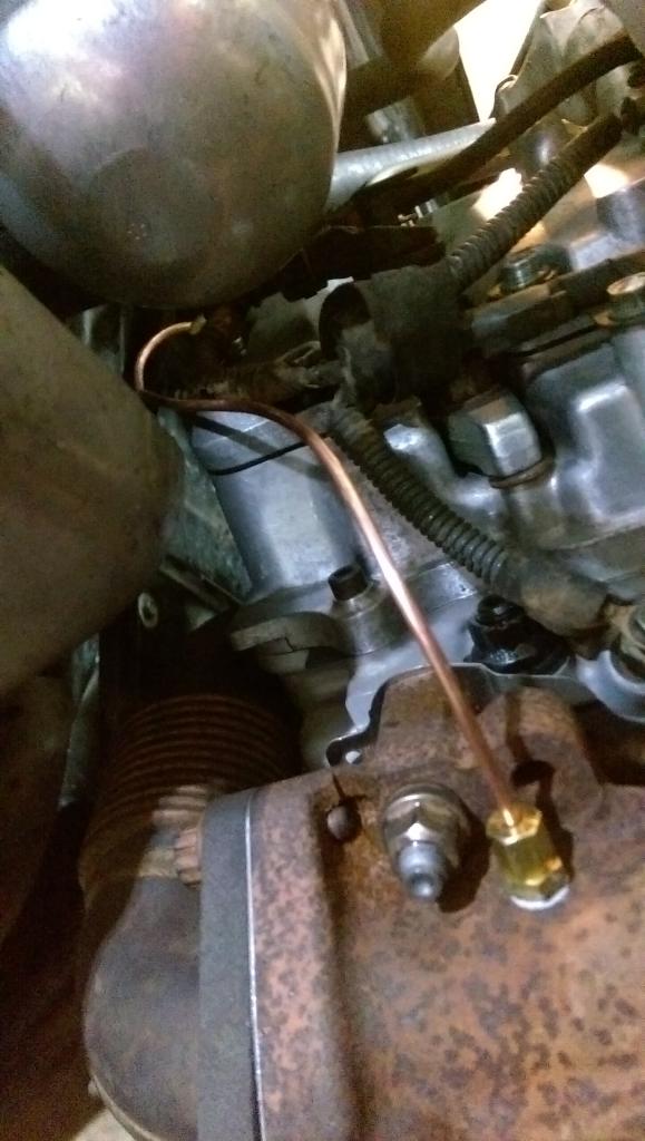

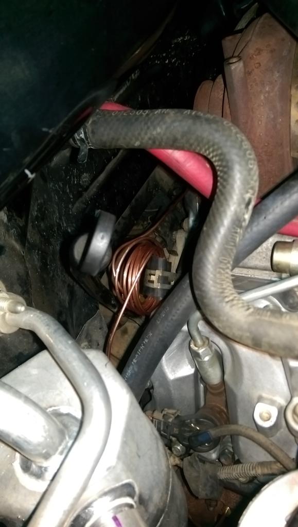

What do you guys think of this for drive pressure? I have 12 feet of copper tubing between the manifold and the gauge. Will coiling up the tubing like this dissipate heat, or will the coils touching each other transfer heat like the coils aren't there? I can't figure out how to coil up the wire in a different way that doesn't flop around a lot.

The tube would dissipate more heat if the coils were spaced out but even with them touching, it provides more thermal mass to act as a heat sink than if it were only a strait section of tube there.
So you have exhaust manifold pressure going to one of the boost gauges? I am not all that familiar with compound setups and what/where they are monitored.

Why do you have to have so much extra tubing ? For hot exhaust ?
Can't ya cut it to length plus a little and put a new compression fitting on ?
If you need one LMK .

Yeah it's for heat dissipation. Sounds like I'm going to need to bump up to a 1/4" line to avoid plugging it up with soot.
Now it's a party

The picture isn't showing up for me. Is it bent connecting rods?
