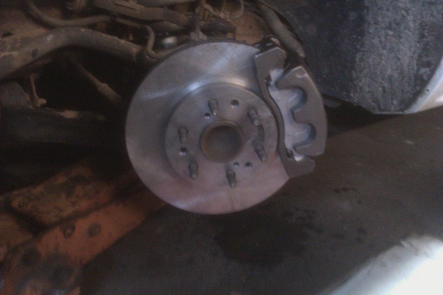

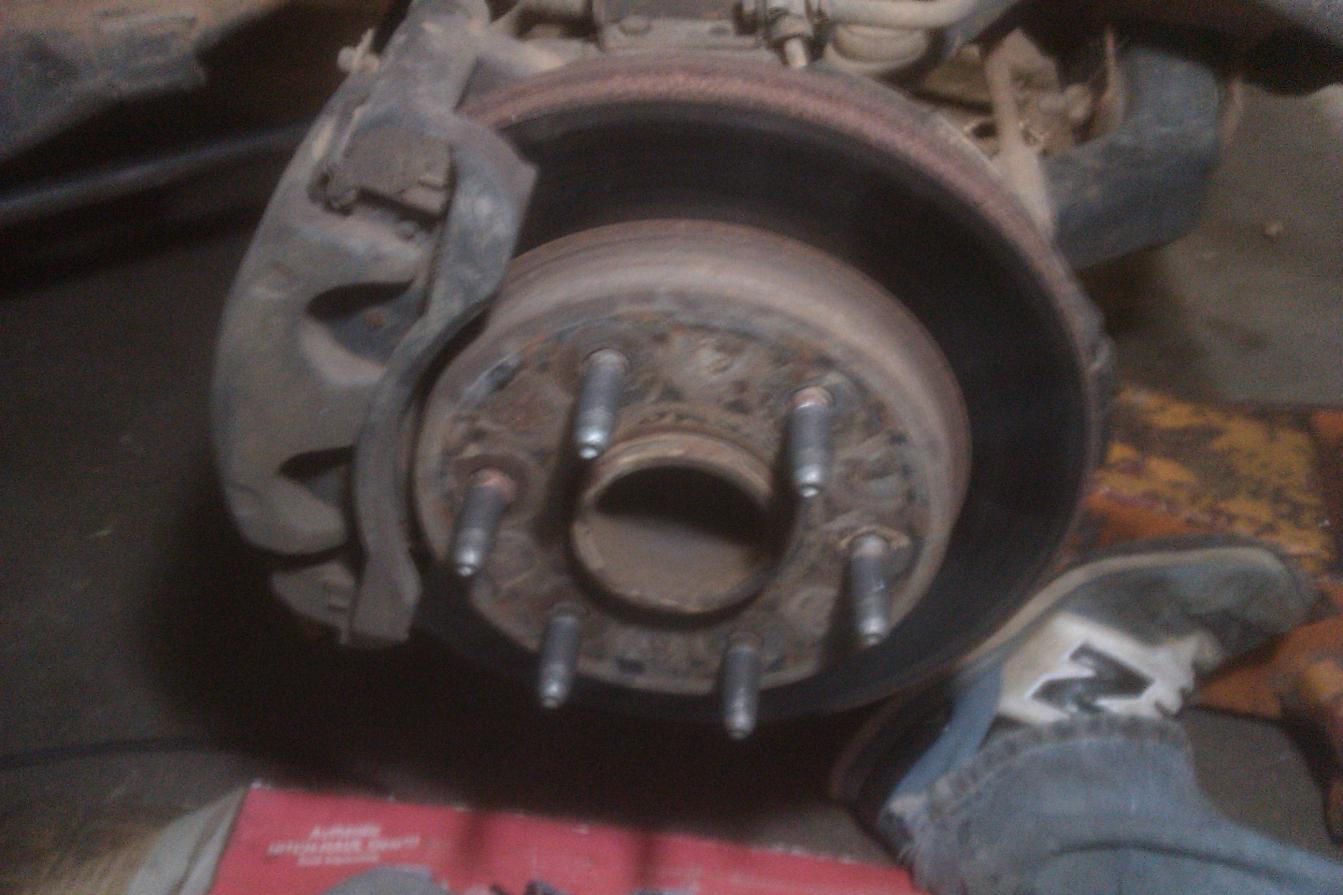

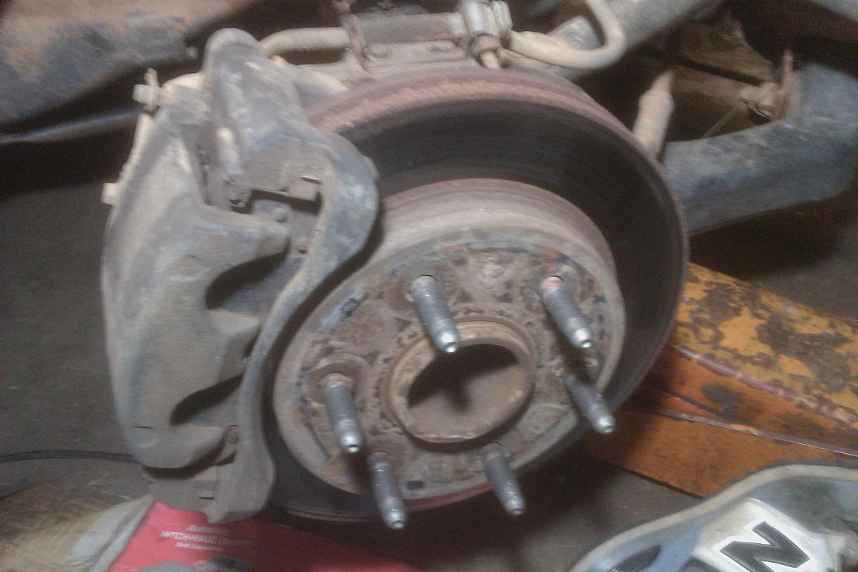

Alright I got turned on to this a few weeks ago. when I first started I had bought the wrong calipers so what you will need for this is.
front rotors
front calipers
brake pads
all from a 2005 1500 truck with drum brake back brakes that is the difference.
after you get done you will have 13inch rotors instead of 12 and right now I have about 230 dollars it in. I will have pics up in a few days
Sorry it took so long, but let me tell you it made a world of difference
Attached Thumbnails 05 brakes on an 01 gmc-imag0007.jpg   05 brakes on an 01 gmc-imag0008.jpg   05 brakes on an 01 gmc-imag0009.jpg   05 brakes on an 01 gmc-imag0010.jpg

I thought the only difference was the caliper brackets and rotor diameter?

Caliper is a better PBR caliper as well....
Thats what I thought too but the caliper bolts up different. I am workin on pics

so do you need the caliper brackets?
I just bought rotors, pads, and the caliper. I don't know if I need the 05+ brackets

so you cant use the old caliper with the new style caliper bracket?
can you post pics
