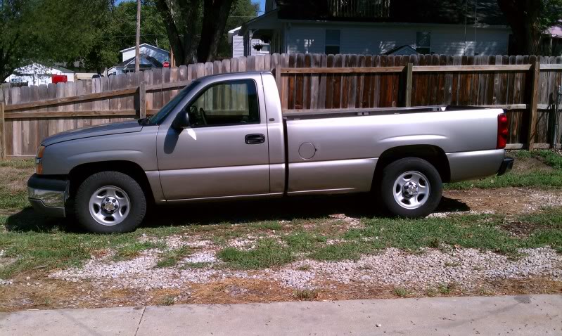

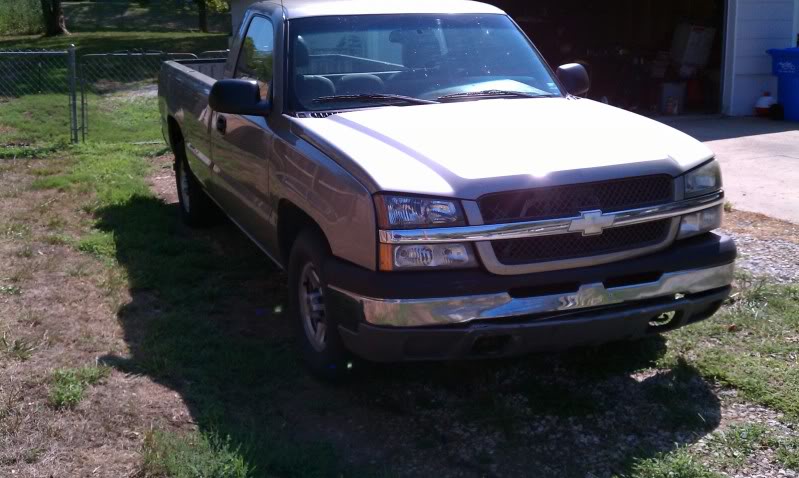

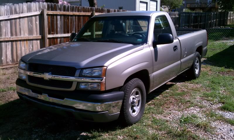

OK here is the beauty!
2003 reg cab long bed silverado
265k!!!!
slipping 4L60e
just broke in 4.8 lol
here it is how i brought it home, (last week)

I want to lower the truck a decent amount and plan on still towing my car trailer with it on occasion. Dont want it to be retarted low but want it to look decent.
I was thinking of a 2/4 drop, and wanted to do it as cheap as possible (obvisoiusly!)
If I do a flip kit on the rear end what will i need to bring it back up to get the 4" drop? a 2" "lift" shackle?
I also wanted to see what peoples opinoin were on the front end..
springs only or spindles only? both?!

GMCtrk Sep 3, 2012 05:25 PM
You could do a flip kit and 1" lift shackles to get a 5" drop. That's as "high" as you can go with a flip kit. And the flip kit is quite simple to install. The downside is that you will want to do a C-notch at that drop. I think with a 4" drop (hangers and shackles) you can get away with no C notch.
Up front I would do drop springs. They're very easy to install and the ride is no worse than stock in my case. My next choice would be 2" drop spindles.
98tdi Sep 3, 2012 08:41 PM
Why couldn't i do a flip kit in the rear and add 2" lift shackles?:confused:

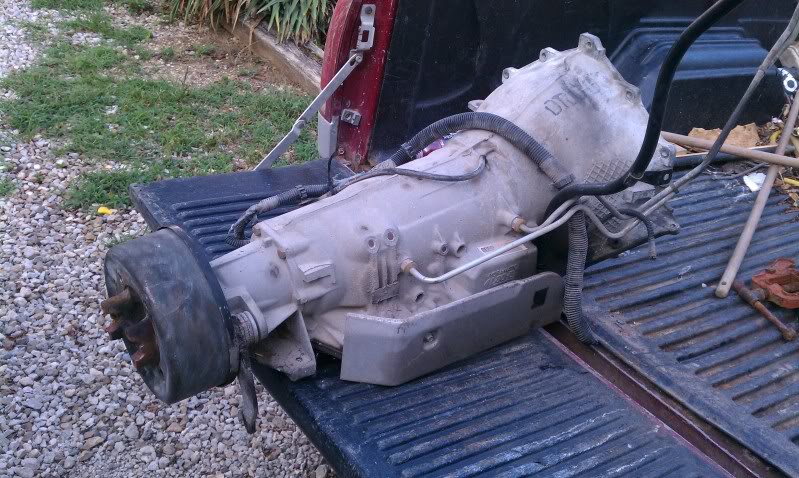

98tdi Sep 5, 2012 10:12 PM
2 Attachment(s)
parts are on the way:
2/4 drop kit
66mm turbo
circle d converter
4l80e out of a 01 1.5ton truck, look at this beast!!
Attachment 130263
Attachment 130264

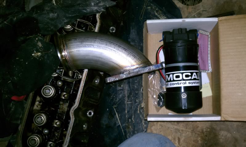

98tdi Sep 9, 2012 10:03 PM
3 Attachment(s)

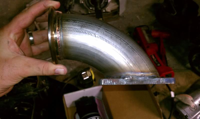

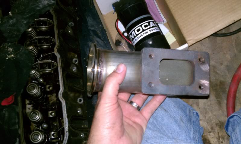

Thinking of changing it from a front facing turbo kit to a underbody turbo kit...
Attachment 129982
Attachment 129983
Attachment 129984
I had a 6.5 non turbo diesel in a 85 3/4 ton 4x4 pickup, and was going to use these on it, but if you know me I usually (always) change my mind!
Hot side is a 3" vband with a 3" 90 degree mandrel pipe going to a T3 housing.
Mocal makes a good oil return system for the scavenge pump, and i bought a one way valve for the oil return. (not pictured)
What do you guys think? Underbody boost or Under hood?

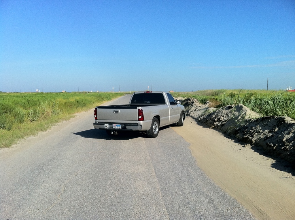

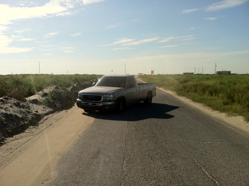

wheeliE-maxx Sep 9, 2012 10:13 PM
2 Attachment(s)
You got longbed specific hangers right? I think only djm makes them. Here's mine at 3/4.5-ish (bt coils, shackles/hangers, overload delete). Attachment 129979
Attachment 129980
Ass end is still a bit high.
98tdi Sep 9, 2012 10:21 PM
@wheelie-maxx Your truck sits just like I want mine to sit! looks good!
Yes I had to search for long bed specific hangers/shackles but they are on the way Now i wish i would have Got a 3/5 drop!!
