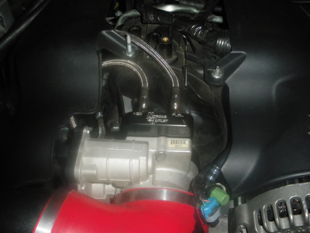

nitrous outlet plate system and 3 piece engine covers. if anyone does notice the plate, just tell them it's a throttle body spacer, then brag about how much power difference that spacer made! good bait lol.

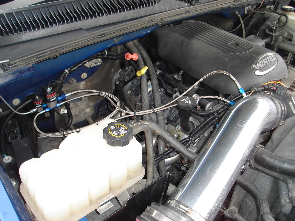

From: Downers Grove, IL
Originally Posted by Steve-O-08
You can also do a Dry kit post MAF with the timing tricker. One line is easier to hide than two.
I could put it put mine after the MAF if i wanted to.. My truck is tuned for it to pull timing and add fuel at wide open. This is how i have mine set up as of right now.
