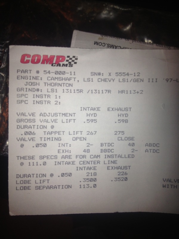

yea Thats gonna be the fun part..
Still gotta figure out a stall and im trying to get him to go to a two stage.
he sent me the cam card so im fixin to post it up, he has a guy that wants to buy it so ill text ya about a cam once he figures out if he wants to do nitrous or not .. dang kids these days...

The weight is going to kill it. If you can pull a bunch of weight out of it, get it around 4000# ready to go down the track, with about a 4500 converter, some really deep gears and spin it 7k+ rpm's, it COULD run 10s. That's assuming the motor makes 300-325 n/a now. And really no room to miss the tuneup

Id start with a 80e and a yank pro 3400, good plugs and fuel and a vary good nitrous tuner you might get a 10. Exhaust flow will kill it, it will eaither need a cam with ex dur in the 240s-250s or a better flowing head.
