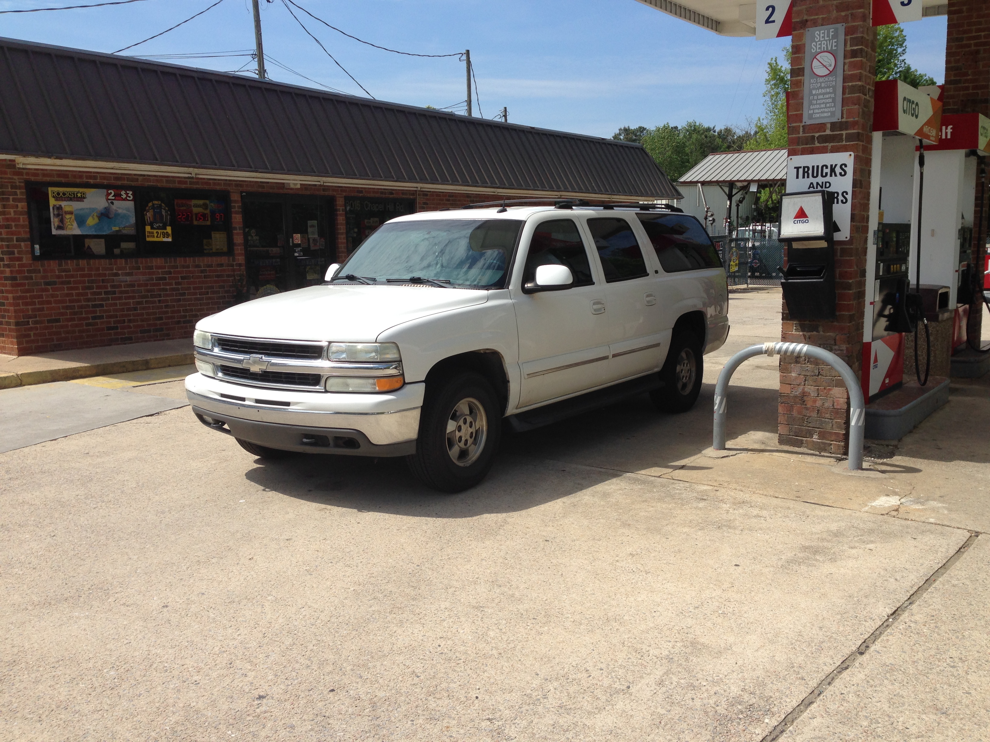

Here are a few pictures, just the run of the mill sub

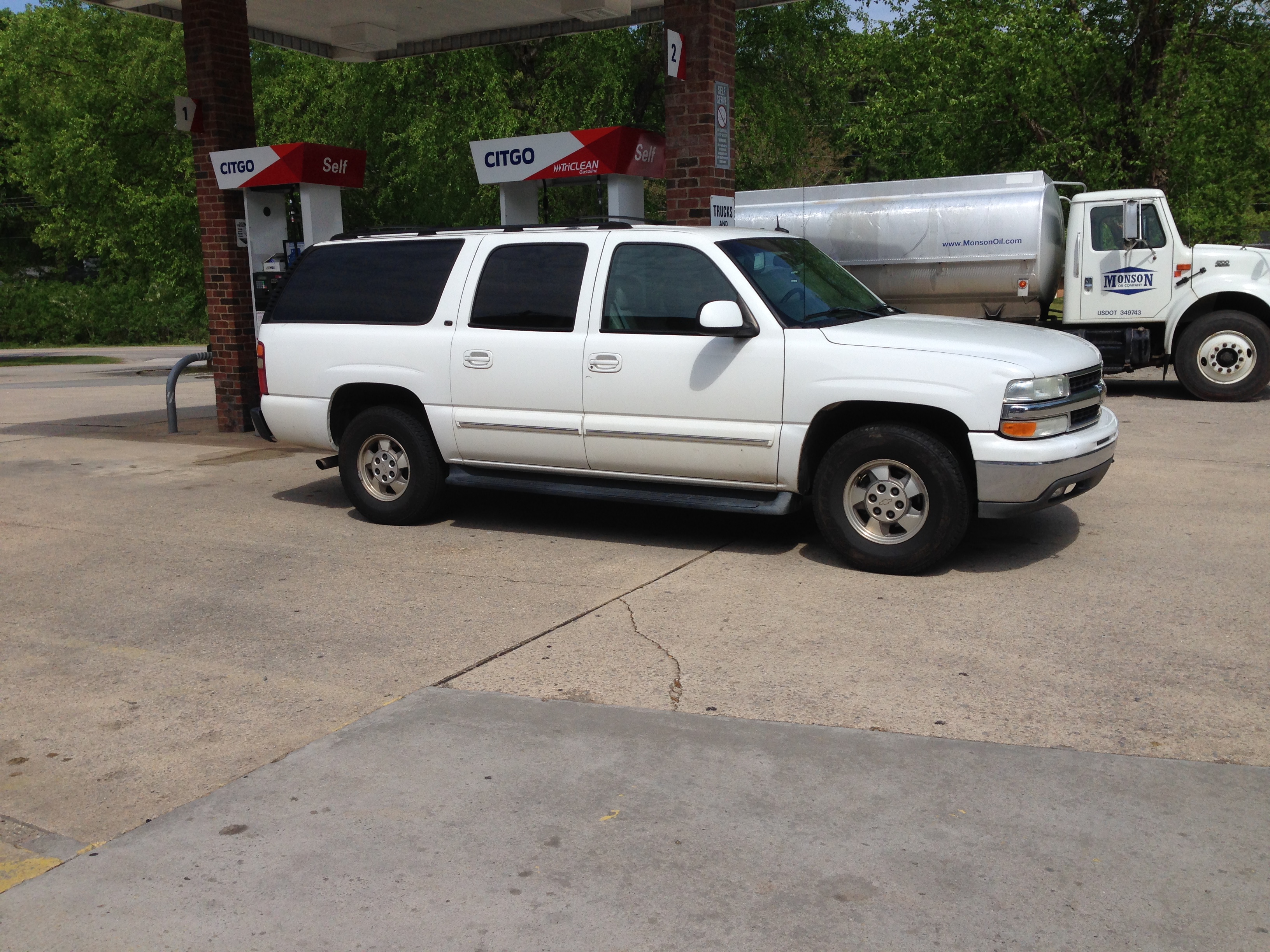

Another
