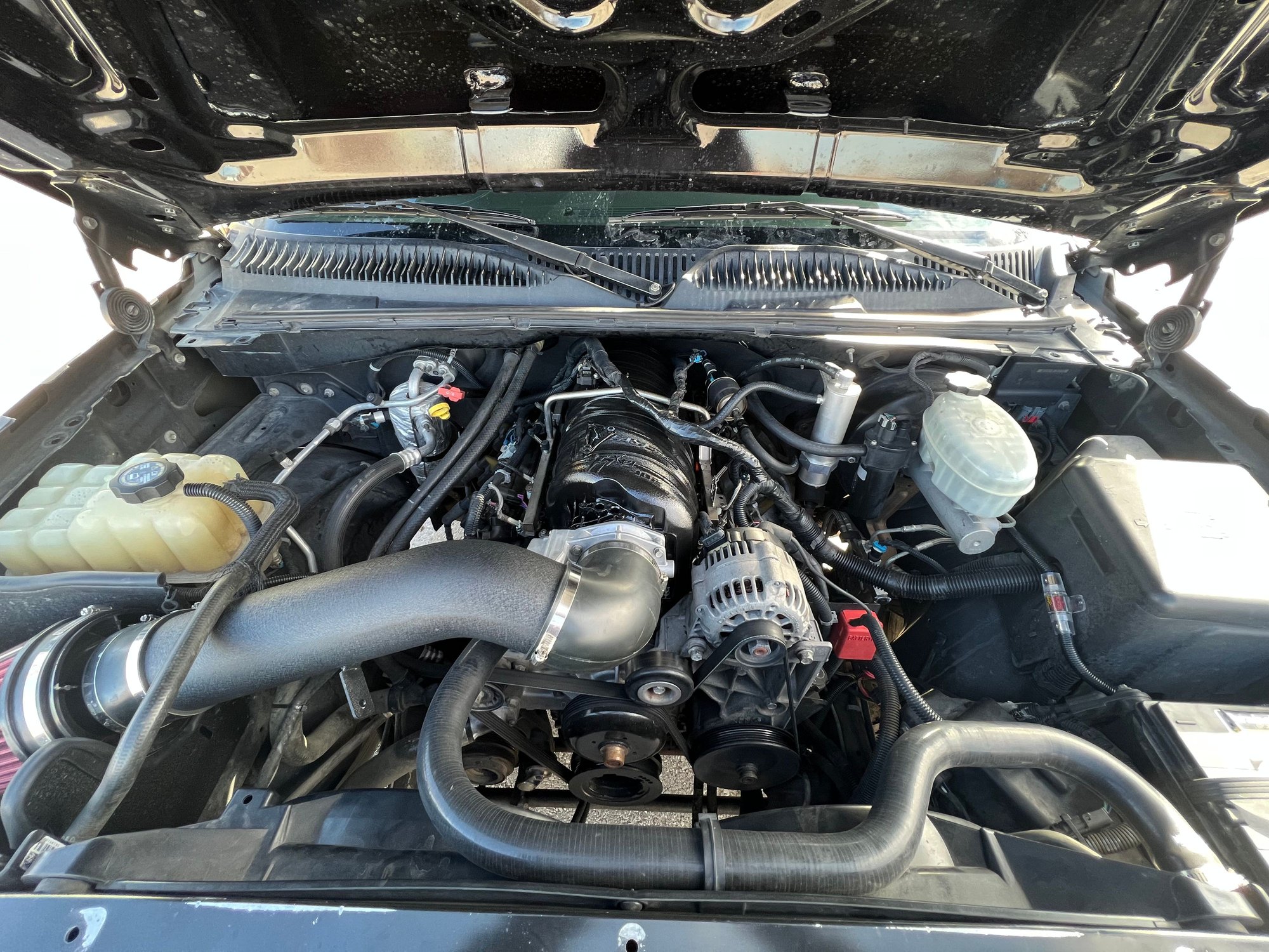

I’ve owned this truck sense 09 so it’s been around for awhile. I’ve done a lot to it. I don’t think there’s a bolt or nut I haven’t touched on it. Multiple setups, multiple transmissions, a few T-cases, etc. I have kept it NA and SBE.
LQ9
Patriot stage 3 heads.
Fast 102 LSXR. 92 mm TB
custom ground cam
1 7/8 headers to Speed Engineering single exhaust.
4 inch intake
Rebuilt 4.10 gears with tru-trac.
4700 Circle D

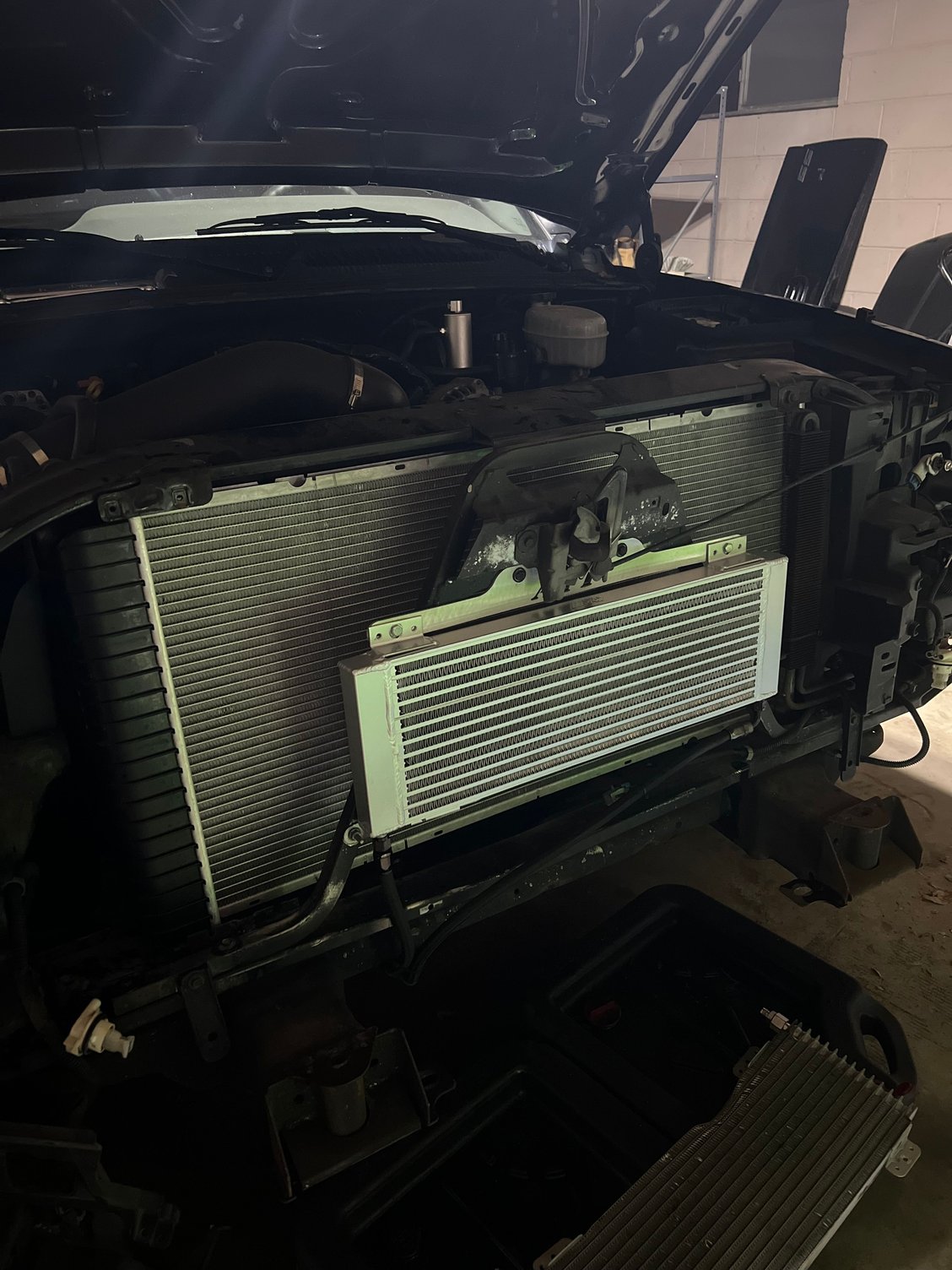

Huron trans cooler
2.84 Sonnax pinion
Sonnax input, clutches, etc.
Sonnax Servo.
Truck weighs 4500.

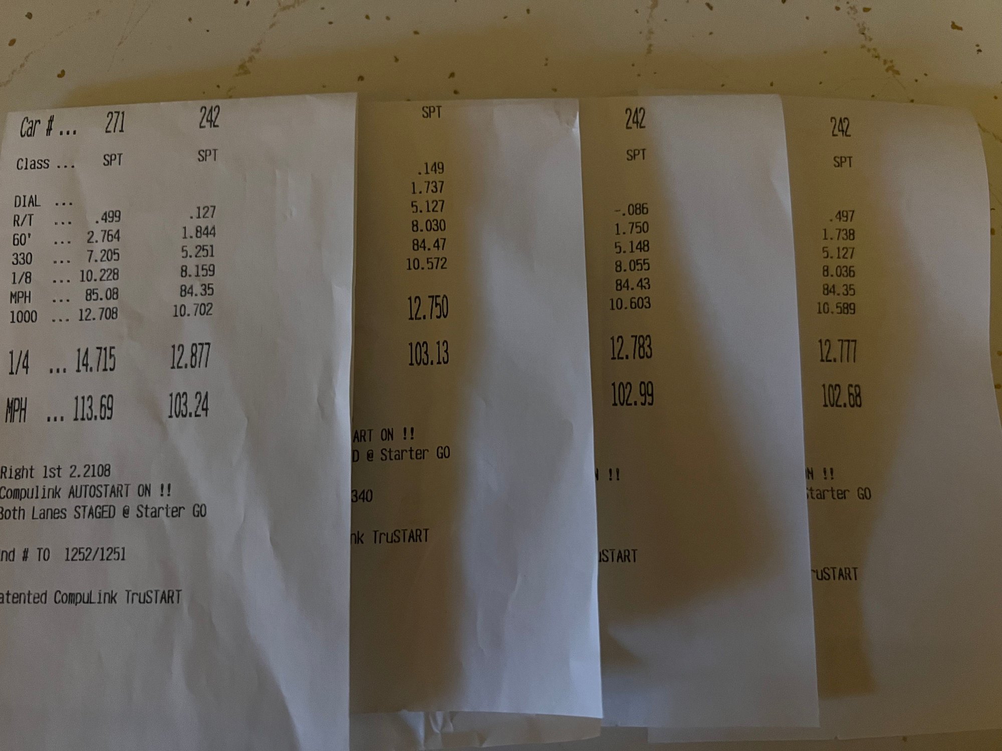

Closes track to me is in Idaho and went 12.7.
I want to tune it for E85 as I’ve heard it’s been good 20-40 more hp but it’s just on 91 some times 50/50 110 VP when tuning at the track.
