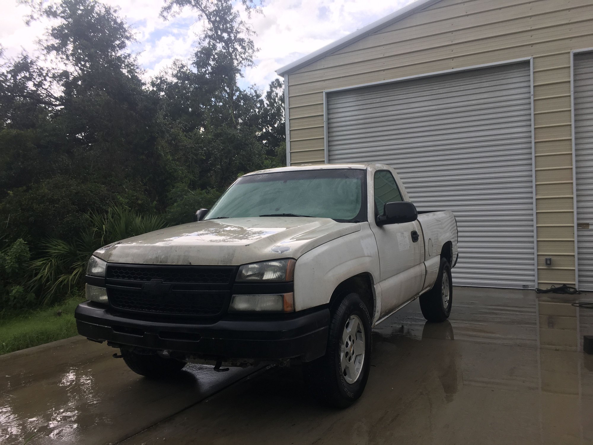

Whats up guys, I just picked up this 2006 4.8 4x4 for $2500 with 31k real miles on it. Its a one owner truck that spent its life on a concrete plant as a yard truck so looking at it you wouldn't really assume its a low miles truck. Im 17 and this is my 3rd car (my other two were jeeps and i got tired of 10mpg and not being able to jump out in traffic). my plan with it is to drop it (probably 4/6) and do a cam and single turbo along with painting it and replacing pretty much everything and i look forward to everyone's input on this project. I plan on getting a 78/75 from vs racing and custom fabbing the piping for the turbo at my buddies muffler shop. as of now I think I know how I want everything in my head except for gearing im leaning towards 3.23s and 28s i think being that it is mostly just a daily that will do some street digs in 4hi and a occasional rolling burnout. Any way all input is appreciated (yes i know its ugly)

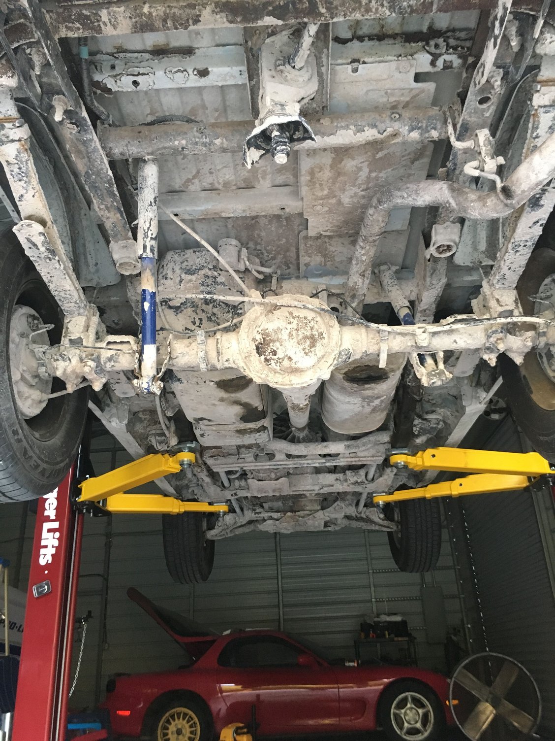

In my jeep i run 37s and 4.88s and like 2600 rpm at 70 and yeah the mileage is pretty horrendous. I wasn't really thinking about it like that but you’re right that it will spend most of its time going from light to light so i guess 4.10s are the way to go. last night i got it up on the lift and got a picture of the bottom of the truck with the concrete and i pulled the bed then started pressure cleaning and it actually cleaned up better than I thought it would.
