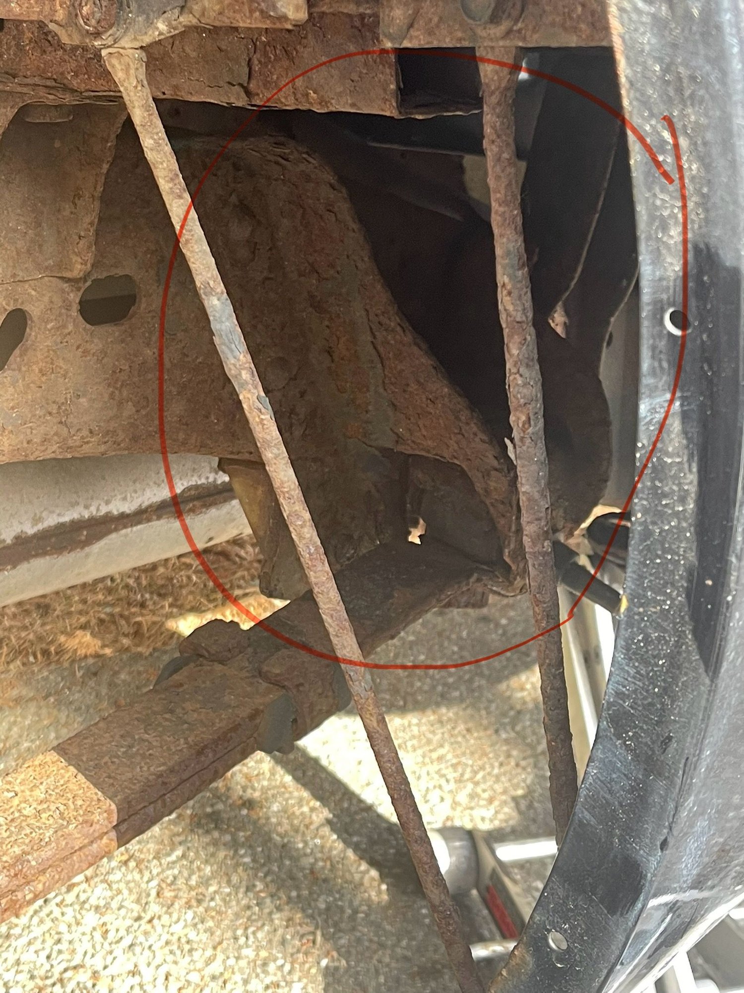

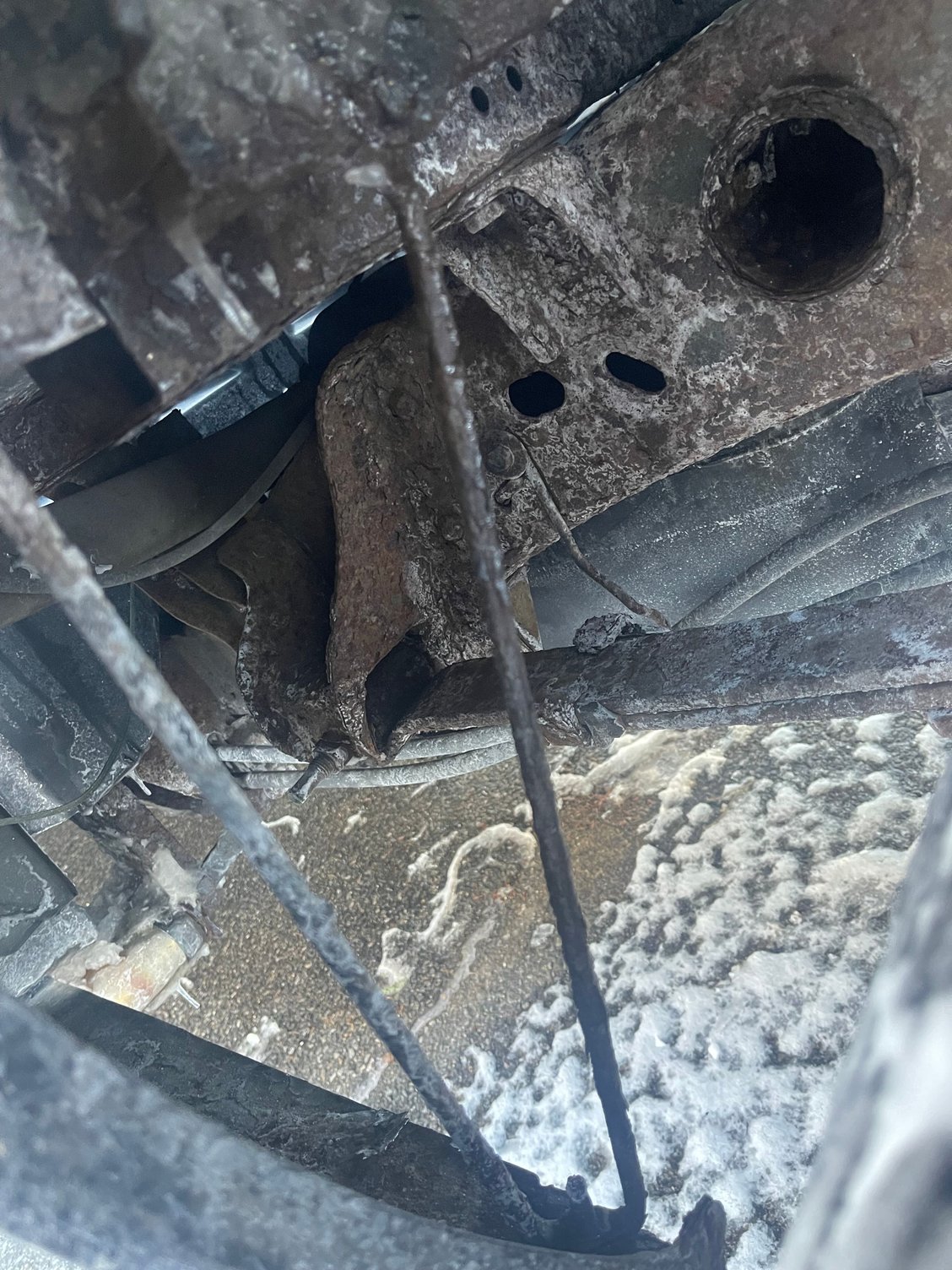

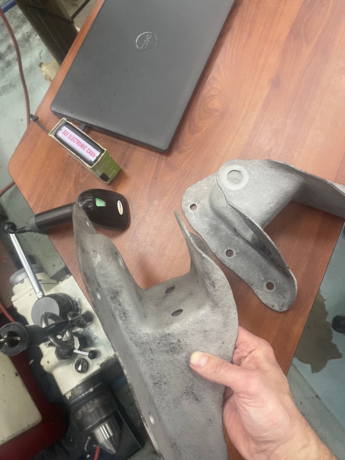

for now I’ve accumulated suspension components, leaf spring mounts (fronts apparently don’t exist anymore so found junk yard ok ones and restored them see pic) 1500lb leaf springs from ATS, Mevotech upper and lower arms, HD tie rods, power flex sway bar links, brackets (apparently I have a 28mm bar).
Also picked up cab mounts as mine have completely rotted through and I honestly don’t know what the cab is being held on by but whatever it is , it’s magically doing a great job….
Still considering/researching 1-3” lift kits as I also need shocks at all 4 corners.. not sure if I should just go with cranking keys, lift hubs or various other options…really need some persuasion here as i need to find something.

Pass side rear leaf / front mount collapsed , could this cause this side of my bed to looked jacked up higher than the other ?
Driver side leaf mount
New mounts
New mounts
Current situation, not looking forward to this at all.

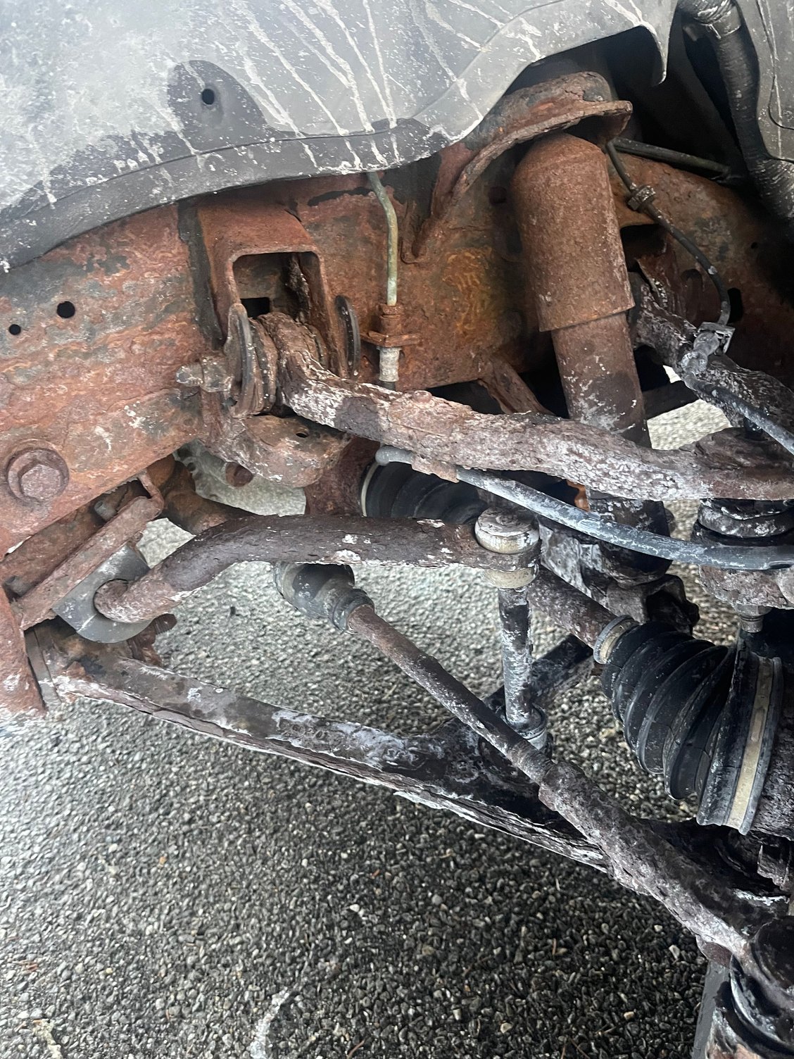

👀🧐 Looks "a bit rusty" under there. I would focus on replacing anything that needs attention to make it reliable again.
Ball joints okay? Lift the front and do the "shake test." If anything is original, it probably needs to be replaced at this point. Brake lines look okay? Have you replaced or flushed out fluids? PS, brakes, transmission, T case, differentials?
