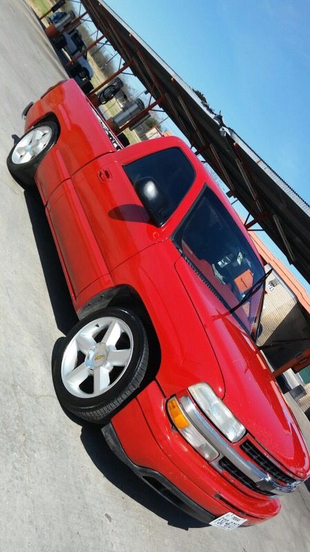

i spent a few minutes earlier introducing myself but it ereased so heres my 02 Silverado purchased in March of this year with a 07 gate in the back 4/6 flip kit, belltech air shocks out back no engine mods on the V6 stock engine.. daily driver. not really thinking of upping the engine but i might later down the road...question hoping someone can answer: are there any interchangeable trannys that fit a stock v6 being the one i have isnt stock and need to figure out where it came from...thanks in advance...

Good looking truck! What part of Texas are you located? As far as the tranny goes I'm pretty sure just about any 4l60e should work without much trouble at all I think the little shaft that goes to the shift linkage is the only difference between a 4l60 from a car to a truck ones slightly longer than the other everything else is the I believe don't quote me on that but I'm pretty sure one of these other guys could tell you for certain I'm sure, a lot of these guys know there **** down to a T in certain fields if not all. Welcome and good luck with the truck you came to the right place to find some info
