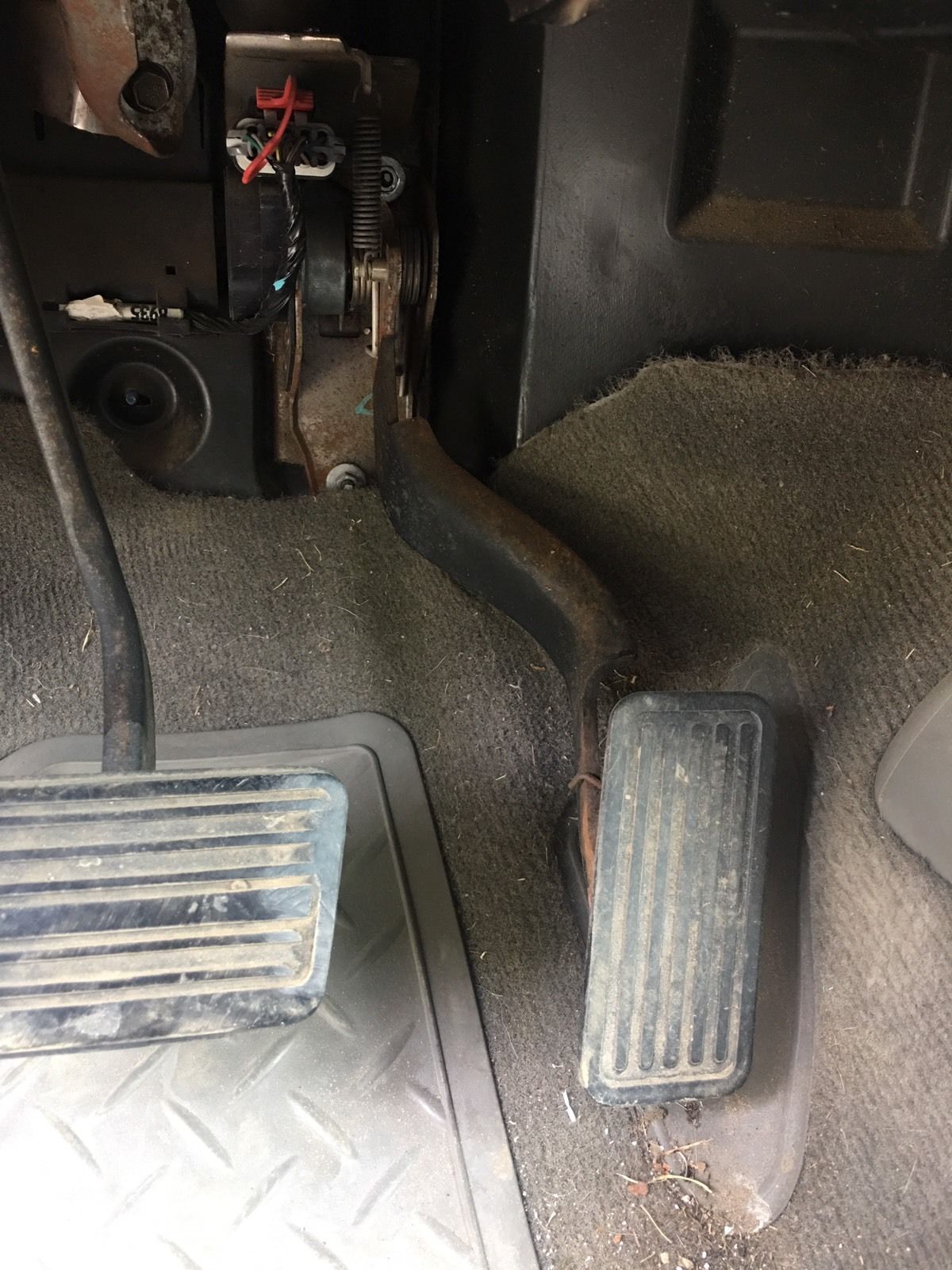

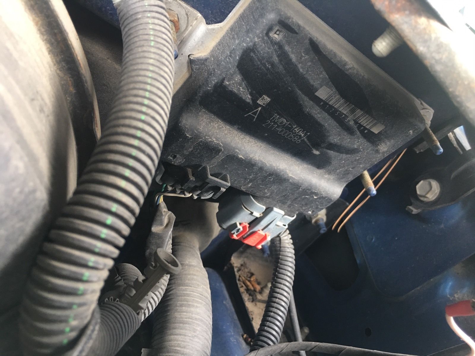

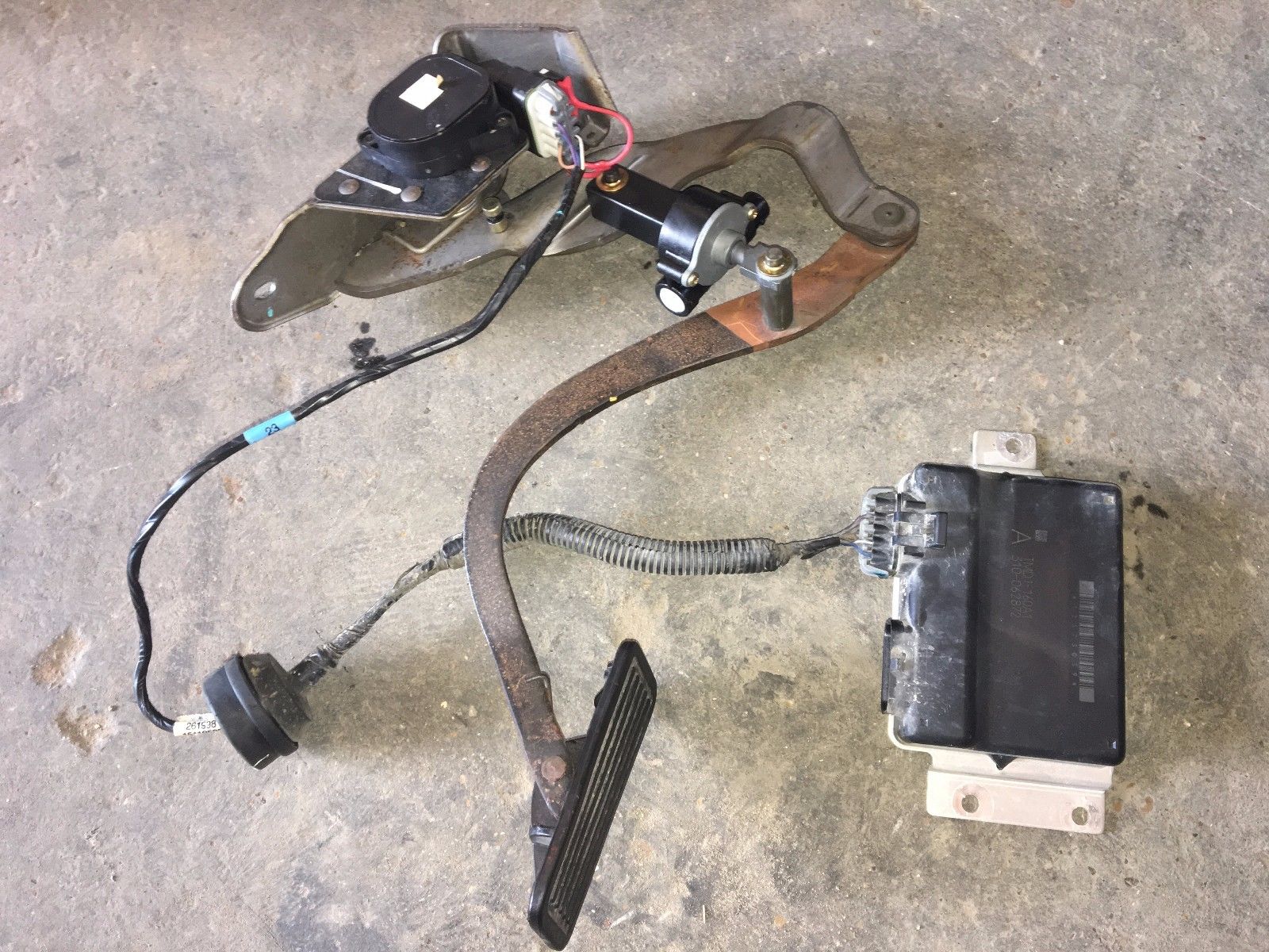

The TAC module mounts to a stud beside the brake booster. I'm guessing the harness goes through the grommet above the booster on the opposite side judging by the length of the TAC harness. Here are some random pics I scrounged up when I did my V6 to V8 swap. I eventually went with a DBC setup. The DBC accelerator pedal is mounted to this large steel brace under the steering column. Below is a members post in the GEN III V6 to V8 swap thread explaining how he went from a DBC to DBW pedal.
Originally Posted by tpartsman
I ran in to the same problem. I cut my gas pedal off and used two self tapping sheet metal screws to mount the new dbw pedal and two tack welds just to be safe. I have not had any problems in 15 months and drive it every day. The only other option pull the column and that big metal bracket. I was not willing to do that especially the truck was sitting there at idle. I was ready to test drive it.
Random photos from the net:

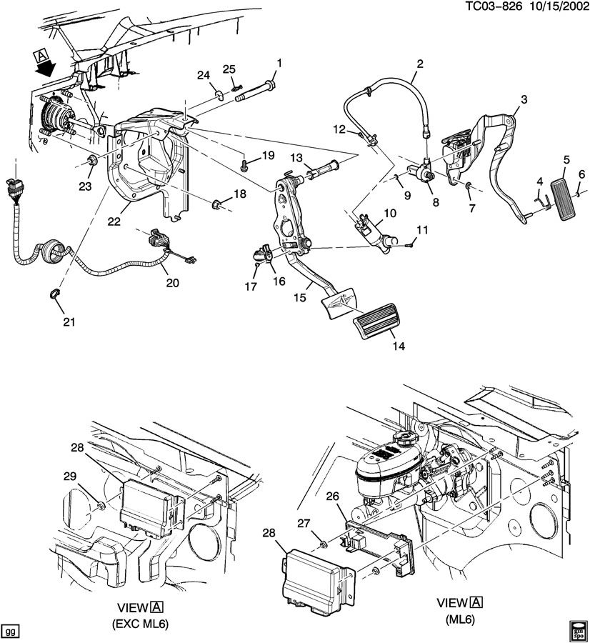

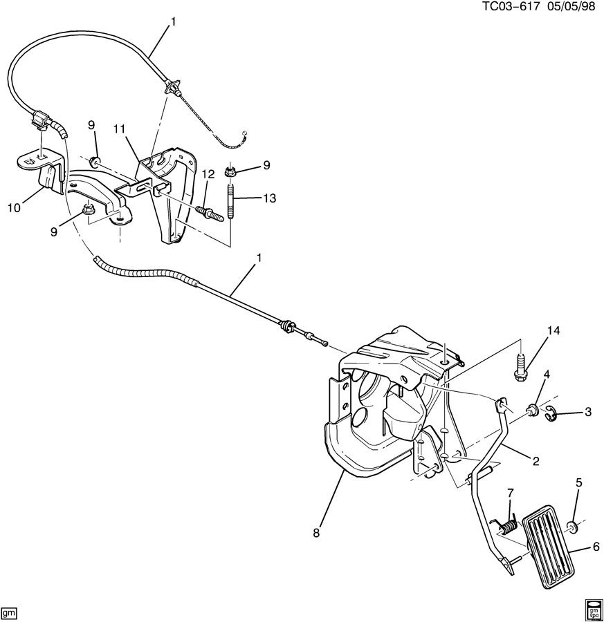

The TAC is mounted above the clutch slave cylinder right under the black fender brace. If you look there are three studs holding the TAC module. Looking through the different accelerator schematics for a 2005 GMT-800 equipped with a V8 (V6 has no tac) it shows only two different TAC module mounts. Part 26 is "cruise control bracket" which the TAC module also controls. 26 looks like an adapter for the TAC to me... probably a hard to find part. Might have to use some ingenuity mounting the TAC if you need that extra part. The part number for 26 is 15080779.
You can see the difference in the V6 and V8 pedal mounting brackets. Part 22 in the first photo and part 8 in the last photo.

Awesome. I’ll check again but I swear I don’t have those mounting studs. Maybe I missed them. I appreciate the pics.
