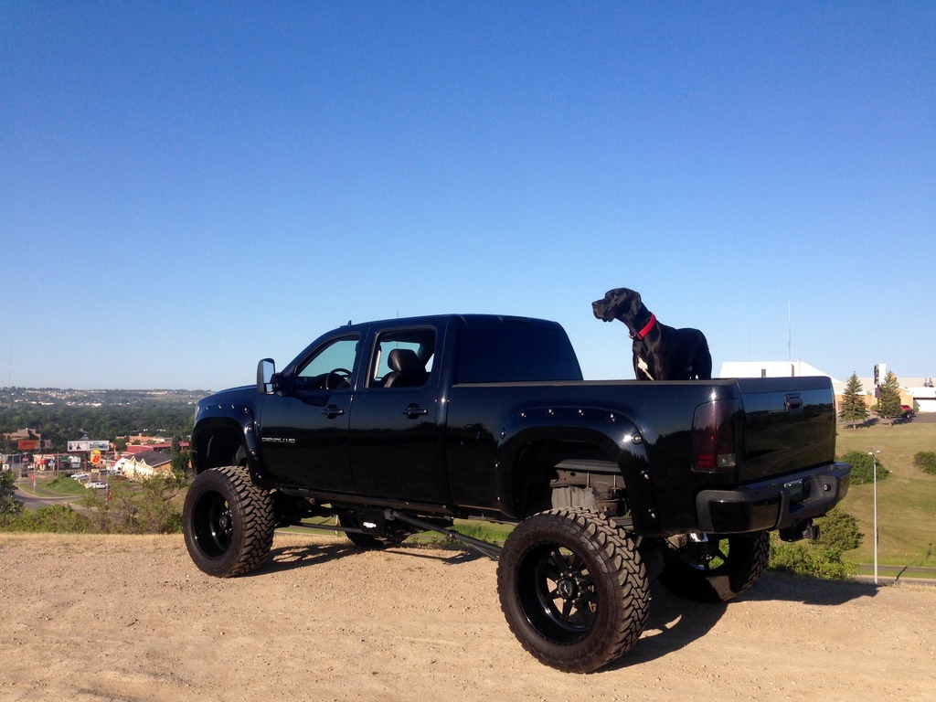

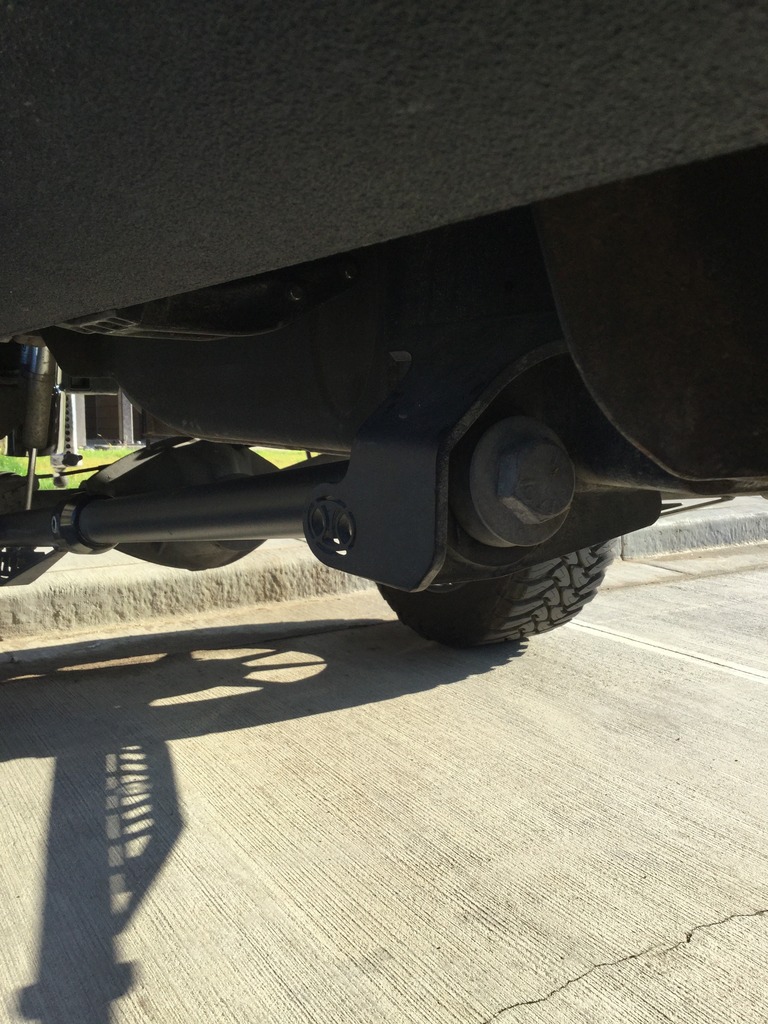

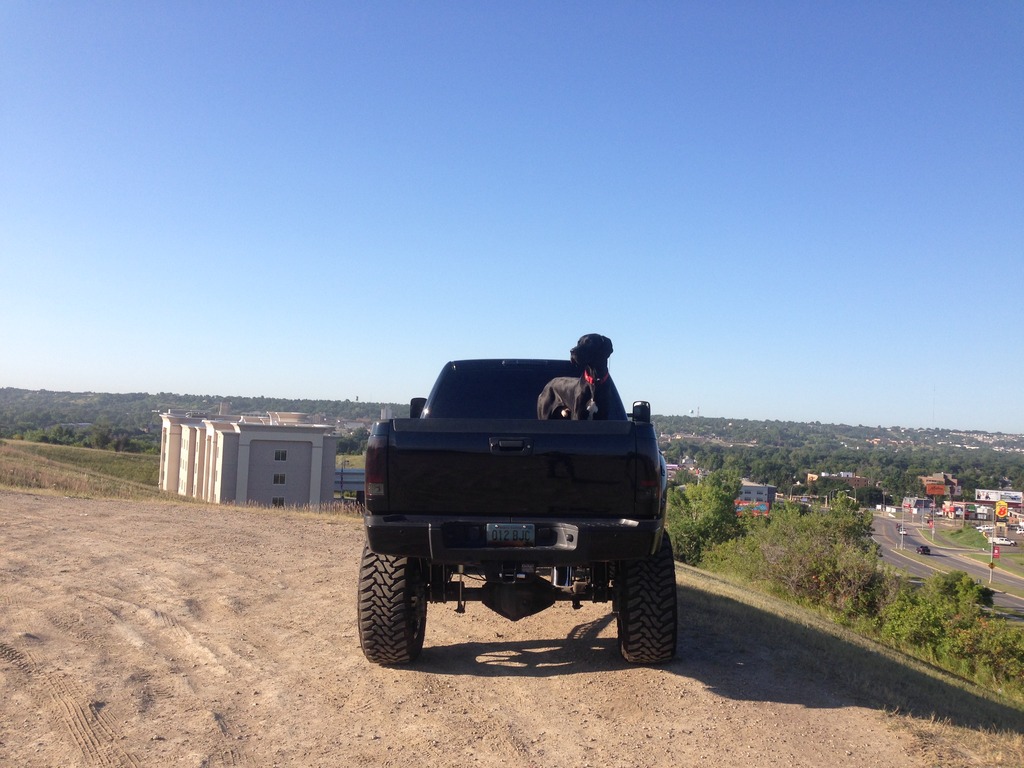

Off work early and took my boy out for some morning air. Happy Friday!

They match!! Tall and black...lol
Beautiful truck and dog.

is it just me or does that first picture look like the rear axle is too far forward?

I'm glad I'm not the only one that is seeing that.

Thanks guys, yeah the rear tire doesn't sit center. I believe the lift and 40s highlight it even more then stock trucks. I wish it did as the clearance is tight where if it was centered it would have a good bit more room.

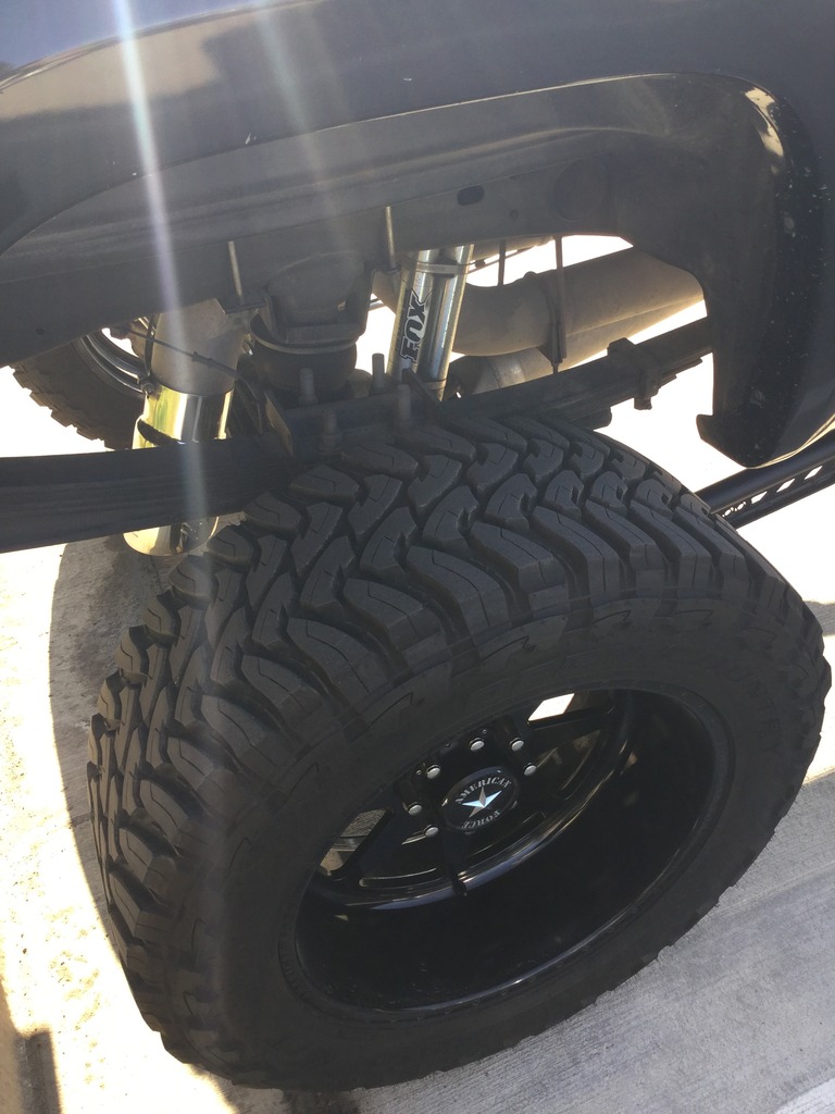

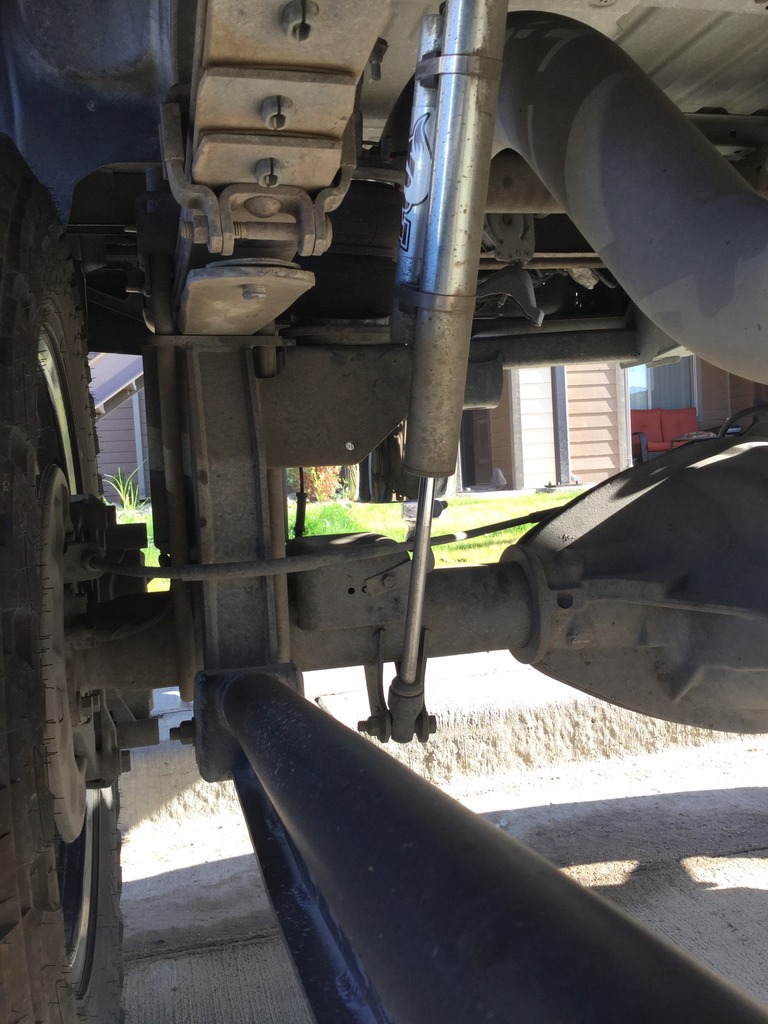

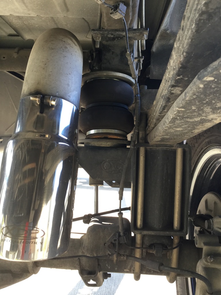

Couple pictures of the bulletproof lift setup on the truck. Again I agree I wish it was more centered, but not sure how I could adjust it.

anything can be done with money and a welder. good looking truck either way.

I think lift shackles tend to push the center of the axle forward.

Don't forget the drive shaft would need to be longer the more you lift it. I think this is why most kits are built this way so you don't need a custom drive shaft.

you can get a 1" zero rate to move the diff back. (1" thick)
I run one on my truck cause of my shackle flip, I think I was able to move it back 1.5"s
