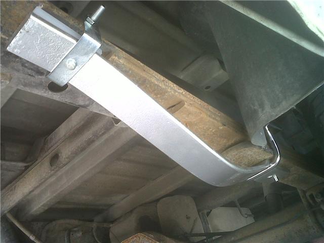

15" Rim with a 195/60/15 tire Front
2" Belltech Spindles
3" Belltech Springs
Belltech Nitro Drop 2 shocks (Changing them out to the Belltech Street performance shocks they're way better)
15" Rim with a 245/60/15
3" Belltech leaf springs
1" drop block
1 degree pinion shim
Leaf spring Sliders
Monroe shocks
Autozone leaf spring claps See pic below
Another way you could do the rear is
3" leafs
2-3" block depends on how low you want it (keep axle wrap in mind)
JTR Pinion Shim kit
Belltech street performance shocks.
I really recommend the JTR pinion shim kit for the Xcab cause the pinion is a pain in the *** to get right with the 2 piece drive shaft.
S10, 2WD Extended Cab Driveshaft Alignment Kit, S-10 V8 Conversion, Stealth Conversions
Link to the shim kit from JTR ^^^^

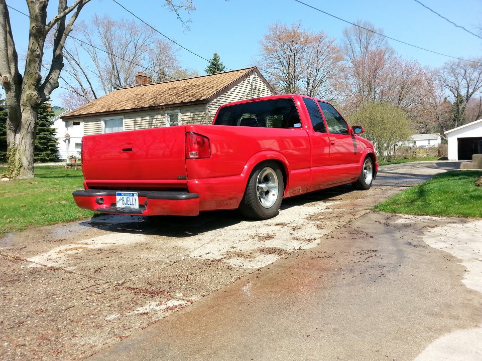

The last time I washed and waxed it before I put it away to head back to my duty station.
