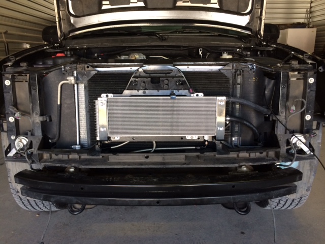

Originally Posted by Smokymance
You'll be good to go. I have a TVS1900 with intercooler mounted in front. After doing my install, I don't understand how you fit your intercooler. There is no way that intercooler would fit on mine. After I saw your build thread I got in touch with Magnuson to make sure my intercooler would go in front.

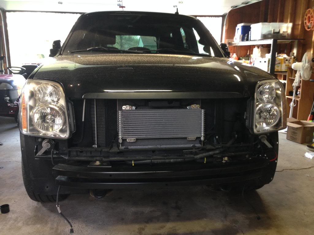

your heat exchanger looks alot different than mine...looks thicker but smaller overall size...mine is skinnier i believe and bigger over all and is mouned behind that bracing...then the trans cooler mounted infront of the bracing...i just installed mine two weeks ago, i have lots of pictures how i mounted them if you want to see
You can see them all stacked up...an idea is that u can mount ur 40K trans cooler behind ur exhanger just like u have now

Look at my last pic in post #71. There isn't enough room between the support and AC condenser to mount your style.
true...that skinnier heat exhanger is pretty thick looking...
